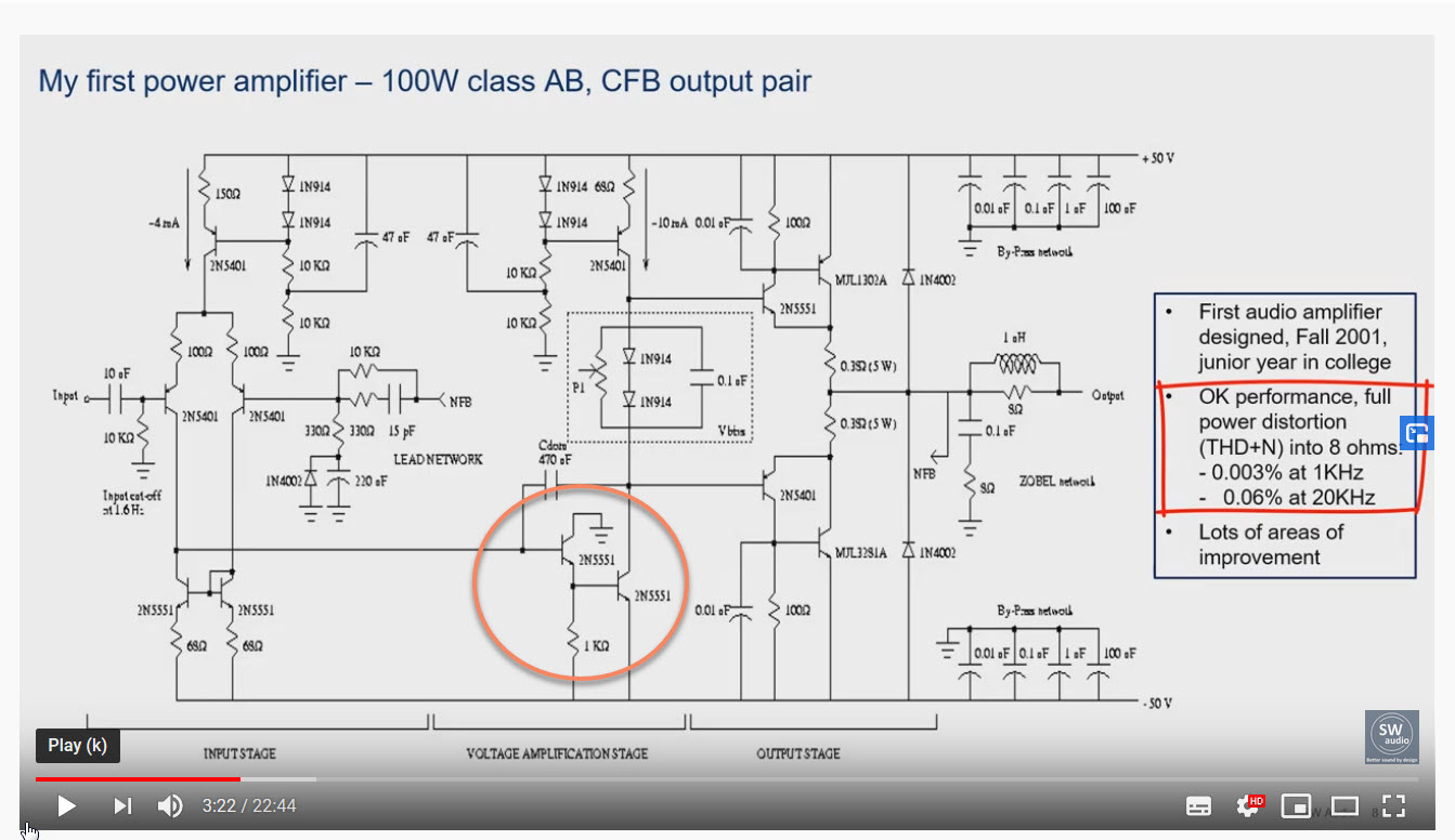

Hello Sandro ,
I have a question about your first power amplifier design attached below I have circled the part of the circuit that I have a question about. My question is should'nt the buffered Vas stage you have used need an additional transistor shown in the second image to to protect the Vas. I would of thought apart from the needing a larger transistor there this circuit addition was needed.
The second part of my question is how do you simulate the need to place that transitor there, I have learned through practice that I need this protection transistor but I find it difficult to simulate the failure of this circuit. I hope my question is clear.

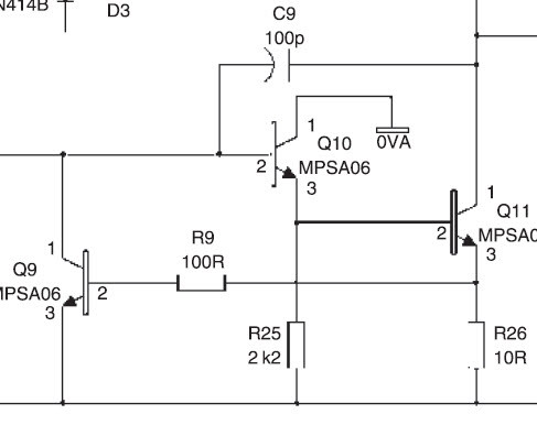

DISCLAIMER: That amplifier was designed when I was in college junior year in 2002 and I knew very little. The point of showing it was not to say it is a great amp (it worked, but had many flaws), but to say I got into designing amps early on.
I built 5 copies of this amp for 5.1 Home theater system, and in most of them, the VAS transistor blew up when I accidentally shorted the output or did something dumb.
1. Output recovery: Drive output of the amplifier to the rail with a square wave. Drive it hard, i.e. if your negative supply voltage is -50V, ask the amp to go to -55V.
Look at the current in the VAS transistor with and without protection transistor (Q9 in your second picture). Does is break the SOA of the transistor?
2. Current limit: Stick a current source in the amplifier output and increase the current into the amplifier. Monitor Q9's and VAS transistor current.
Depending on your current limit topology, the protection transistor may be or may not be part of it. Do the test DC and dynamically using a current square wave.
That is correct. The amplifier shown in that video is the first one I designed when I was in college circa 2002, so it has tons of areas of improvement (third bullet point). The need for the transistor you mention is one of them. Also, the VAS transistor should not be a 2N5551, that was a really poor choice, it is under rated.My question is should'nt the buffered Vas stage you have used need an additional transistor shown in the second image to to protect the Vas.
Assuming an NPN VAS transistor...The second part of my question is how do you simulate the need to place that transitor there, I have learned through practice that I need this protection transistor but I find it difficult to simulate the failure of this circuit. I hope my question is clear.
Hello Sandro,
Sandro I am not being critical of your work , I am testing myself, and am very interested in ways to improve the reliability of amplifiers through simulation before going to a build.
By the way I built an amplifier with exactly the same problem you described in your first build.
Hi Phoenix, I did not take it as you being critical, just wanted to clarify to anyone looking at that amp what was my goal for showing it in the video.
You are doing the right thing by putting protection and testing before building.

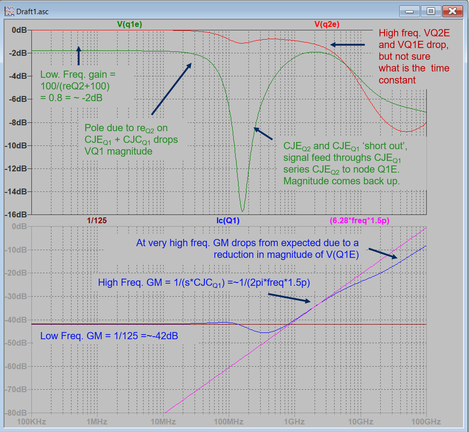

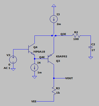

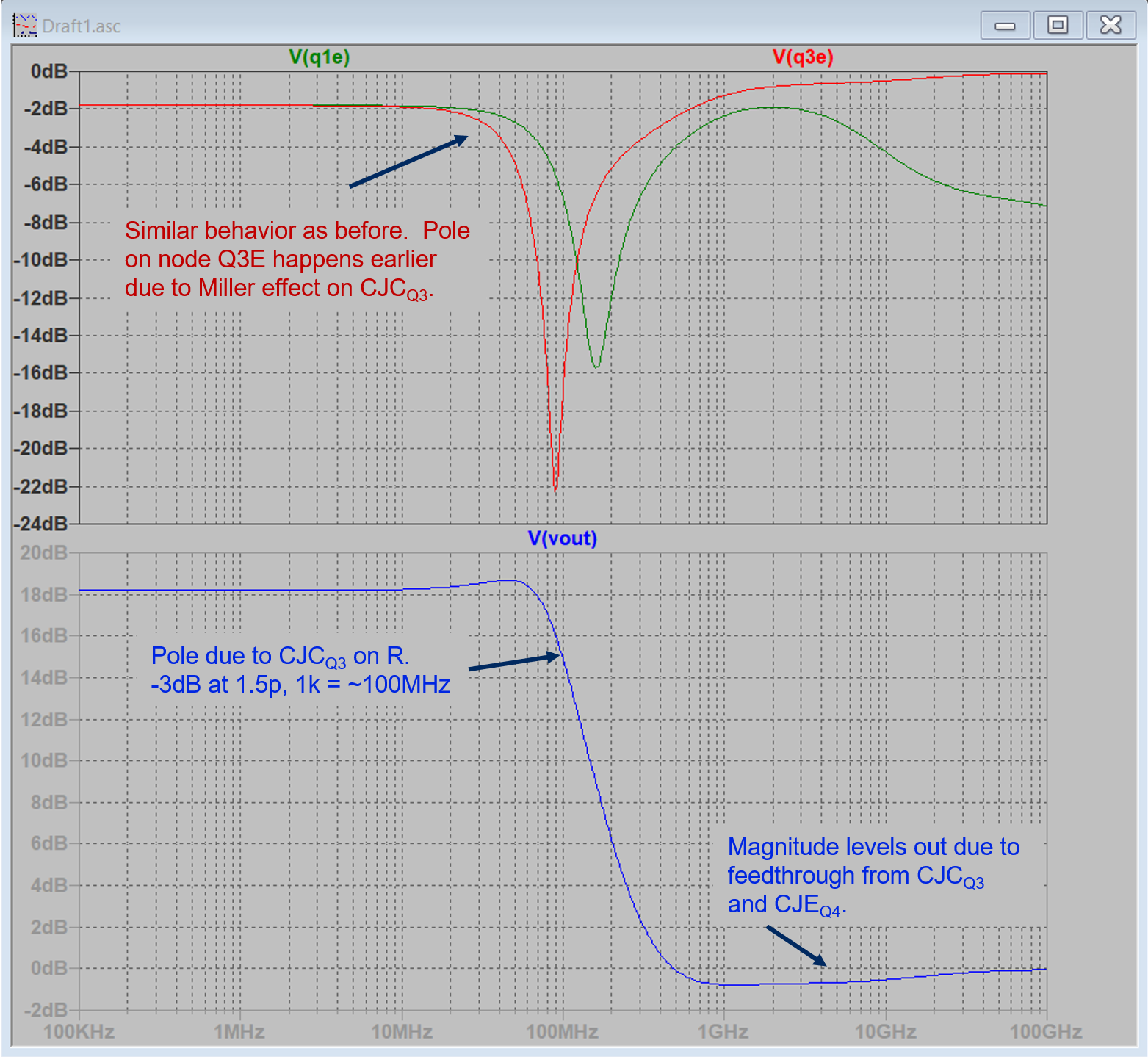

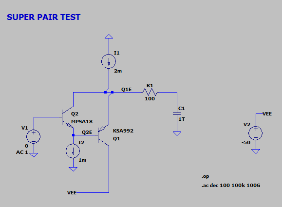

I took my circuit, well a small piece of it, and did some tests. See the attached images. While the curves are wacky, almost all the behaviors are explainable.
The first circuit is a pure trans-conductance cell, with a GM of 1/125. Output variable is IC1. The second circuit is a gain of 10 using using the same trans-conductance cell. Output variable is V(vout). No funny peaking in either.
Sadly, my laptop crashed as I was doing this and lost the test circuit. I would have to draw it again for further testing. Wanted to do some transients, but did not get the chance.
I any case, I'll keep an eye for weird behaviors.
Best, Sandro
