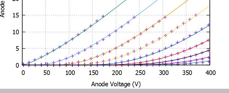

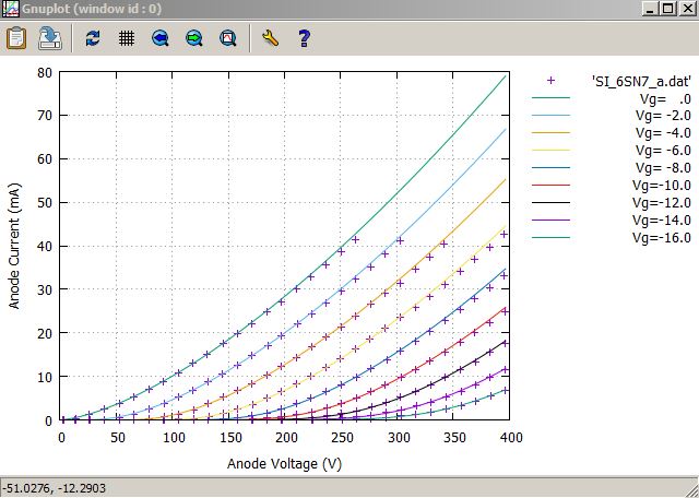

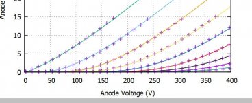

Apologies if I am being completely out of line here (I am new to tubes), but Merlin's lower curve (love your book by the way, an excellent read!) seems to imply that the Spice model predicts a constant Ra for all voltages. But if I plot the same for an 6Sn7 as an example, Ra varies with Va. This is a real plot of measured (graphic points from the uTracer) and simulated (solid lines):
Merlin's lower plot is a Spice model for 12AT7, which looks too 'ideal'. You have shown a Spice model for 6SN7, which looks more realistic. Note that in both cases what has been shown is a Spice model, not the Spice model. For the more popular valves there are several Spice models, which vary in accuracy for anode curves and other matters such as grid current.

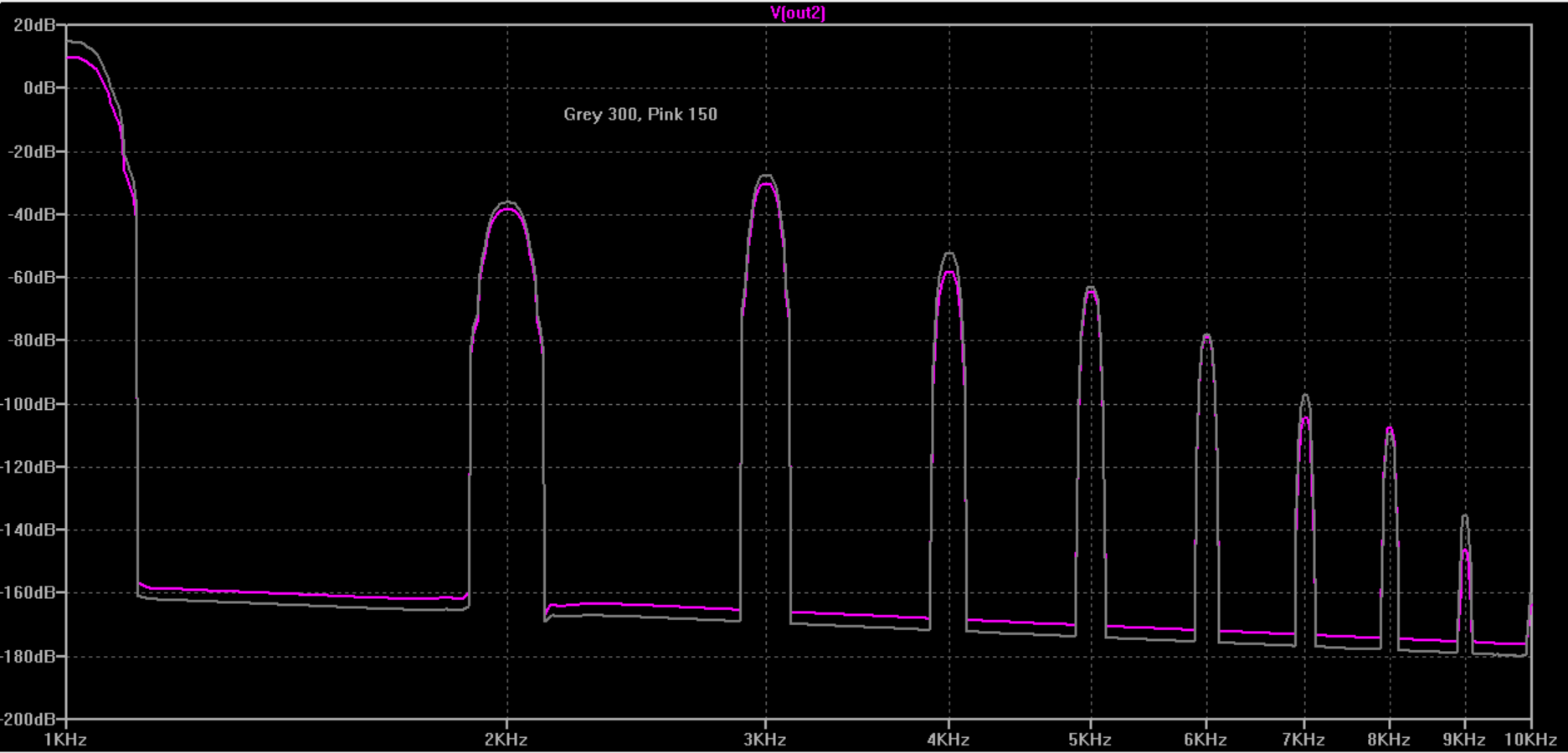

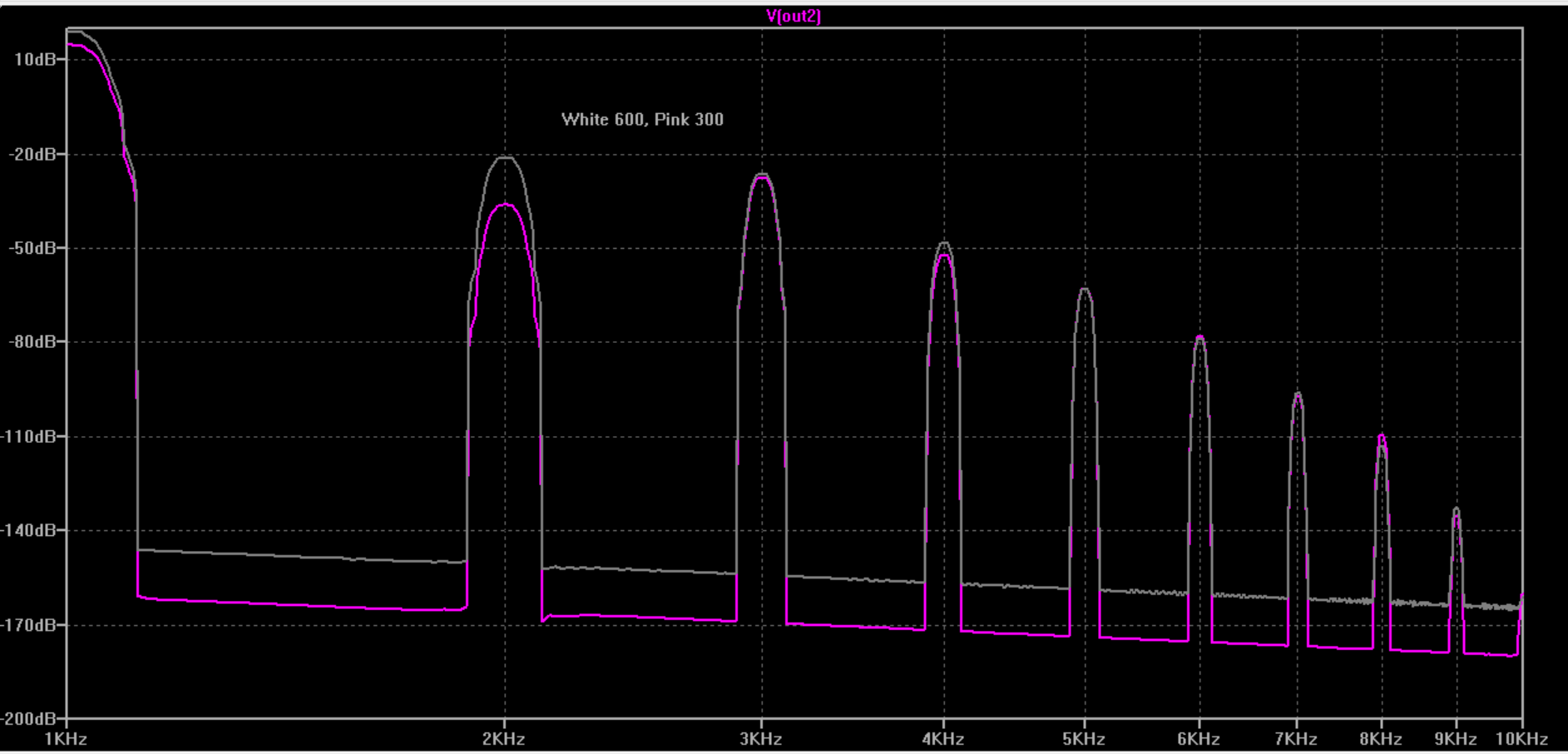

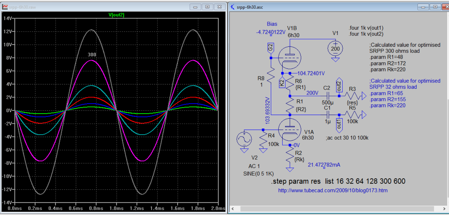

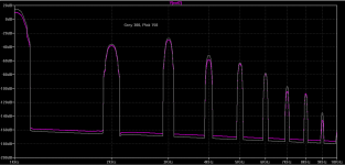

The following sims are based on SRPP+ All-in-One & Mu Followers
So it optimised SRPP, I plug in his optimised value for R1, R2 for 32 and 300 ohms load. The sim has predicted THD matched the calculation. ie. distortion is least at intended load.
Interested to know how much the actual measurement differed, distortion wise and any others if you know.
2nd harmonic is not canceled out as much once the load exceeded (greater than) the intended load, 3rd harmonic has little changes.
