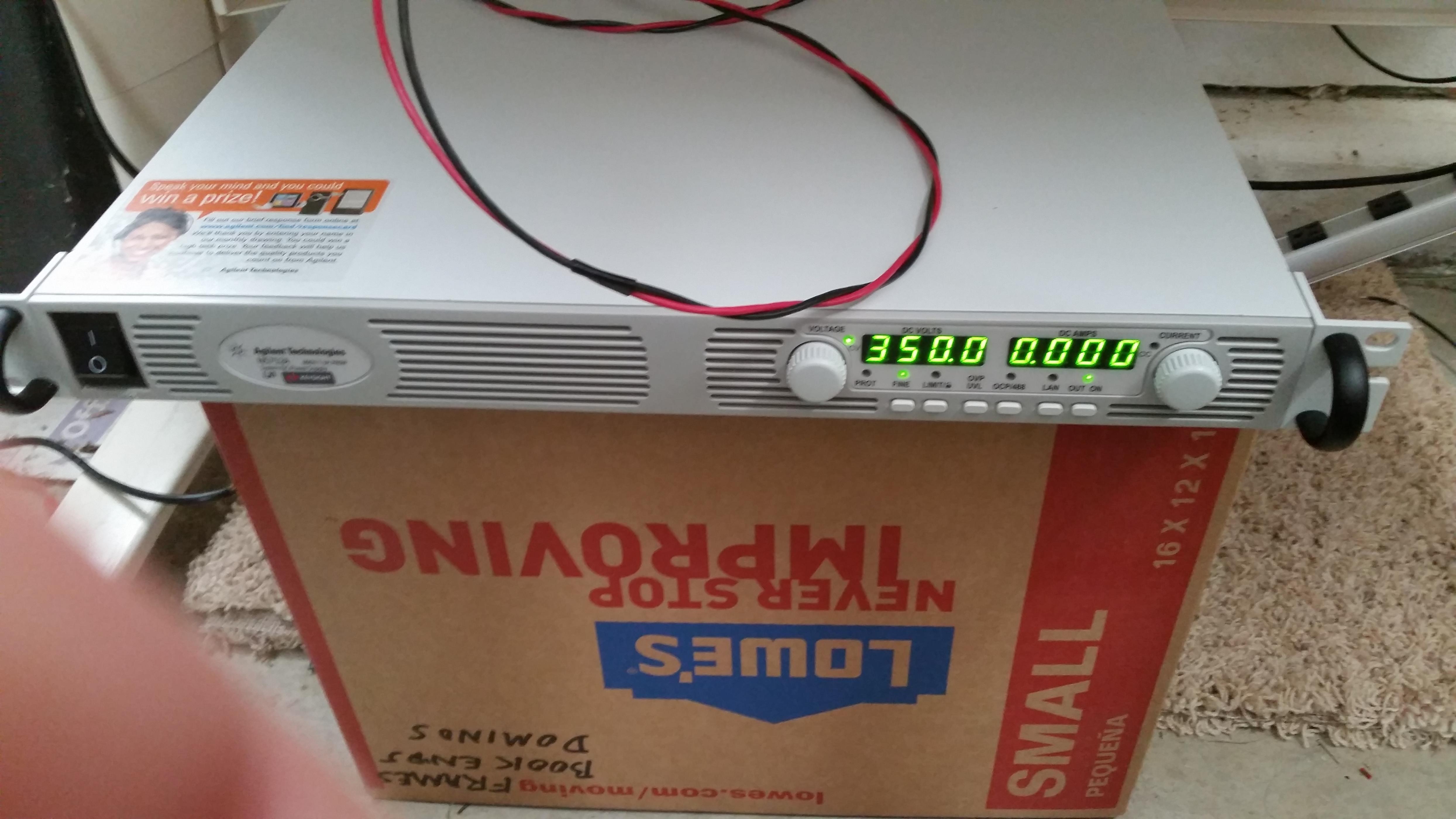

Photo of the 350 volts on the power supply.

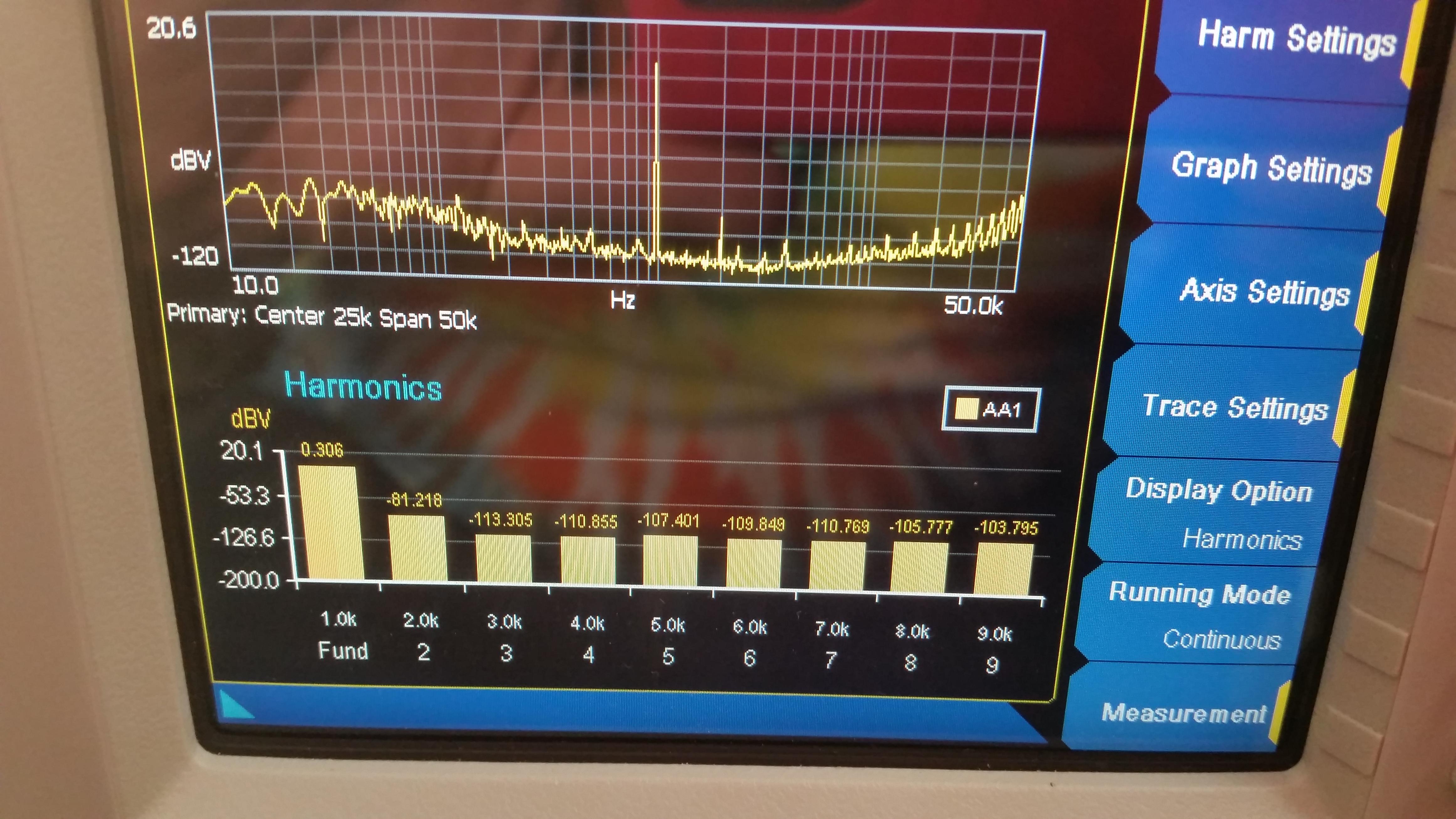

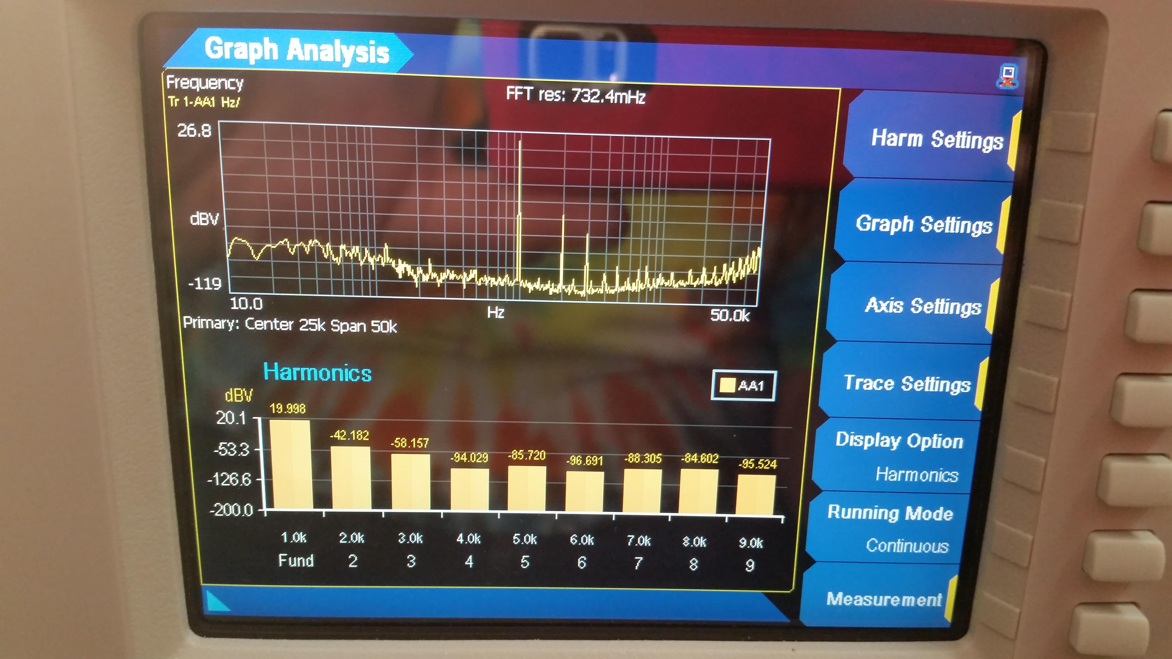

12AU7 1volt out Harmonics photo

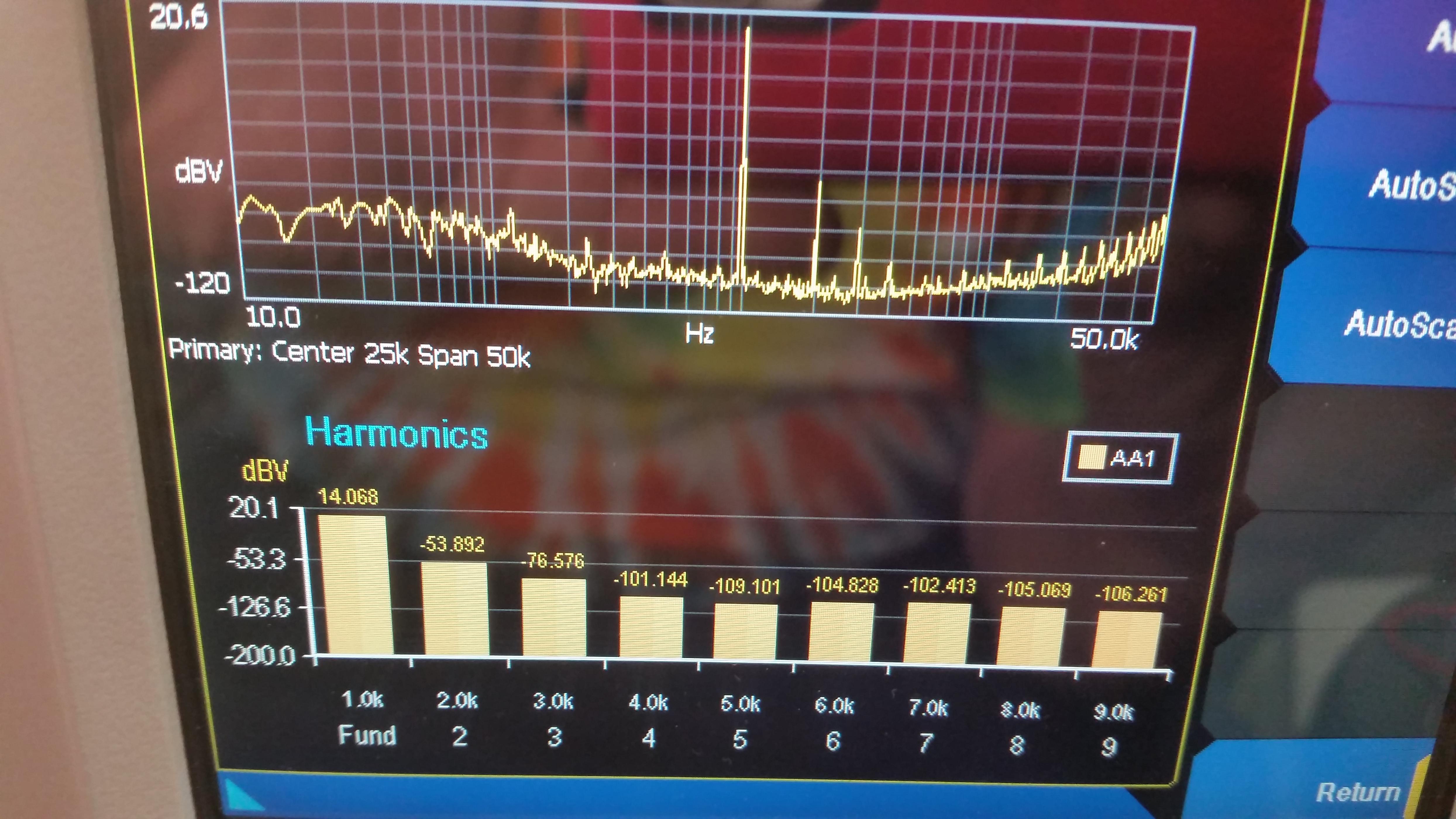

12AU7 5volt out Harmonics photo
12AU7 10volt out Harmonics photo
Note that the db level of the 1K Hz in the photos is not zeroed out, it is a positive number. You need to count down to zero and then down to the –db numbers for the harmonics on the display. The 1K db number for 1 volt output is the closest to 0, the 2nd Harmonic is near -80db.

Very nice, where can I find more info on the spectrum analyser you used? I think you can scan 20V to see if the 2nd harmonic is still dominating , this is the main concern as it is much expected of all PP topologies, thank you.

Keysight U8903B
12AU7A 12AU7 9AU7, same same same, just a different heater voltage
http://literature.cdn.keysight.com/litweb/pdf/U8903-90045.pdf?id=2557194&cc=US&lc=eng

That is a really nice analyzer, but the display on the lower part looks a little cartoony. I'm dying to try one of them out. I know the display is very high resolution in real life.

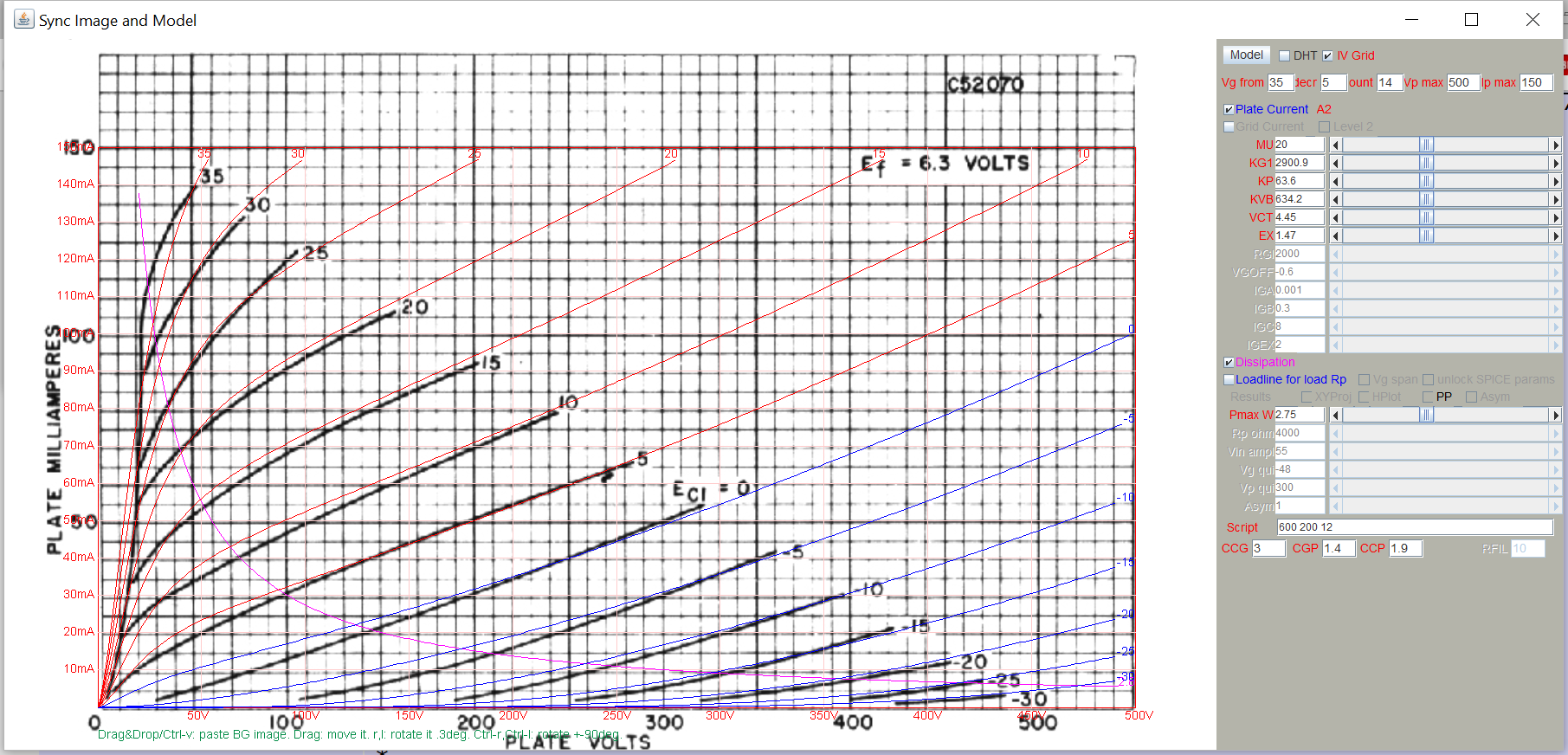

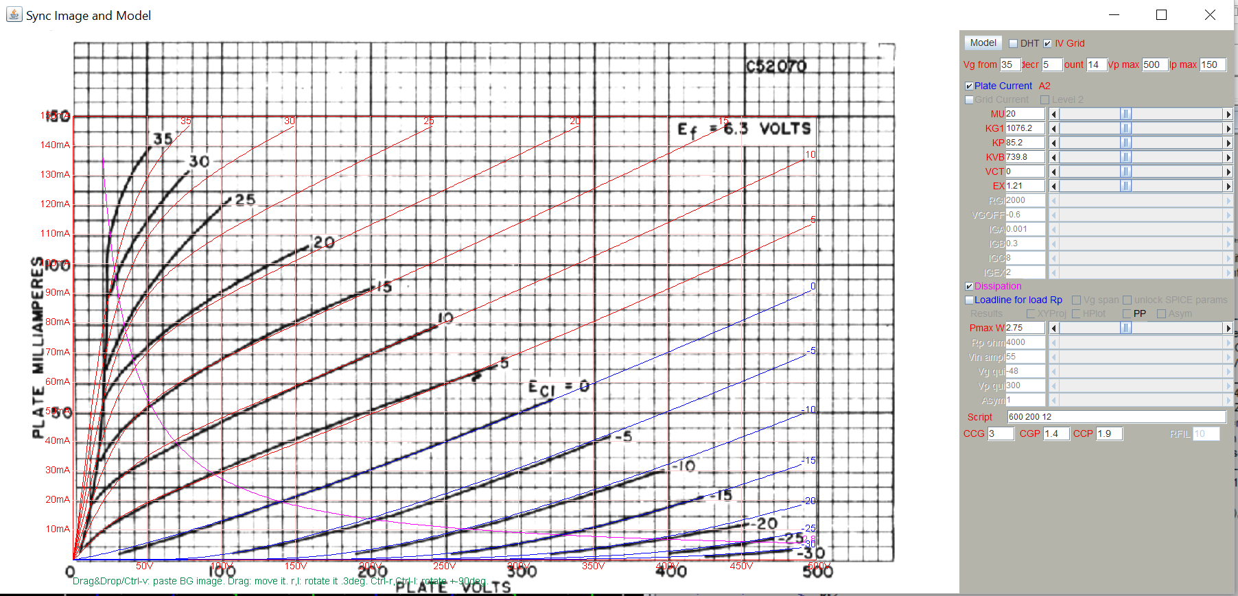

Agreed. I remodeled 12au7 from the previous attached URL datasheet, I found that it's same as 12au7 that our friend supplied 18.55k load. That is correct. The 12au7a model I have is quite difference so I won't use it for the time. So you just need to scan 20V, my FFT data shows that 2nd harmonics no longer dominated at or above 20V out (for your reference only). But never mind if not done.
Here is the 12au7 model I just painted (the grid plate cathode capacitance is not optimised yet), for future ref:

Keysight intends this analyzer is to integrate into a larger system for automated lab and factory floor testing. The front panel works on my small bench as is with my cell phone camera. This thing has GPIB IEEE 488.2 input output and remote control. There is also Lan and LXI function. You can connect a flat screen monitor and hang it on the wall.
I am having fun poking and measuring real world stuff that was only text book stuff to me before.
So far I am getting a crick in my neck using the front panel.
DT

One correction, for 500V is off scale:

Send me the kit I will THD it DualTriode, it is puzzling , so low distortion,
Can you try different frequency : 20 hz , 10 k

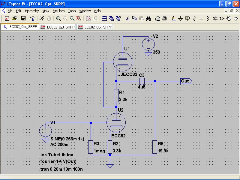

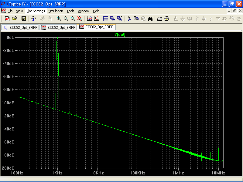

What puzzles me is that in a simulation with a 0.68μF coupling capacitor, the distortion spectrum is almost the same as you did obtain, 2nd harmonic at about -86 dB, nevertheless, with a 4.7μF coupling capacitor, 2nd and 3rd harmonics are at about -112 dB. 😕
The AC current through both triodes (almost out of phase) has a phase shift of about 499.7μs with the 4.7μF cap, and about 497.9μs with the 0.68μF cap.
Maybe 2μs could explain the difference, or it is another defect of simulations?

This is not totally true, just consider two totally different models, i.e.I believe the more likely explanation for the difference between SPICE and measurement is complicated by several variables. Even if or especially if you have a perfect valve model you may have perfect canceling. If you do not have a perfect model you still may have perfect simulation canceling.

Unfortunately this is just a simulation, but think for a moment, if your post#172 would have published a couple of weeks ago, more than one would have said that you are a liar, even you have published some pictures to prove that you are telling the truth. 😉
@1V RMS -84dB 2nd harmonic with no other measurable harmonics...with an SRPP...and an AU7...nah, that's just possible in simulations. 😛😀
how did you measure the 1 V is it 1 v p.p or Vrms ?? (trying to find something buggy ja!
