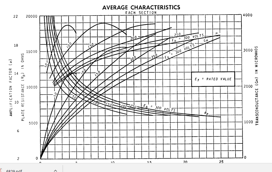

This proves tubes are way superior to transistors, the *au7 can drive powerful amplifiers signals.
I think in a real world amplifier the distortion figures are a lot worse because of the shared power supply with the main rectification variations.
In this test with the powerful regulated bench power supply the tube supply is unwavering and can show what the tube is capable in an optimized situation.
Many tubes are good like the *au7 and can be used in the Aikido.
let us not get into this "superior" thingy,
bipolar trannies in small signal have higher transconductance, 1/re. where re = 26mv/ie, ie being the emitter current in milliamps...
so at 1mA, any bjt will have a gm of 1/26...
compare that with the gm of the 12au7 at 1 ma/100v plate....800mhos
btw, our listening tests has demonstrated the broskie's ccda sound better than the broskie aikido...take note that this are mere listening tests...

TonyTecson , I don't see your point.
1. no one would bias a phono stage at 1ma...
2. no one would use a 12au7 in a phono input or gain.
3. in the aikido, I had the manual, the bias are not near 1ma...
4. I don't think the CCDA can even compare to the aikido...
i am not surprised that you did not see the point...😎
i am merely reacting on your comparison between a solid state and a tube..
i used the 1ma as reference to compare transconductance...for convenience....
1. i suggest that you look at a lot of other circuits, the 12ax7 can be biased at 1ma or less, that depends on the designer,
2. i never said use the 12au7 as input nor gain stage, the tube mu at 20 is far too low, that is why the 12ax7 with its mu of 100 or the 12at7 with its mu of 60 gets called..
3. in an aikido with 12au7 tubes, why would anyone bias that at 1ma? i will not...but you are welcome to try...
4. the ccda was subject to listening tests in comparison with the aikido, it is not my fault that people simply liked the ccda better...if you like the aikido better, and is happy with it, then i am happy for you...😀
please read my post carefully i am sure you can find something there...

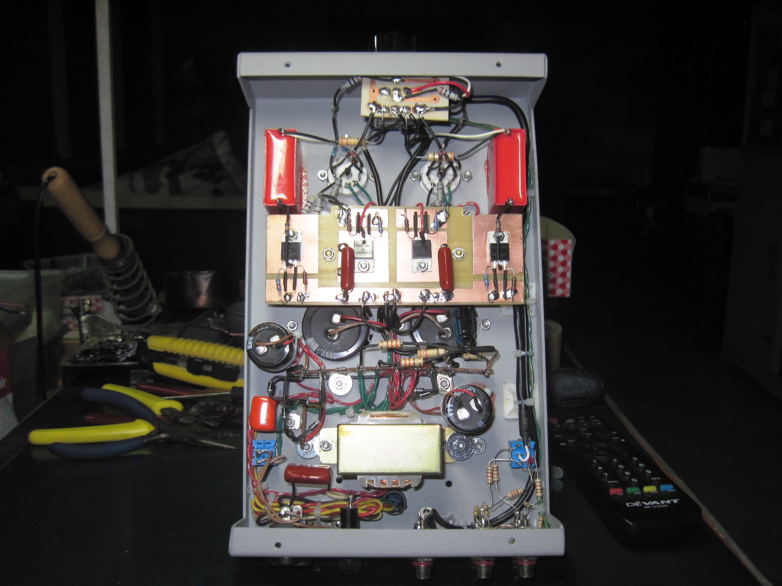

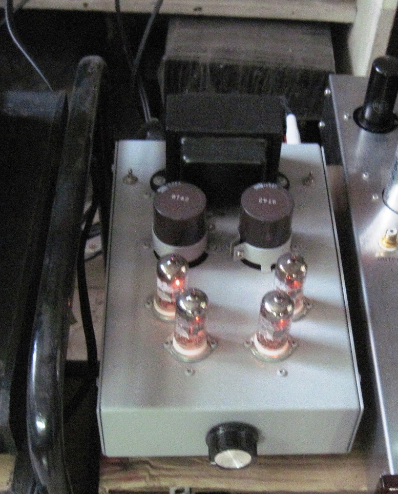

this is a 4kn8 broskie ccda that mimiks an aikido....
tube sections paralleled and IXYS mosfets run at >12mA....
i like it although gain is a bit high....this is my main preamp for years now...

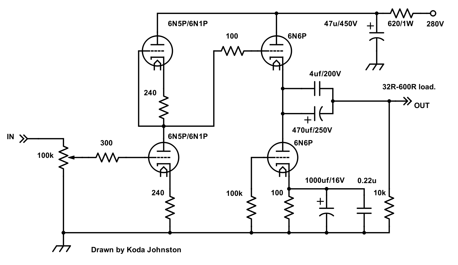

I have a 100 soviet box of 6n6p, I will never use them because they **** in my opinion, I had high hopes for them in DAC, IV, Pre-amp, Amps, and they let me down! terribly.
That's odd to me. I've used them many times and they've always worked great. What was your operating point?
Here's the circuit I mainly used them in. I think you will like it if you build it.
I even made a PPP 5W amp with 4 of them. Wanna swap some for some NOS Sylvania 6DJ8? 😛
