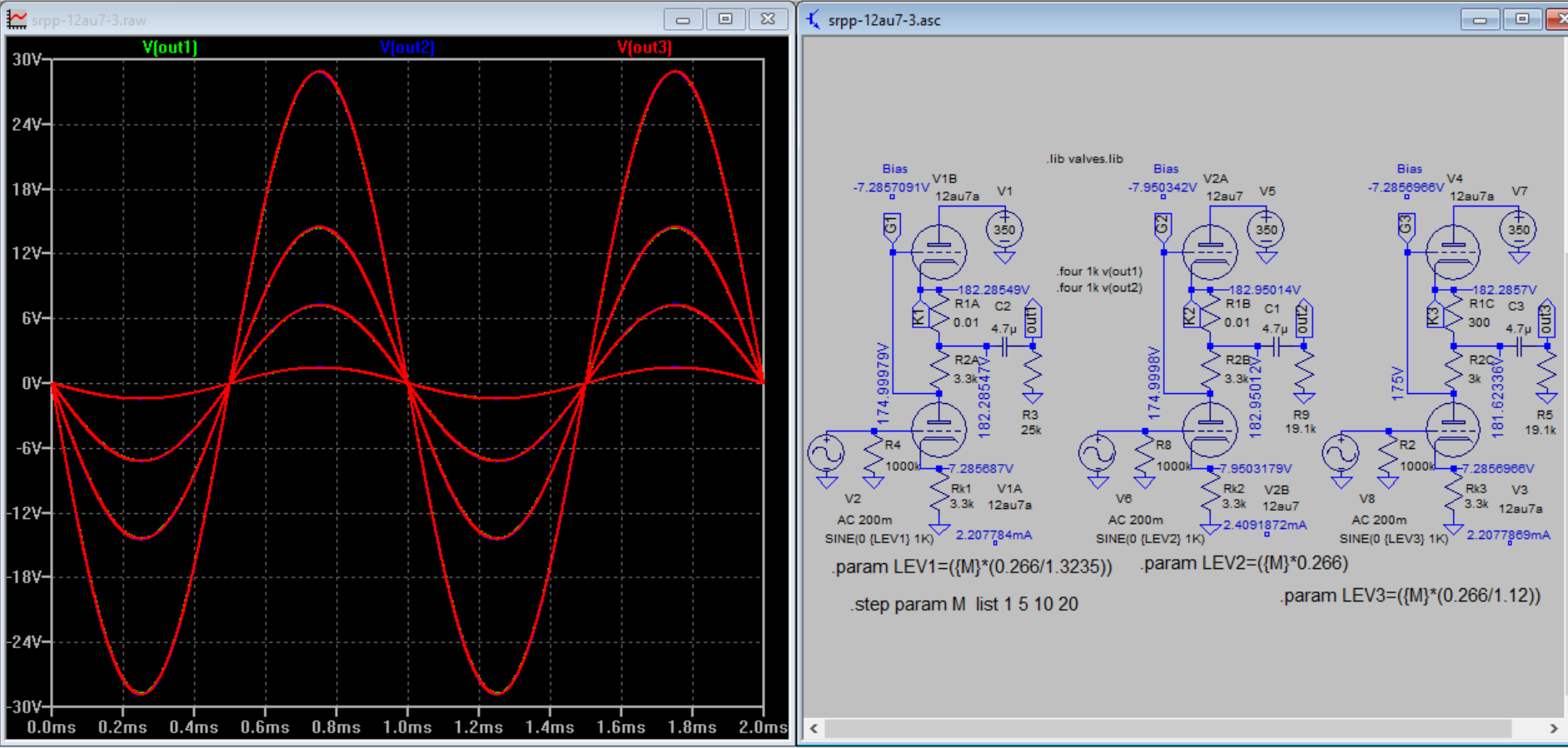

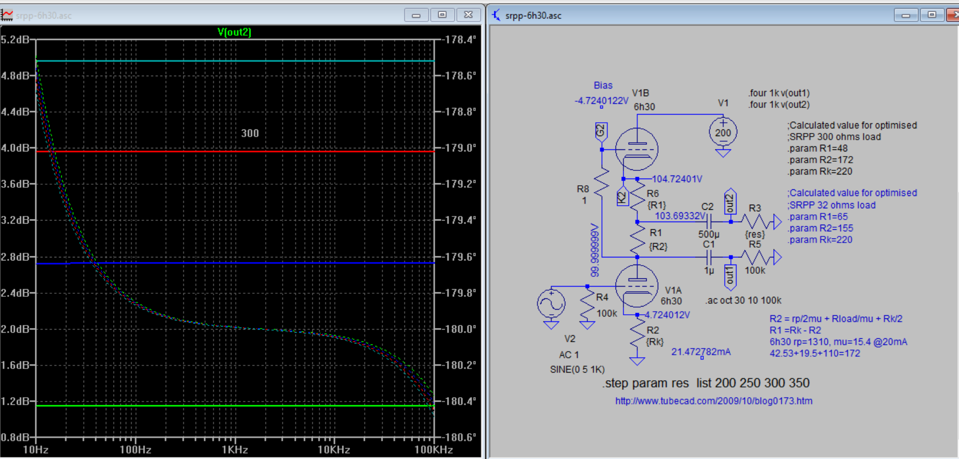

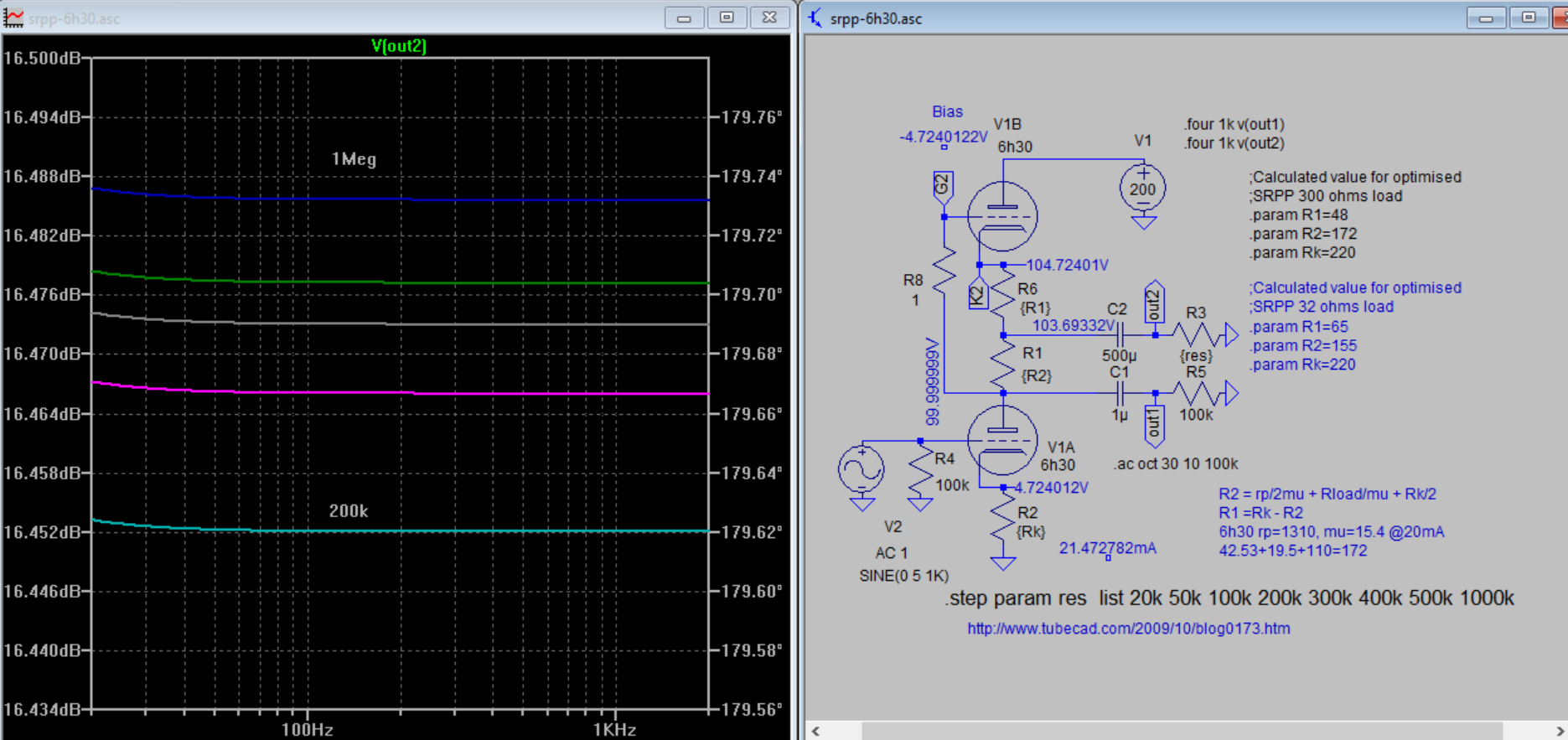

Here are plots for output level with load variation near optimal load and high load. At high load the output varies far less than near optimal load due load variation. Why some claimed it is not good for higher load??
Right in the null it will probably be third, as second will have cancelled out.
The mechanism of distortion cancellation is somewhat different for an optimised SRPP, as the optimum load is much smaller than the output impedance. The triodes are almost working into a short circuit so, unlike the half-mu stage (which relies on mu varying with current only), the optimised SRPP relies on balanced transconductance. This difference helps explain why measurements shows that SRPP has the expected null in distortion while the half-mu does not (except in simulation).

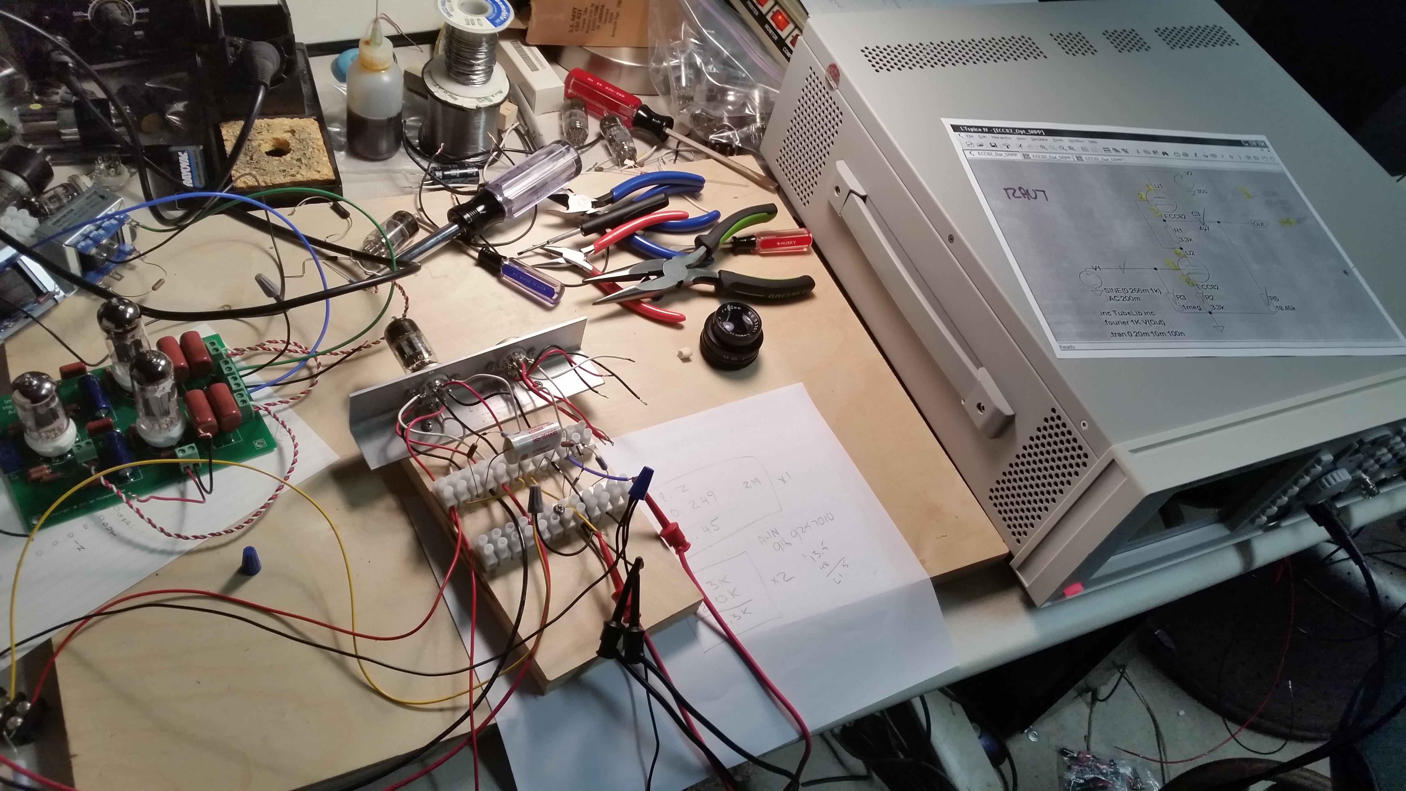

12au7 optimized SRPP tested at 350 B+ volts. A bit of disclosure, the tube tested is a 9AU7 Amperex made in Canada, this one has an orange globe printed on it.
This Keysight N5752A is windows based, there is a sequence of pushing buttons and turning knobs I needed to be careful not to let smoke out of other items on the bench. This powersupply makes less noise than the Sorensen XT-250-0.250.
Output voltages and Harmonics listed below:
-1 Volt
-76.5 db 2nd Harmonic
-110 db 3rd Harmonic
-2 Volt
-70.5 db 2nd Harmonic
-103 db 3rd Harmonic
-5 Volt
-62 db 2nd Harmonic
-85 db 3rd Harmonic
-10 Volt
-56 db 2nd Harmonic
-73 db 3rd Harmonic
-113 db 4th Harmonic
-117 db 5th Harmonic
I have a nice NOS Phillips JAN 6DJ8 valve sitting here. Who wants to do the Merlin Optimized calculations and supply the resistor values for a 300 B+ volts supply? We will test it next.

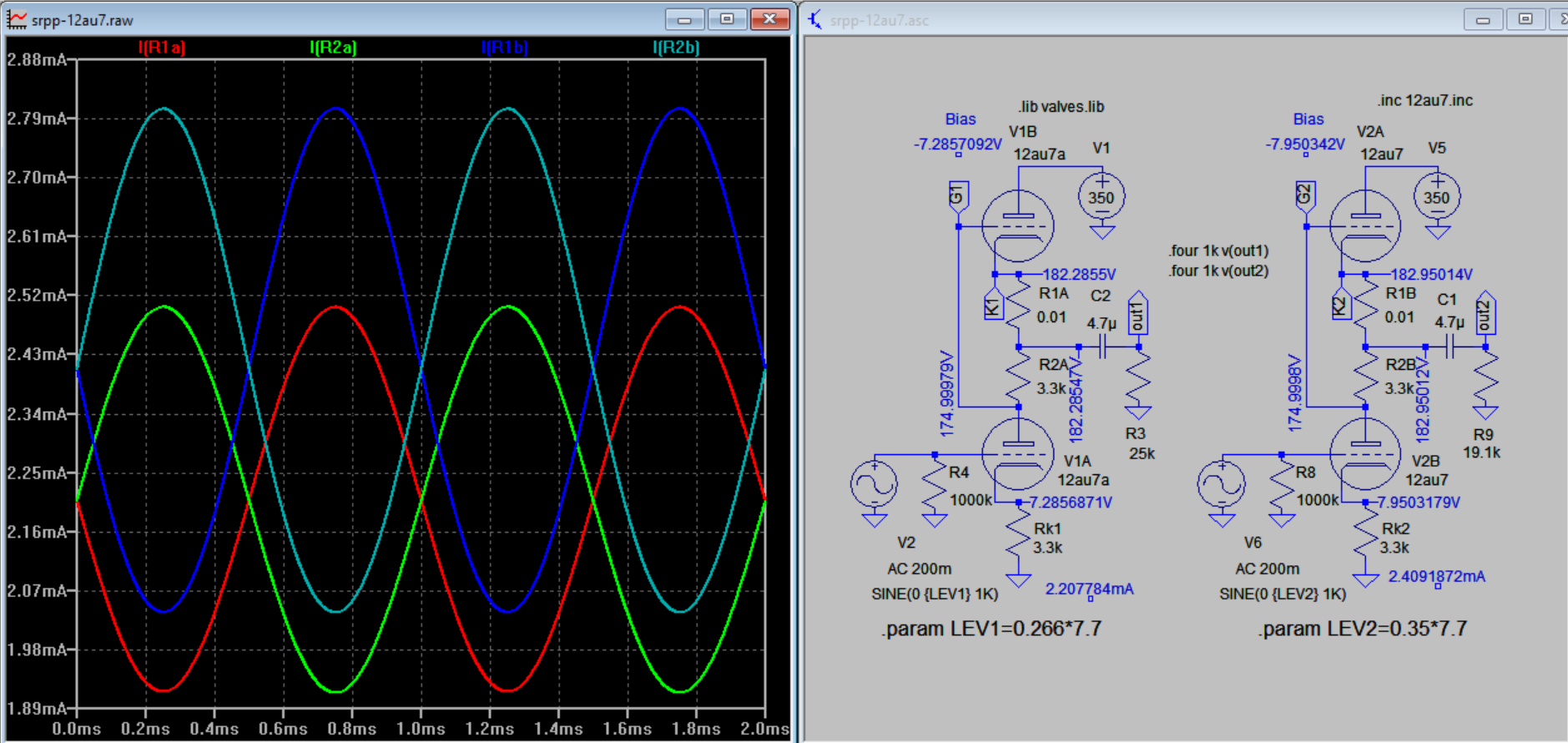

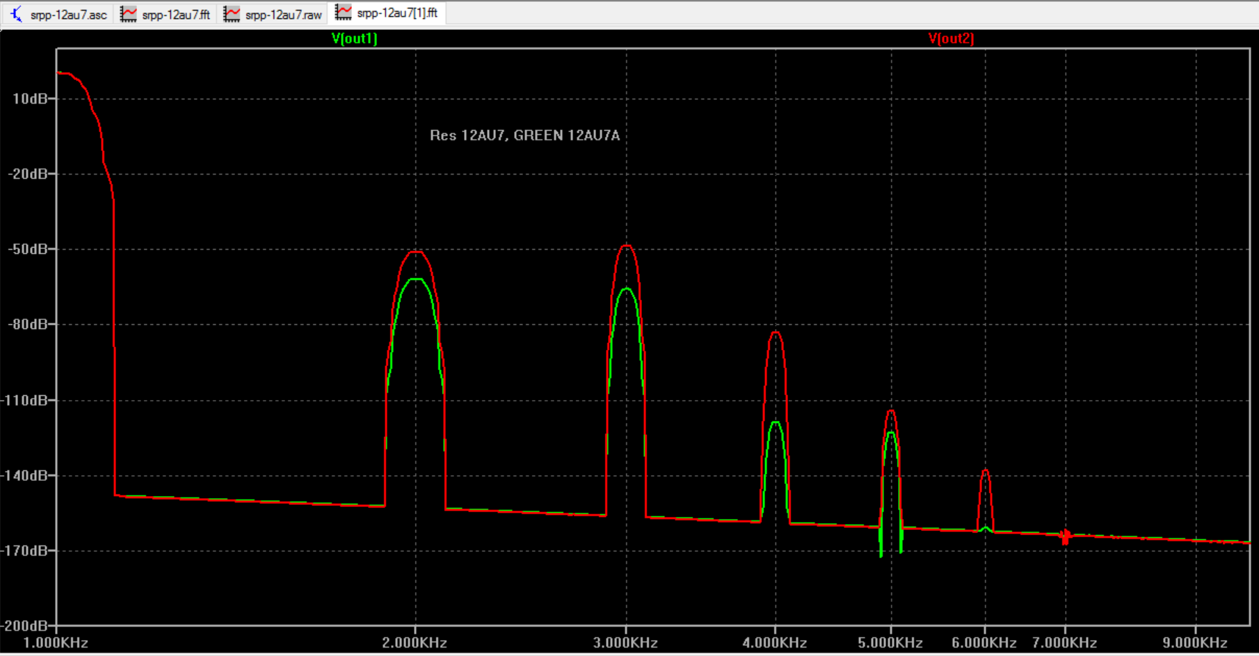

These sims indicated improved version 12au7 "A" has far less odd harmonics and THD. The optimised load is also somewhat different. To find out the opt load easy way is to measure the AC current in both tubes, adjust the load until they're equal.

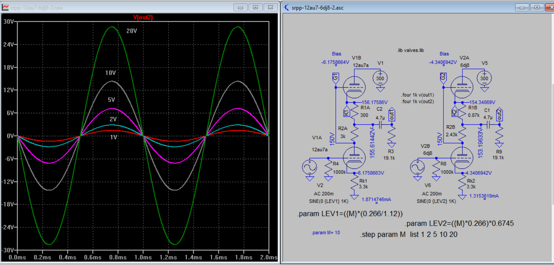

Hello Koonw,
I took a closer look at your simulation attachments.
I am thinking about “improved” and “optimized” perhaps both words for better or best. So the question: better or best for what?
You attached simulations show the 12AU7 performing better than the reputation of the 12AU7. Your attachments show Harmonics close to my measured values.
I did not see the output voltage reported on your attachments?
DT

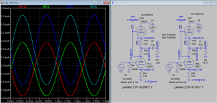

The voltage level is about 7.8V rms out.
Here are voltage level plot. To be get a fairer comparsion it maybe better to get the intended load constant (e.g one of 10k, 47k, 100K etc) then vary R1. Then the gains are also adjusted until they overlapped. Then we can more conveniently do the FFT for comparison. There must be a reason for improvement as many other tubes do improve over time, in reality you can hear the difference between different version, good or not is up to the listener to decide.

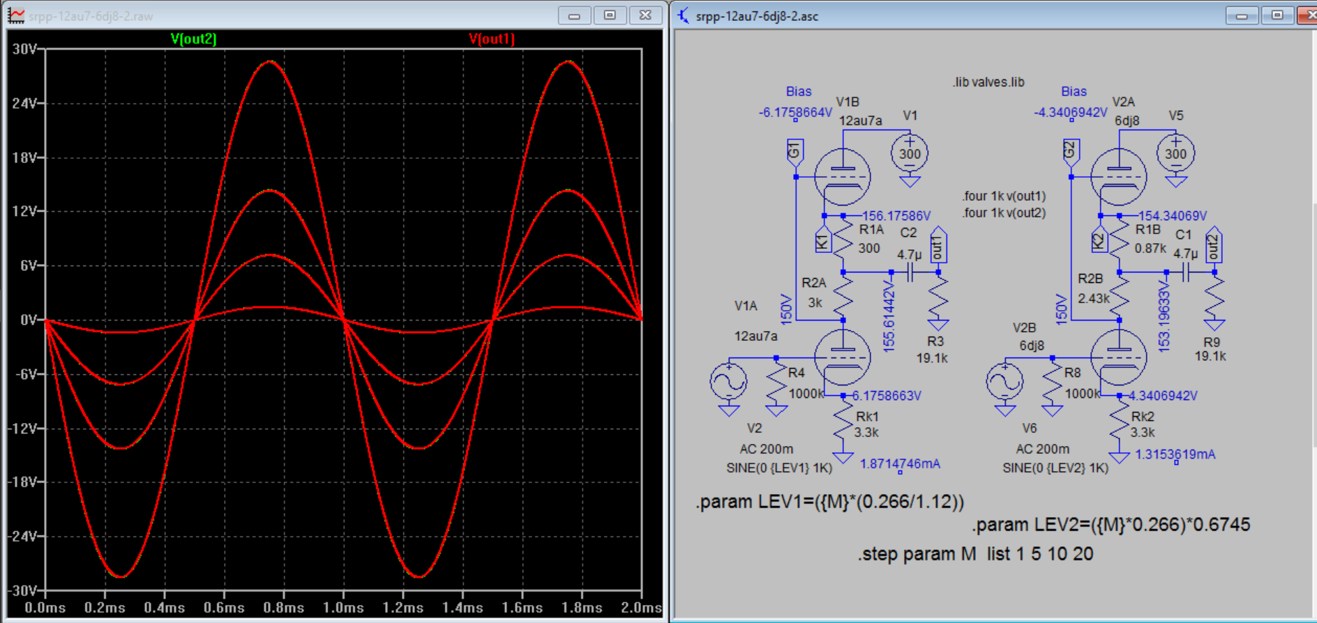

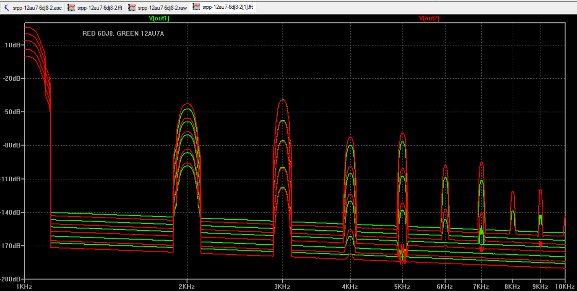

Here are distortion figures for 12au7a and 6dj8, they are very close under same load and ac current, 6dj8 could sound brighter judging from higher level of higher order harmonics, 7th, 9th for instance.
