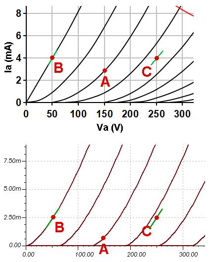

Correct. The problem is that SPICE models, and the simple theory, assume the internal anode resistance does not vary with voltage, only with current.I still do not believe that triode matching is the problem or that there is necessarily a problem in the first place. On a good day two triodes in an envelope may be pretty closely matched.
If we do have a problem, perhaps we need a better SPICE model.
In order for the linearity of the half-mu to become as good as the linearity of mu, the ra of the upper and lower triodes need to cancel each other out. But in reality they don't.
For example, suppose a 12AT7 half-mu is biased at point A on the upper diagram. Both valves are biased at this point, so ra is equal in the two devices. Now when amplifying a signal, one valve moves to point B while the other must move to point C. They both see the same current, but the voltage across one has fallen while the other has risen. You can see from the green lines that the anode resistances of the two valves are now quite different, i.e. they don't cancel out. 🙁
In the lower image we see the SPICE model of the same tube. Here points B and C show the same anode resistance, so they would cancel out and give ideal linearity. SPICE has fooled us with its naive model.

Merlin,
Thank you for the graphics. We can see how the slopes (rp) of the curves change with a changing input voltage even while the current and mu remain constant. I like the colors.
