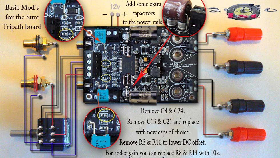

bobgoman, audio1st, and others,
I have compiled a short, somewhat messy, spreadsheet of possible mods. These are from the beginning to now. Since my board is on the slow boat, I have no way to start experimenting. If you all are interested in looking over them they could be honed down to help all. These are just board level mods so far. Next will be add-ons like volume control, led, and so on. Let me know, or email me directly.
Does anyone else think that it would be a good idea to get together a wiki on these boards, listing all of the recommended improvements etc? And, does anyone know where is the best place to host it?
Board Received.. Help
So after only 4 days my board, Ver 1.2, arrived in NZ.
Cleaned the crud off the back & gave it a test run as shipped. It's NOT a "Charlize", yet..
Tested on CD 'player & AR TSW 210's & AR 18's, on a 12v 4 amp SMPS ex an ATM machine..
Powered down & checked DC offset , -195mV & -200mV.
Removed C3 & C24.
Checked again & noticed a slight improvement.
Question: should I remove R-3 & R-16 ??. I think I recall reading somewhere that the max recomended DC offset was 150mV.

Yeah you need to remove R3 and R16 to reduce the DC offset to about 50mV.. I also did removed R1, R2, R15 and R18 on my amp..🙂
