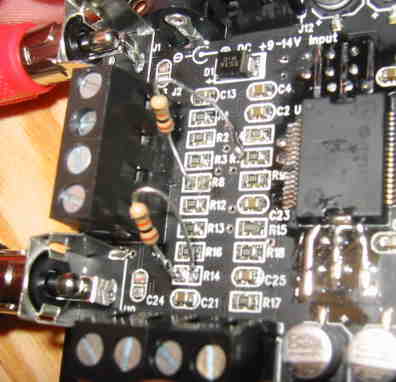

I'm moding a second amp and I think I tore off the one of the solder pads on the board... Looking at the amp so you can read the numbers it is the right hand side of R8... The left side is soldered on fine. I powered up the amp and tried pressing the 10k resistor to the board and nothing. Sounds to me like the contact area was removed and board is left. Is there a another place I can solder to??? (note R14 channel was moded just fine)
It looks like you have answered your own question in the picture?
You need to connect to R7, left hand end (furthest from chip)..
Your DC offset will be very high with the added gain. If you can you should remove R3 and R16..
The R8 resistor is in the air, not soldered to anything... Just looks like its attached 🙂
So R7 left side (leave the R7 SMD in tacked) and remove R3 & R16 this time I will use more heat and be more carefull

Magicdj said:That worked just fine. What does removing R3 & R16 do?
Mike
Hi Mike
The Amp in it's original layout, outputs about 500mv DC to the speaker terminals..we don't want this.. If you increase the gain then this can rise to nearly 1V of DC, worse. The S.I. T-Amp did not have this problem because it had a more simple circuit. By removing R3 & R16 you are disconnecting the extra circuit and this should lower the DC at the speaker terminals to less than 100mV. This could be as low as 10mV depending on the chip and component tolerances..

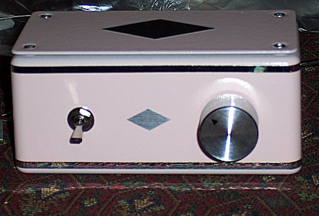

made one up for mom
I made one of these up for my mother so she could hear her TV.
OH, now that was overkill. I'm so jealous.
There was a bit of rewiring, polypro input filter caps, a quick potentiometer search, and 15.3v regulated super clean power.
I had no idea that a baby tripath could come up with such power! It certainly beats my other tripaths. And, the fidelity is quite a bit better. I have only one amp that this can't take for power, and none that come close on fidelity regardless of price.
Now, just imagine that on her cute little Dayton DC160S-4 based speakers (91db @ 47hz). For reference, the amp's input filter cap doesn't roll off at 45hz, but starts rolling off after that point.
See cute picture. Now, that's REALLY ironic! (considering its abilities versus appearance) 😉

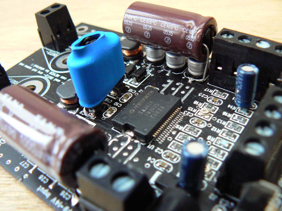

Hi all.
I'm gonna implement all the following mods (Audio1st list):
C21 & C13 replaced with 2.2uf Epcos MKT.
C3 & C24 removed.
R3 & R16 replaced with 1M ohms.
R1 & R18 replaced with 15k in series with 10k trimmers for DC offset adjustment.
R8 & R14 replaced with 26k7 0.1% 15PPM resistors.
R7 & R13 replaced with 31k6 0.1% 15PPM resistors.
D1 removed and bridged.
2 Panasonic FM 330uf 35V added near chip.
2 Panasonic FC 2200uf 16V added on rails.
EXCEPT for the R1 & R18 replaced with 15k in series with 10k trimmers for DC offset adjustment.
Do you think all the mods without this last one are ok, or is there something wromg if I avoid the one mod above? 🙄

Sorry, one more question:
"2 Panasonic FM 330uf 35V added near chip": are C10 and C18 to be removed and changed with these?
"2 Panasonic FC 2200uf 16V added on rails": are C27 and C31 to be removed and changed with these?

Hi Kooka,
If you are not going to add trimmers then just remove R3 & R16 and don't add the 1M resistors..
The input resistors, R8 & R14 where replaced by the strange value resistors only because they were the only values I had that were better quality.
The same applies to the feedback resistors, R7 & R13.
Better quality 20k's at all four positions is probably the best solution unless you require the following..
If you wish to increase gain then either replace R8 & R14 with 10k's, OR replace R7 & R13 with 36k's. These again are just guide values..
I left the original caps in place and the values used are what I had left over from previous projects so again, only a guide..
PS if you remove and bridge D1 make sure you have your power supply polarity correct, without D1 you will blow the chip with reverse polarity
Good Luck..

Thanks Audio1st, so you just ADDED the 4 Panasonics without removing the original caps, right? And the places where to adda re C10 and C18, and C27 and C31, right?
Yes, no removal.Thanks Audio1st, so you just ADDED the 4 Panasonics without removing the original caps, right? And the places where to adda re C10 and C18, and C27 and C31, right?
I attached to C9 & C19...
The other caps can be attatched to C26, C27 or C28 and C29, C30 or C31..
Observe polarity, negative to the outside of board..
I found it easier to attach the caps if you bend the legs into an "L" shape..
