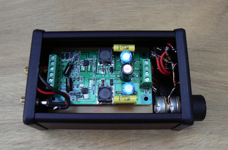

I finally completed the mods to my 2024 board. Having killed pads on C3 and C13 and C21 and C24, I am indebted to Audio1st for the alternative method of connecting to R8 and R14.
Initial impressions (after only 5 mins) It Works !
http://i73.photobucket.com/albums/i239/saxonsex/sure2.jpg
http://i73.photobucket.com/albums/i239/saxonsex/sure1.jpg
http://i73.photobucket.com/albums/i239/saxonsex/sure4.jpg
Had a chance to do some listening on my test bench (Hrrmm, Cough) For test bench read Workmate in garage with old Mission's and NAD 3020 as a pre-amp.
It doesn't really like 12v does it. No wonder they revised the later versions to 9-14v. I am using a 13.8v at the moment and have got reasonable volume. I have read that 16v is possible and so I will make a PS at 16v. However in main system I only need about 1Watt.
It sounds pretty good. So some running in and 16v should see it alright.
