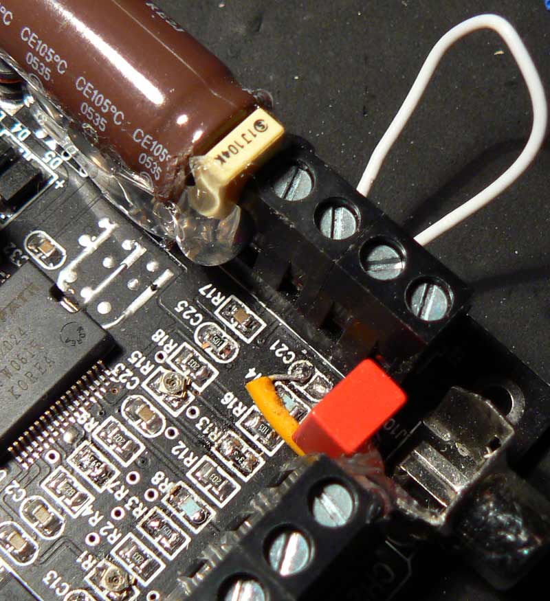

Sleep anyone get it to work?
Reviewing the TA2024 datasheet I see the SLEEP Input Voltage is -0.3 to 6.0v.
The datasheet also says the following
"Sleep Pin
The SLEEP pin is a 5V logic input that when pulled high (>3.5V) puts the part into a low quiescent current mode. This pin is internally clamped by a zener diode to approximately 6V thus allowing the pin to be pulled up through a large valued resistor (1megÙ recommended) to VDD. To disable SLEEP mode, the sleep pin should be grounded. "
I measured the voltage at J14 VDD and GRD and got 12v, so I assume J14 VDD terminal can not be connected directly to J14 Sleep terminal initiate the sleep.
Post #24 (http://www.diyaudio.com/forums/showthread.php?postid=1374517#post1374517) and Post #181 (http://www.diyaudio.com/forums/showthread.php?postid=1396009#post1396009) touch on utilizing the Sleep terminal. Both indicate that a direct connection from J14 VDD terminal to J14 Sleep terminal is not advisable.
So anyone have any suggestions on whether I can wire my momentary push-button to control sleep mode on this board?
Hi nbrophy, for sleep to work you would need to remove R17, replace it with C25. Then replace C25 with a 1M ohm resistor. This will keep it in sleep mode until the sleep terminal is connected to ground. This will not help you with your "momentary" switch because it must be permanently connected to ground to stay working..Sorry..

Mods: Removed C3, C4. Added 2200uF to the rails. Removed R3, R16 and DC offsets are approx. 2mV and 30mV.
