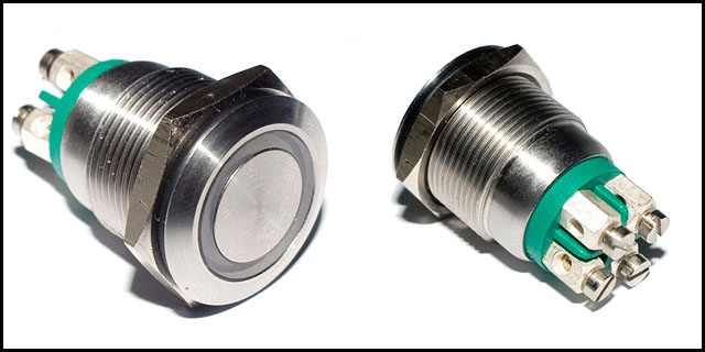

Latching circuit for NO momentary pushbutton switch
I would like to attempt to still use my normally open momentary pushbutton switch as a power switch for my amp.
I found the following article on how this may be achieved (http://www.edn.com/contents/images/102804di.pdf).
I am complete newbie when it comes to electrical circuits so bare with me. I am attempting to read up as much as I can comprehend.
The article mentions that at higher voltages applications may require a proportional increase in some of the resistor values. R2 and R4 should be left constant at 470k and 1k Ù respectively and R1 be increased to 4.7MÙ for 10v application (I assume also acceptable for 12v?). Will any of the other resistor values need to be adjusted for my 12v 3.5a application?
Also can someone give me some guidance on selecting the appropriate switching transistors for Q1, Q2, Q3, and Q4?
Thanks,
Nathan

The major underlying issue with using the momentary push-button, especially in that circuit, is noise! You will be running the risk of inecting unwanted harmonics into your power supply, and basically poisoning the well. My advice, if you were to stay on this path, is to go with a simple circuit, 555 timer comes to mind, with a straight pass through on a relay to assure a clean supply voltage. The only other option I see with a momentary, you could use it to put the amp into sleep mode, which should work like your normal off the shelf units. But, I may be mistaken about that one, do not have my amp yet to experiment. There are some very interesting latching relays on Digi-key. Trying to research it now, will let you know if I come up with anything. Maybe someone else has experience with these?
Got my board today, doing a dance!
nbrophy, there is more than likely a way to use the latching relays for your momentary switch. The big question is, how much would you like to spend? Right now, with the research done, it looks like you will nee $20-30 in parts. Relay, debouncing circuit, possible second relay.
Thanks for the help zayne742, but I could not bring myself pay more a then the amp itself. I am fond to the switch due to its nickel finish matched my nickel volumn knob.
You mention using my switch to put the amp into sleep mode. I was under the impression that the sleep and mute terminals of little use based on earlier posts.
