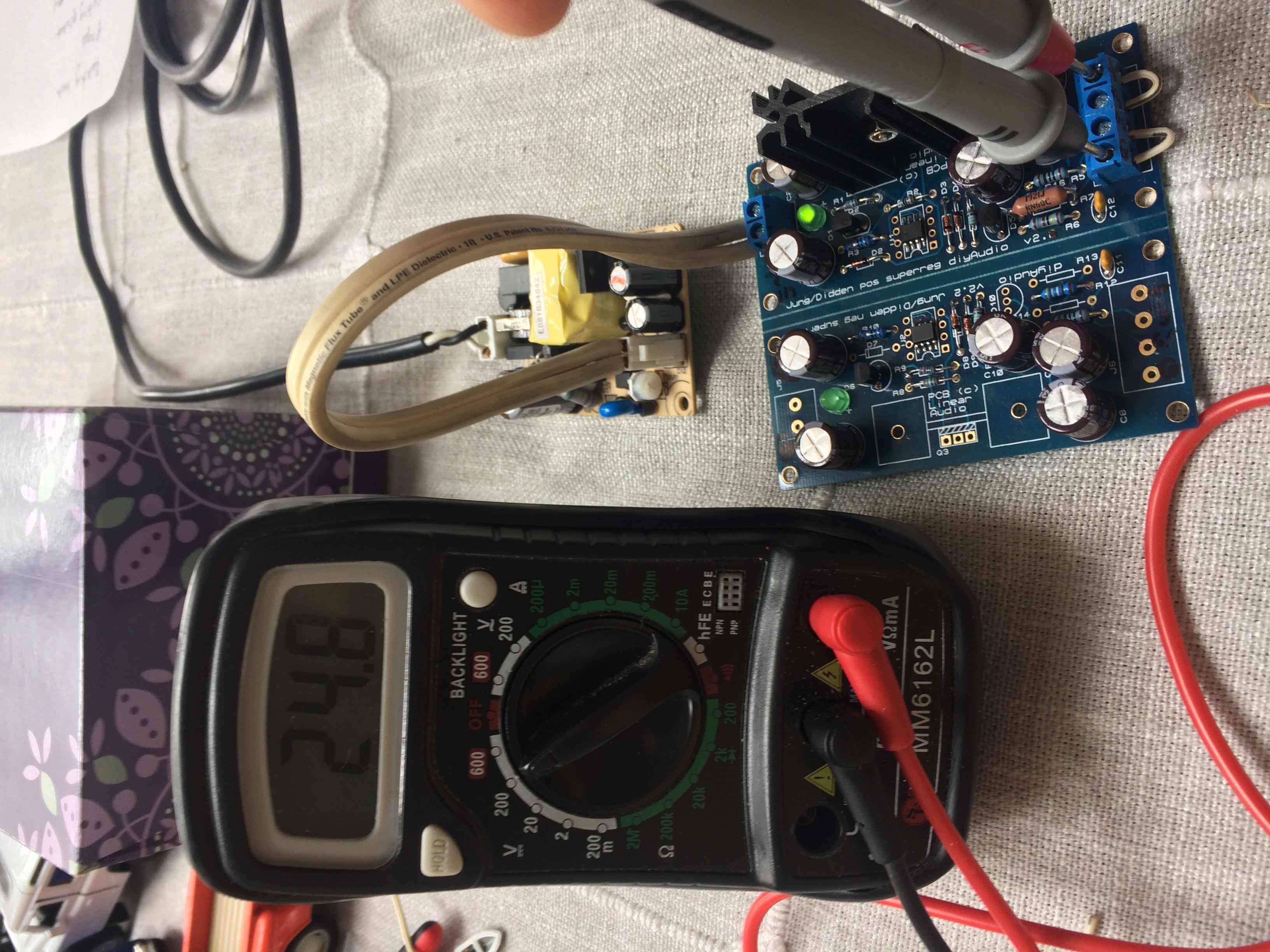

Hello,
I built a single rail 24v Superreg, but getting 24.8v, with NO LOAD. Did I make a mistake with my calculations or do I need to put a LOAD?
Powering the Superreg with exactly 27vdc.
My math:
To get 24v I did the following:
D5 change from LM329 to LM4040-10
24V - 10V = 14v
14/10 = "Z"= 1.4
"Z" multiplied by R7 or R14 value = R6/R13 value
for
R7/R14 = 1K
R6/R13 = 1.4K
D2(pos) and D7(neg): change the zener from 6.8v to a 12volt
thanks!

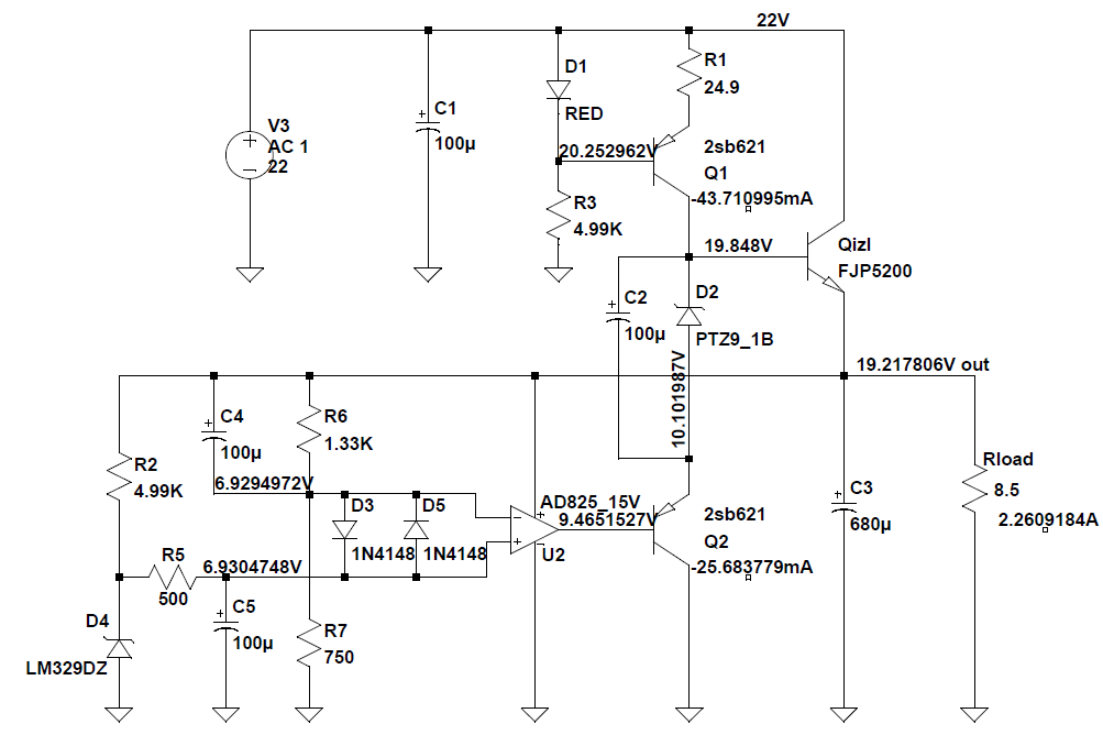

is the CCS really essential for the OP amp? I have seen somwhere a version, with pass transistor a PNP instead of NPN for positive rail, where op-amp was sinking current directly from the base of PNP. What is the benefit of having a CCS there?
(i`m trying to build symmetrical 18V+-, for 2,5A quiescent current, and predicted 0,2A-3,1A current swing). Pass transistor has around 120 beta.
original schematic is designed for about 200mA. I need 2500 mA Iq, and 3200mA max swing. I had to tinker with the schematic anyway.
I read about best possible Voltage References, i.e. "ultra low noise" from Mouser.com, as well as discrete solutions from Walt Jung based on 6,2 Zener, and also generally about noise in LED depending on bias current.
It seems to me, that VoltRef does not appreciate too much bias current, so i decided to go just a safe distance from regulation knee at 660 uA. Am i wrong?
