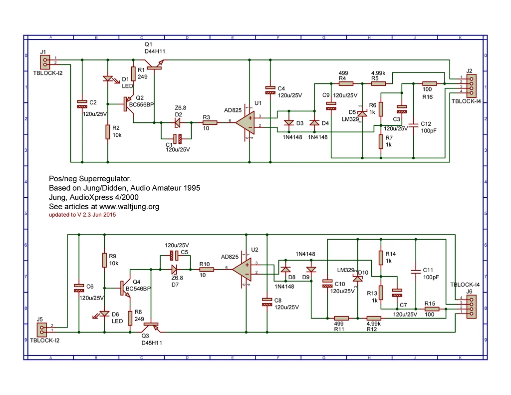

I have taken all the measurements as per the whole design and discussion yet it remains at 13vdc.
I have installed a trimpot in place of R6 to adjust it spot-on and no luck.
Tried 2K2 with 5K45 ratio and the 1K with 1K4 ratio and no luck. The Zener is a 12v unit and I have confirmed it.
On pin 2 I get 5.7 and on pin 3 I get 6.3vdc
Supply voltage is 36vdc
Load is a Pass XLmini filter board for 24vdc.
What is your ref part?
Please show measurements on all opamp pins, and the two resistor values with which the measurement was done.

1 = 0vdc
2 = 5.7vdc
3 = 6.3vdc
4 = 0
5 = 0
6 = 1.7vdc
7 = 13vdc
8 = 0
Resistors - R7 = 1K & R6 = 1K4 - R6 side is 12.5vdc and resistor junction at 5.7 vdc
12V Zener - A = 13.5 & K = 1.4vdc
OK, that's helpful. The circuit seems to work basically, the +inp = 6.3 where I expect 6.9 from the ref. but clearly the protection diodes at the input are engaged to protect the opamp. I assume you use a 6.9V ref. You mention a 12V zener but that is the zener at the output of the opamp, not the ref diode, correct? If that is so, we see that the opamp can't get the output high enough because in this scenario the 12V is too high (it's OK for 24V). If you had used a lower value zener you would have seen an output value of 2.4 * 6.9 = 16.6V with the resistor values you used.
From a 6.9V ref to 24v requires a resistor ratio of (24-6.9) to 6.9, is about 2.6. So 1k and 2.6k should give you 24V with a 6.9v ref.
It seems like you used the 12V zener value for your calculations instead of the actual 6.9V ref diode. Have I got that right?

Think of it in terms of the LM317 which you have used. The LM317 uses a 1.25V reference and then a two resistor divider to produce an output that is a multiple of the reference. The multiple is determined by the values of the two resistors in the divider.
The super regulator uses a different reference which might be 6.9V in your case. Then a resistor divider is used to produce a fraction of the output voltage on one of the inputs of the op-amp. The reference is fed to the other input of the op-amp. Then the output is a multiple of the reference voltage. The multiple is determined by the values of the two resistors in the divider.
If the output is half what you need then double the multiplier. For example, increase the upper resistor in the divider or lower the lower resistor in the divider to produce twice the multiplier (or ratio) value.

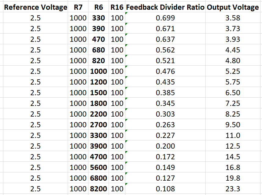

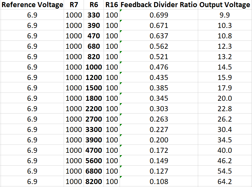

Well, I built the B1 Korg Pass design, and it requires +24VDC... I have a regulator that will provide that +24VDC, BUT I want to add this 'super regulator' to it... If I have an output of +24VDC (it is adjustable BTW) from my regulator, to the 'super regulator', what are the values needed for the 'super regulator' resistors R6, and R7, and maybe the zener diode?
Perhaps the attached spreadsheet would be helpful. I have used the resistor values from the store schematic and varied R6 over the E12 series.
Of course the op-amp shown can not operate at the higher voltages. And other components (Zener, capacitors) would need adjustment.
