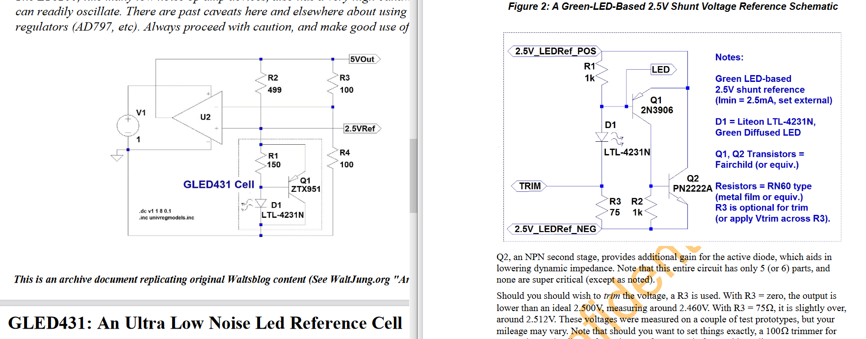

If I do the layout for the option with the 2N2222 and 2N3906 instead of GLED431 I believe either option could be assembled with different components and links (on the same layout). Should I just do the layout for the 2N2222 and 2N3906? Is that superior to the GLED431? So far I understand that noise and dynamic impedance are key. With the 2N2222 and 2N3906 I think the dynamic impedance is lower but the noise is a little higher. In this application I am not sure if absolute voltage really matters?
Similarly I could place a spot for a JFET and resistor next to the Cascode Current Source to leave that as an available option. I don't have many JFETs but I see that I can add BF245B to an order that is planned soon. BF245B is listed as 6 to 15mA IDSS on the datasheet. The other option is BF245A which is listed as 2 to 6.5mA IDSS
The 1.6Ohm rbb of ZTX851 (951) is certainly very nice. That is 1/10 of the 17Ohm rbb of my 2N4403. On a couple of my protoboards for references I paralleled three 2N4403 (in one case) and four 2N4403 (in another case). Also in my 60 dB LNA there are three 2N4403 in parallel. Perhaps 17/3 = 5.7Ohm will be sufficient for my purposes.

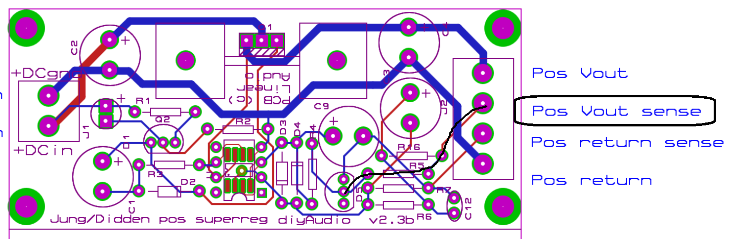

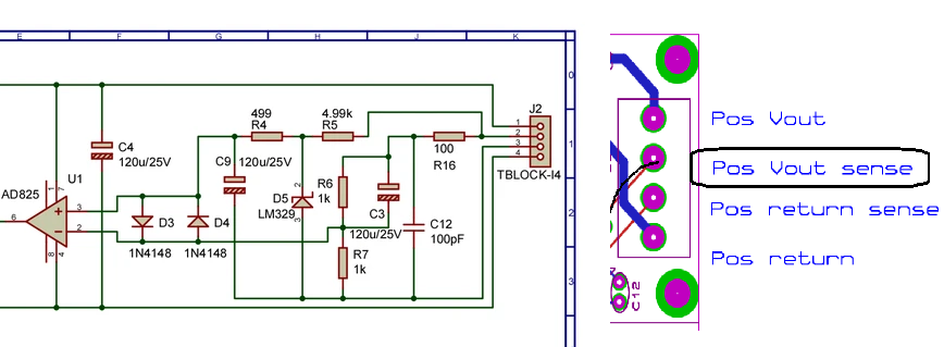

I have attached an annotated layout from the DIYAUDIO store for the super regulator. It seems like the reference is running off of the positive sense line?
So I should not do this and instead run the reference and opamp directly off of the regulator output from the pass transistor?

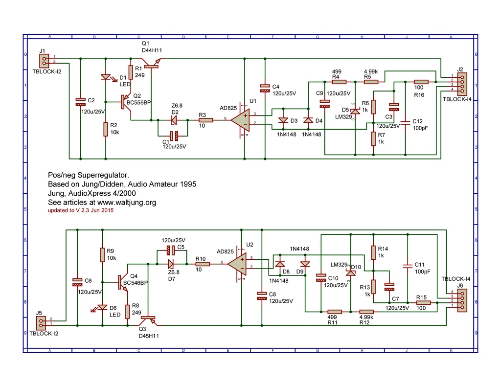

I have also attached the schematic from the DIYAUDIO store. It seems like the reference is on both sense lines (Vout and Return sense lines).
So I should not do that? (Correct?)
While I was doing my layout I was using the DIYAUDIO store schematic and layout as my "good example" reference.

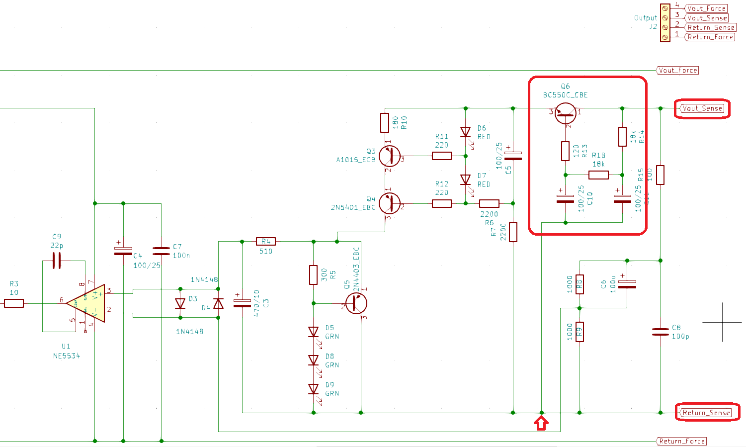

Could you please explain where your capacitance multiplier is connected? Is it fed directly from the output of the pass transistor? And where are you grounding the capacitor of the capacitance multiplier?
I am having trouble understanding how the capacitance multiplier can be connected and used for both the opamp and the reference if the opamp & capacitance multiplier should not be run off of the sense lines yet the reference runs off of the sense lines in the layouts and schematics that I have found.
I would not run anything from the sense (and sense return) lines. Any current going through those lines degrades the regulator performance.
Jan
If possible please take a look at my attached schematic (first attachment). The red box surrounds the capacitance multiplier that powers the cascode current source for the GLED431 reference.
All of the above is run from the sense lines which is what I see in the article for the LM329 reference.
Am I doing this wrong? If I replace the LM329 with the GLED431 and the cascode current source should I still run them from the sense lines?
Should I not use the capacitance multiplier? Or should I connect it differently?

I am not absolutely sure as I haven't tested this. But you are running some load current for the cap mux and the ref network from the sense line. That causes some voltage drops across the sense line so these drops will be directly reproduced by the regulator on the output.
In the original circuit, I made the tradeoff: running the ref from the output gives a chance that any ac on the output ends up in the ref voltage, while running it from the sense may cause a drop that ends up on the output as described above. In the end, because the ref load is pretty much DC only, it would only change the output with a minuscule DC value.
In your case with the cap mux and the involved ref, I don't know if the load is also pure DC or that there will be an ac component / noise load.
My gut says don't but it may not be a problem. If you use LTspice, you may want to look at the noise in the cap mux & ref load current.
But to be realistic: this are all very much extremely low effects which most probably make no measurable or audible difference. IF there are effects they may be at high frequencies where wiring induction starts to come into play; when that happens you'd see it on the stability and/or excess noise.
Still an interesting design question ;-)

I don't think the impedance of the cap multiplier is an issue as it is so much lower than the CCS that follows it. I initially used a cap multiplier in place of an RC filter to the opamp only as I had found this extra isolation of the opamp helpful. It was only then that I thought that it can do no harm and possibly be of benefit to use the same cap multiplier to feed both the opamp and the reference. I wonder what possible harm could it do apart from reduce voltage headroom?
As for loading the sense terminals, I have recently started to run additional wiring to the load alongside the sense leads to prevent the additional current flow in the sense leads from degrading the overall regulation. Much depends upon the location of the load. If it is all on a single PCB then the additional returns from the load are not an issue. Where distance and a larger wiring "loom" is an issue then it is better to feed any opamp/reference circuit cap multiplier directly from the force outputs rather than the sense, especially when they are so well regulated already.
The cap multipliers main role is the opamp feed which does have very slight current variations. The feed to the reference does not as it is via a CCS so it won't do any harm. The cap multiplier I have routinely used is a BC550c with 36k feeding a 10uF 50 Wima MKS (small) or a 10uF chip ceramic. I always use a base stopper resistor of circa 100 ohms. It directly feeds the opamp decoupling cap(s) and the the feed to the ref's CCS is taken from there.
John
