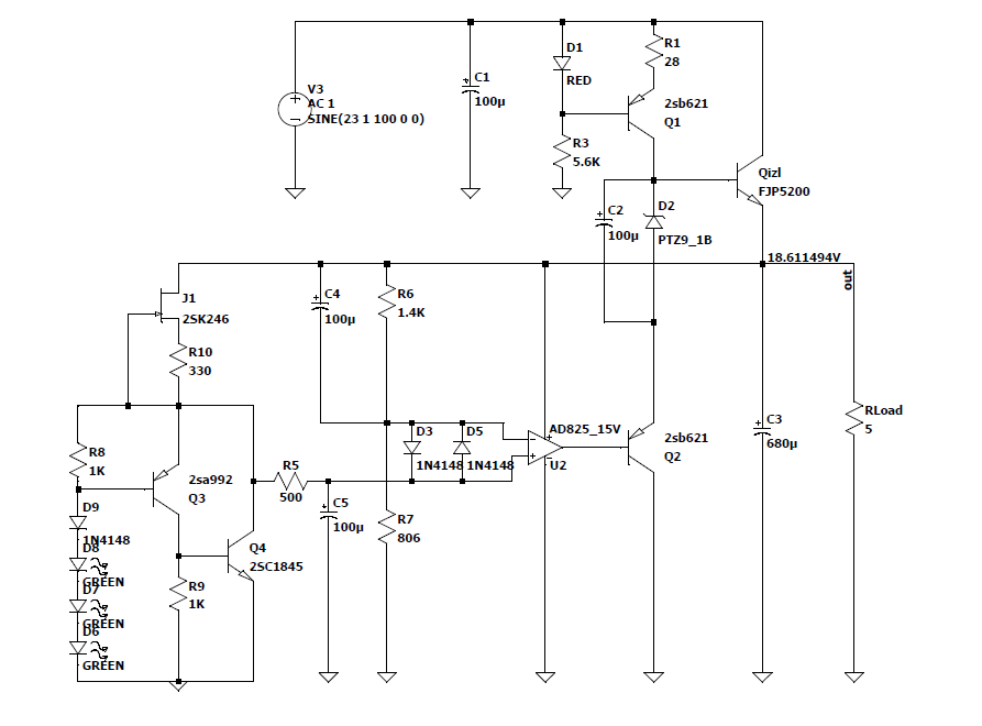

Super Regulator

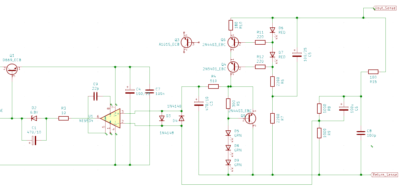

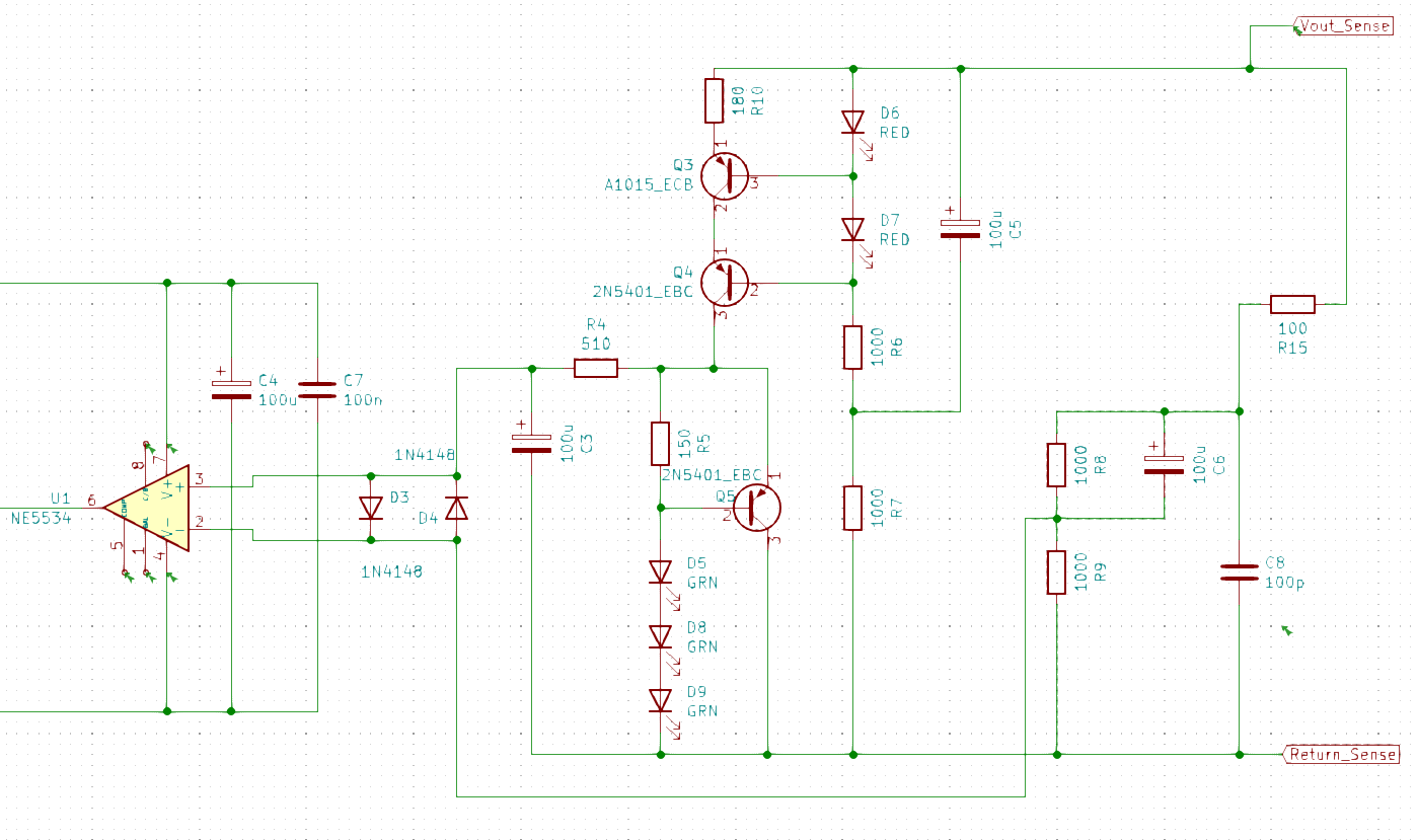

How does this schematic look? Does it look like this will work?
Is the fairly low noise 2N4403 better than the 2N5401 for the GLED431? (I don't have ZTX951.)

That's a yes to the 2N4403. BC560 would be OK as well if you have them.
What you have will work but may I humbly suggest some tweeks?
Suggest changing R6 and R7 to 2k2 to reduce current through LED's to approx 2mA. This reduces the Fco of C5 and R7 a little.
Suggest base stopper resistors for both Q3 and Q4 for guaranteed stability, 100-220R should do it.
Of the 5mA going through the GLED6v I would get more passing through the emitter of Q5 by doubling R5 to 300R. That trebles the current in the emitter to 3mA and reduces the effective impedance of the reference from 26 ohms to about 9 ohms. Even more rejection, likely imperceptible increase in noise from the LED's.
I don't normally use the R15/C8 combo but these can be omitted or linked out on any prototype board. I also prefer not to use C6 at all as it can introduce stability issues depending on the load capacitance/ESR and the opamp used (5534 not stable below a gain of 3!) and only gives a small decrease in noise. Also OPA1611 is loads better than the 5534 and doesn't need a compensation capacitor. May still be pin compatible if you use a socket here and external compensation on the 5534.
You may want to check out the ALWSR documentation over on the Pink Fish forum for layout, remote sense and tracking pre reg options.
Otherwise you are hot to trot!
John

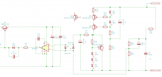

Ok. I have updated the schematic. Should I include the capacitance multiplier? Or is that unnecessary now that I have the CCS? (I assumed it was now unnecessary which is why I have not added it yet.)
For op amps I might switch to NE5532 and that way I can plug in LM4562NA (which is the best op-amp that I currently have). Not sure yet. I also have a couple OPA228 but those are not really for unity gain either.
Still trying to decide between A1015 and 2N4403 for the upper transistor in the CCS. 2N4403 likely lower noise but A1015 likely higher gain. Maybe no real difference here.

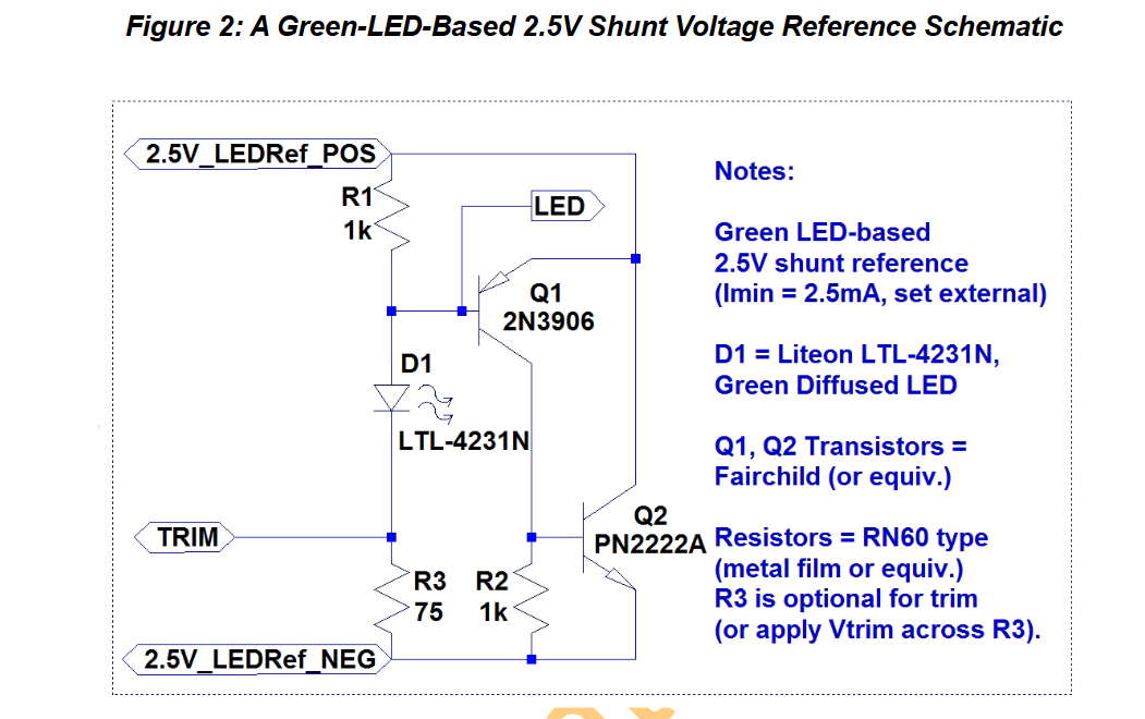

Walt Jung says this in that same article;
Note that the forward voltage of the LTL-4231N green LED (LiteOn) and the Vbe of the ZTX951 (Diodes Inc.) conveniently add, producing the desired Vout of 2.5V.
These two parts should not be changed if you expect to get close to 2.500V
but it also has a solution for that, it has a couple of nV higher noise than GLED431 but it uses 2N2222 and 2N3907 instead of ZTX951
https://refsnregs.waltjung.org/2New_Vrefs_082715_Draft.pdf

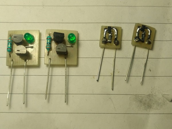

I use the same reference in Walt Jung shunt regulators that power digital circuits in my DAC and with three LEDs + 1N4148 for 6.8V instead of LM329 in WJ Improved_PN_Regs, but with 4A output current for JLH69 and Hiraga Le Monstre amplifier.
I supply the reference directly from the output voltage but via CCS with 2SK246 instead of a resistor, the minimum current in this case is 2.5mA while for GLED431 it is 3,5mA.
In all cases when I installed the WJ LED reference, the difference in sound was immediately felt, regardless of whether I changed the LM329 or LM4040 and ADR525, which I used as a 2.5V ref.

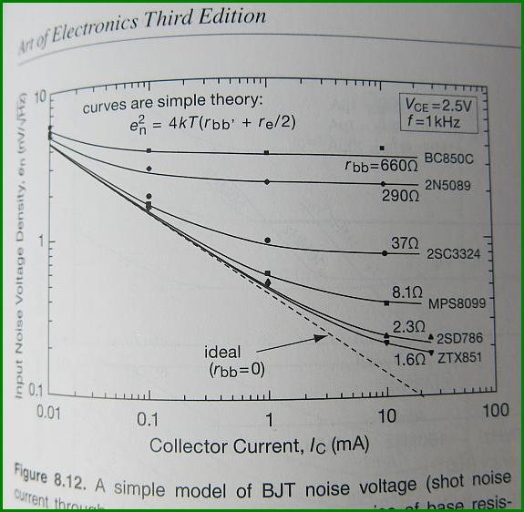

The table shows what makes the ZTX851 (951) the best option in the GLED431.

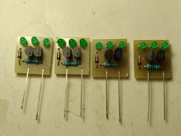

I really like your two pin ref mock ups, very similar paths to mine. Would recommend you try the OPA1611 in place of the AD825 and try the cap multiplier on at least the opamp. I would be surprised if you didn't hear the difference. Also have you tried splitting your R3 and linking the join to the supply with say a 100uF cap??
