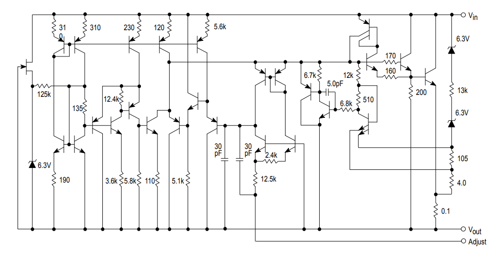

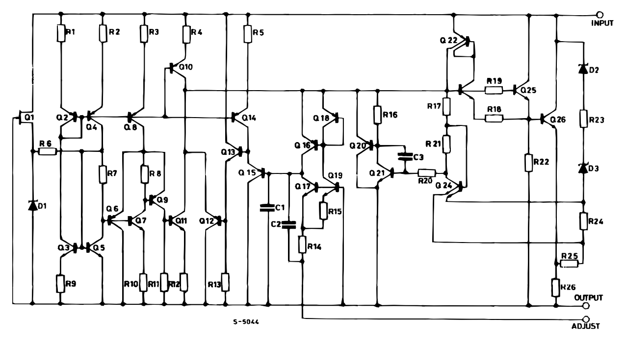

Joined 2011
The transistor level circuit schematics of the Motorola and ST Microelectronics LM317 datasheets, look pretty complete to me. They match one another but Moto gives numerical values for the resistors.
Notice the typesetting error on the top left resistor value. It's 310 ohms but the zero has slid downwards a little bit! The other emitter degeneration resistor in the current mirror, tells you what you should be looking for.
