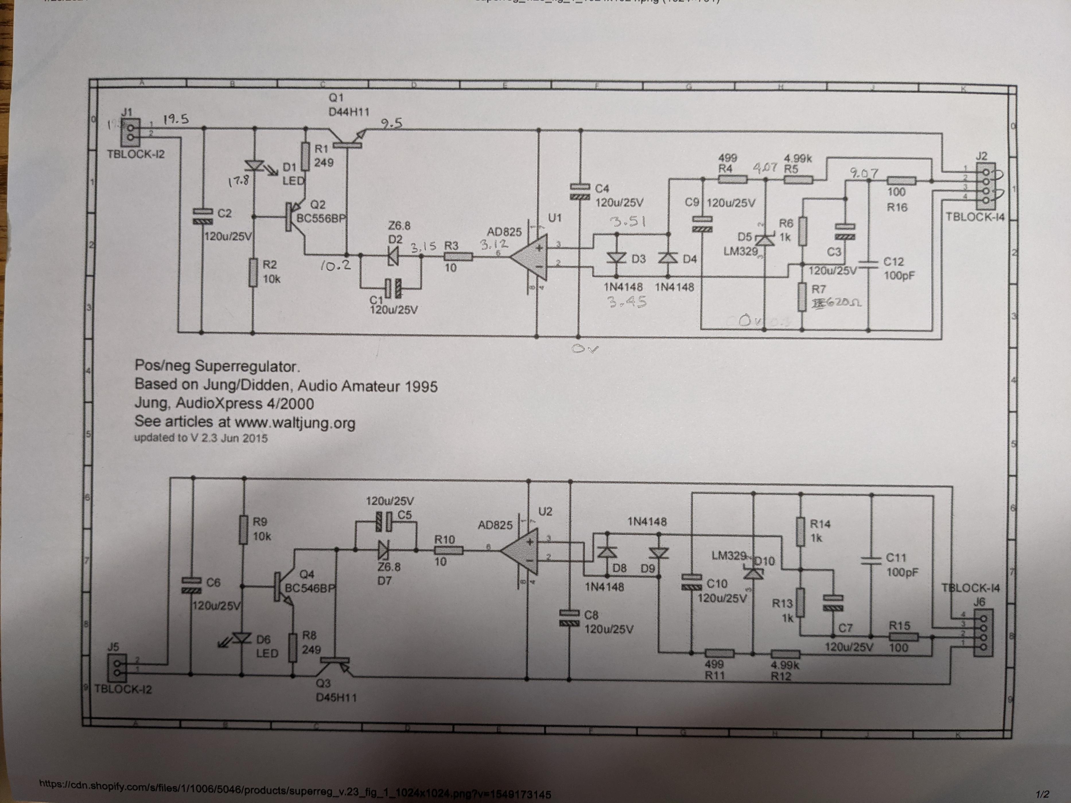

Can I test the neg board by attaching a 19.5 v smps that I'm using at my bench with the pos lead to board "DCgnd" and ground lead to "-DCin'?
Yes you can if you make sure there is no other ground connection to the SMPS.
BTW can you swap the opamp in the trouble regulator for another? It might be the opamp. If that makes no difference, can you replace the ' 329?
Edit: for you lurkers, what's the problem here in the pos reg? Voltages are penciled in. Expected Vo is 17 or 18V, but it's only 9.5 or so. What's wrong and why?

OK, my lawyer tells me that posting this comment is not an admission of lurking...
I can't say anything about why but I have some observations on the voltages:
Shouldn't the input voltage be higher... on the order of 22-23V? How is 19.5V adequate?
Also the voltage at the top of D5 should be 6.9V with the LM329 not 4.07V, no?
Are the input/out voltages of the opamp equal enough at 3.51 and 3.45V?
And what should the voltage at the base of Q1 be? ~10v for a 10V diode (or was a 6.8V diode used?)
AX tech editor
Joined 2002
Good points.
Probably. But with a working reg you'd see the output go up until the limit of Vin, even if it wasn't enough.
Absolutely. What I don't understand is why not? Even with only 9V output.
The +input is higher so I would expect the output to slam as high as possible. Maybe the opamp is bad, that could also explain why there is only 4V across the b' 329, if the opamp inputs draw current.
The zener? I think he used 6.8V which jives with the measurements.

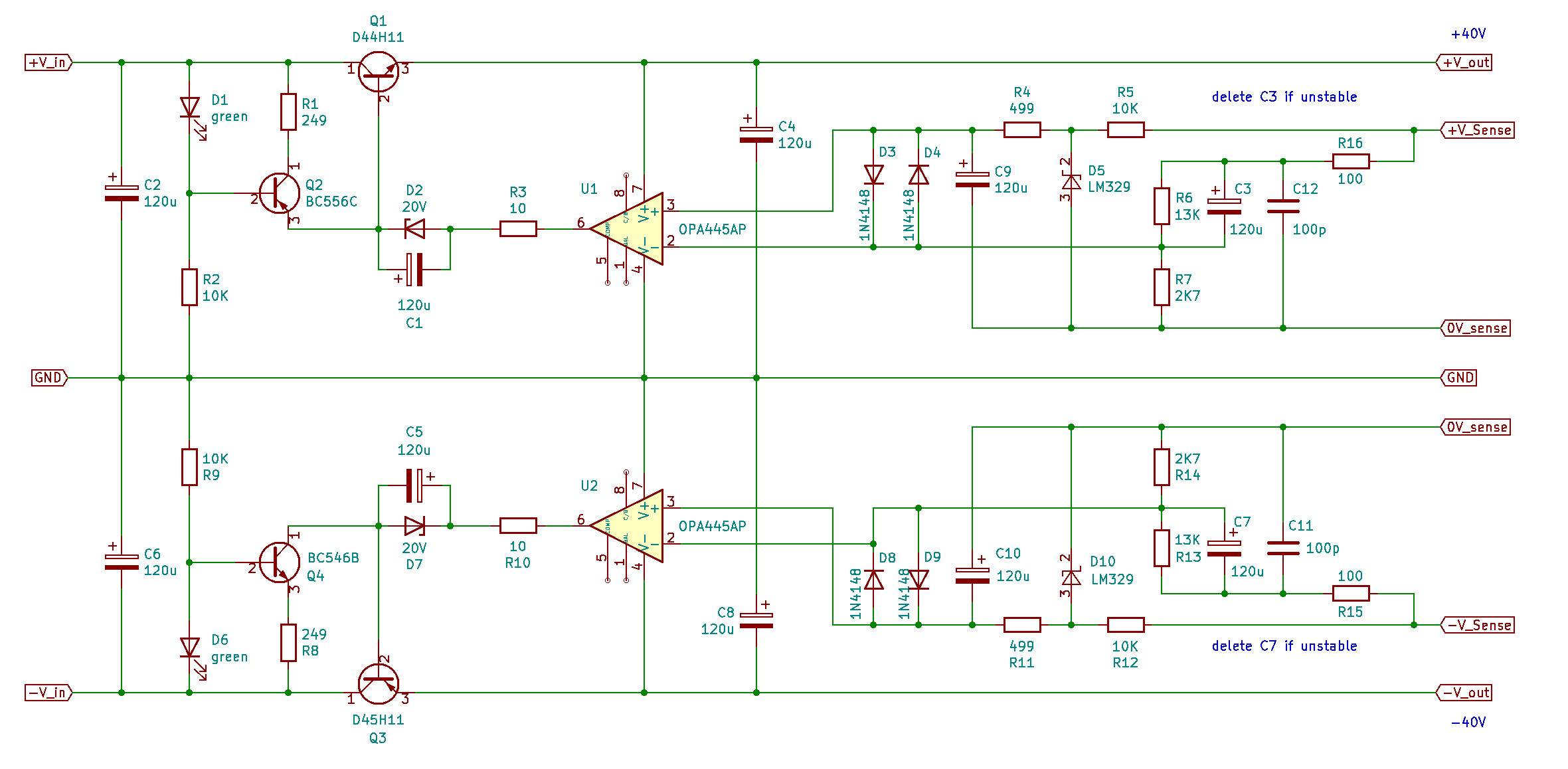

the bias resistor can be increased from 4.99k to 10k.
Of course the feedback resistors have to be recalculated for the new ration of 6.9V to 40V. So the resistor ratio should be 6.9 to (40-6.9)=33.1
2.2k and 10k would give a nominal 38.3V. Or 2.7k and 13k gives nominal 40.1V

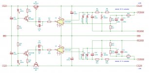

Thanks for all the work done here! I made a 40V output schematic very similar to the one shown in #1466 and tried to include your comments. Please have a brief look at attached screen shot and let me know if I have errors in it. Also is it safe to delete the protection diodes?

Thanks for all the help, @Bill_P was right, it was the opamp. I went ahead and bought replacements for the diodes, and other transistors, just in case, as the major cost is the shipping from DigiKey. All is working well!
