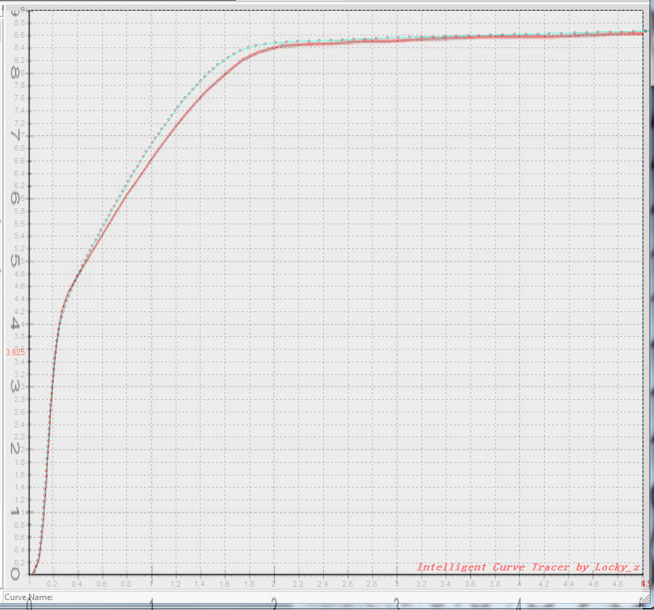

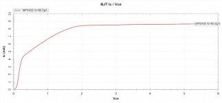

Nice to see that Mark has so many followers.
Looking at the graphs both transistors have circa 18k output impedance at 8 mA collector current.
That’s quite low so it justifies the simple question how it was measured.
And I’m more than willing to counter that measurement, but I can only repeat what I said before: when we don’t use the same setup, results will be incomparable and thus be a waste of time.

I do trust Mark's results and have confirmed them myself.
May I comment that the output impedance in your measurement is way higher than Mark’s.
Hans
I projected both MPSA92 measurements on top of each other after having given them exactly the same scale.
Result are now much better to compare.
Output impedance that seemed much higher in Stormsonic's smaller image now turns out to be the same as in Mark's version.
So now coming from two independent sources, I'm convinced.
I still don't see why a simple question how a measurement was done could create so much fuzz.
Hans

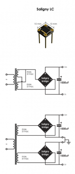

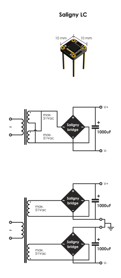

By pre-regulator I was referring to the DC supply that feeds a SuperReg. Would a basic AC To DC Full Wave Bridge Rectifier work best for this?
And will I need a separate DC source for each Positive SuperReg and if so, why? If the DC source provides enough amperage, can it be shared by let's sat 3 positive SuperRegs?
Thanks!
Thanks!
You need a DC source as input. A rectified AC with a reservoir cap will do, as long as the ripple is not so large that it dips below the minimum input to the regulator.
For example, if your regulator output is 24V, the input should not drop below about 26V.
If you have rectified voltage of say 30V, the ripple should not dip below 26V
If the input DC has enough capacity, it can feed multiple regulators.
