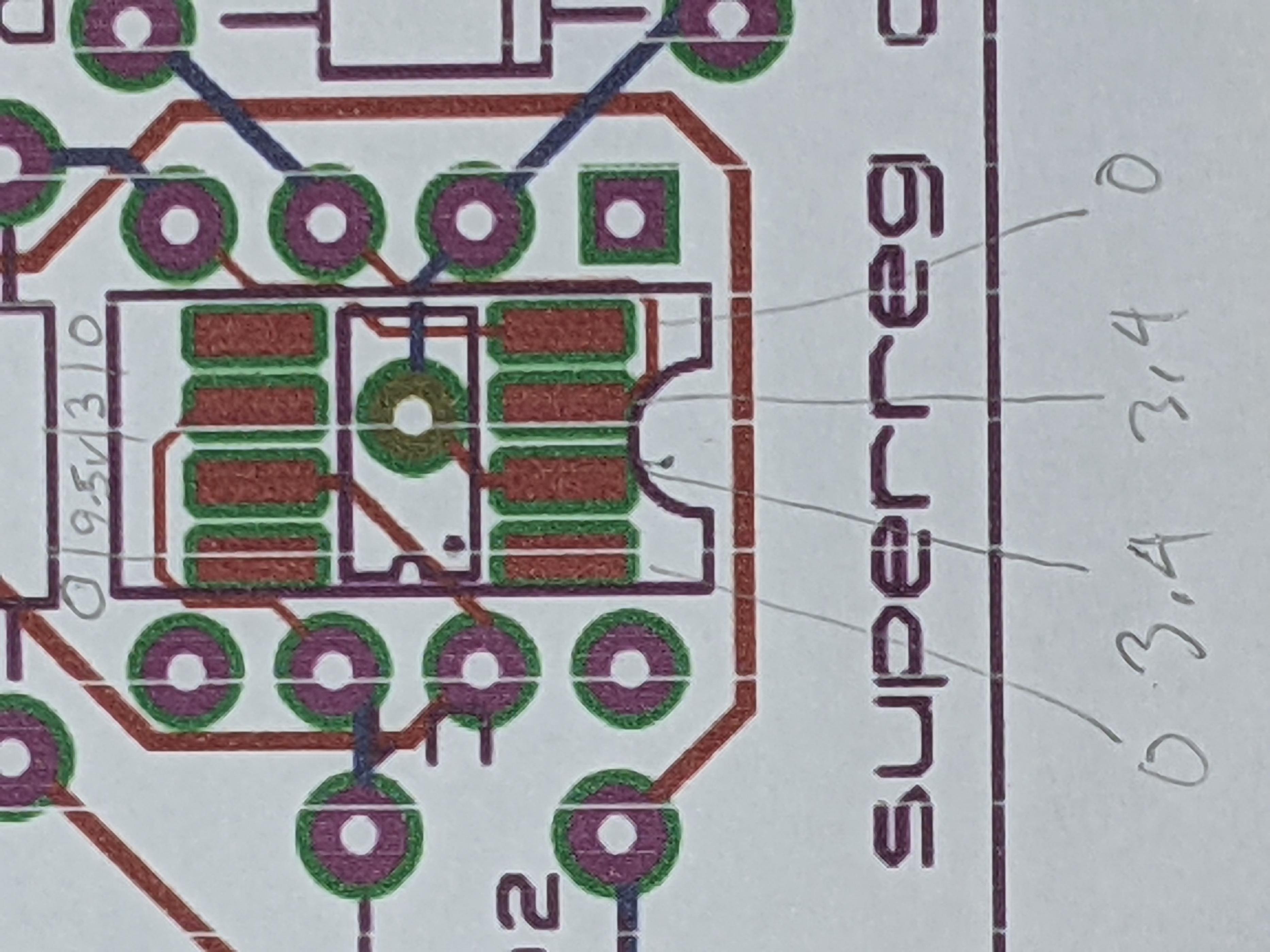

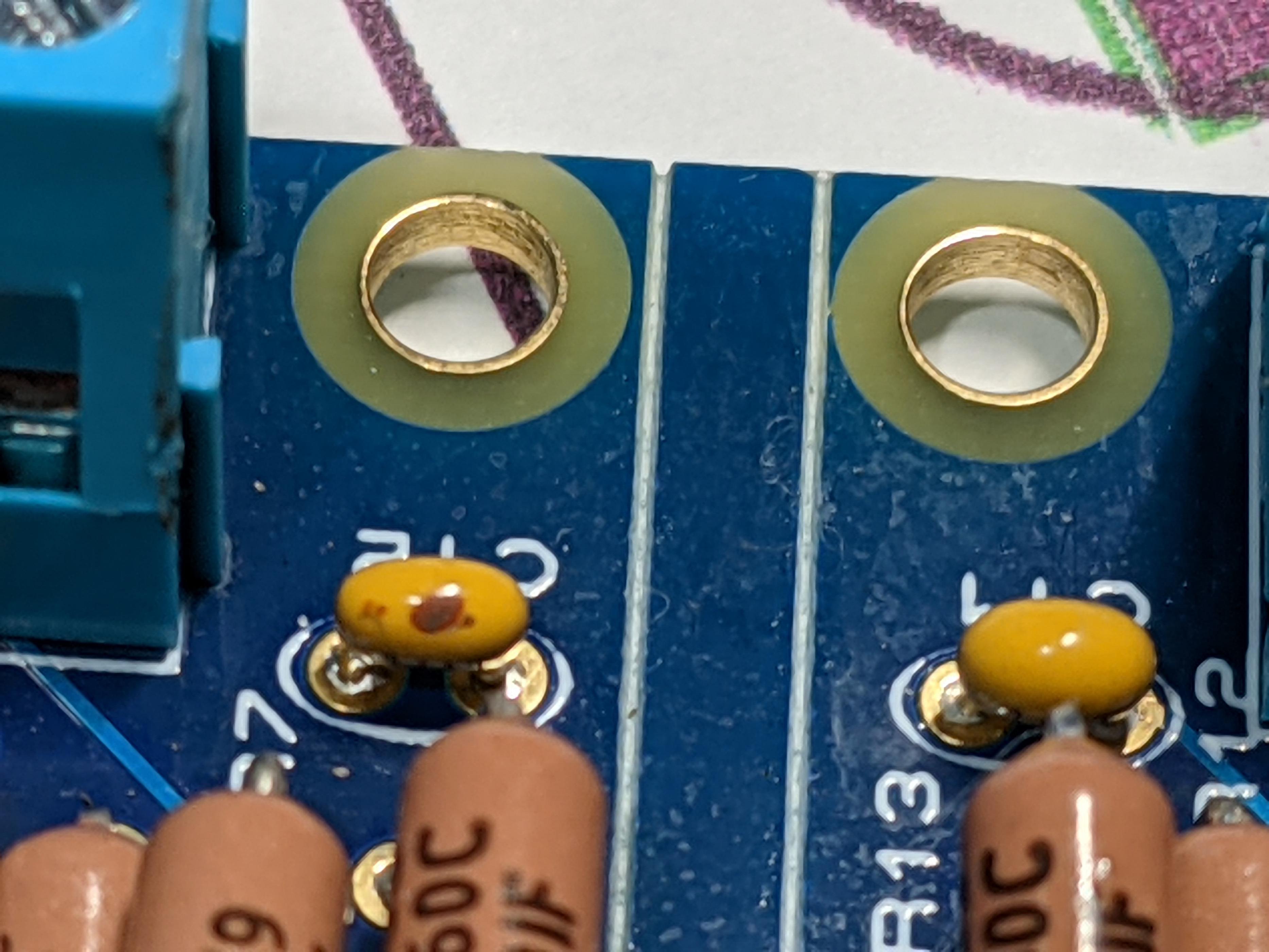

Well, it's built. Goal was to get 18V. I used 1k for R6,13 and 620 for R14 and R7. I got 19V output on both + and -. I'm hoping to use it for Wayne's BA 2018 Preamp, so these values are fine. Linear supply at 24V. Then I accidently shorted the + of my linear supply to ground. SuperReg was not attached at the time. After replacing the damage parts on the Linear supply, I retested. Linear supply again reads 24V on both + and -.
However, while Neg output on the SuperReg is still at 19V, the Pos is at 9.64V
I changed R6 and R7 to both be 1000R and I get 9.86V
I cleaned the board again and reflowed solder on all connections, same result.
For all measurements, the Pos Volt out Sense is shorted to Pos Volt Out, same for the return.
Any suggestions on where to start?
Thanks in advance!

Voltages to ground at each pin of opamp.
So, the opamp works OK, the two inputs are equal.
Check the reference diode on pin 3, as well as the resistor feeding it. That reference should be nominal 6.9V (assuming you used a '329).
