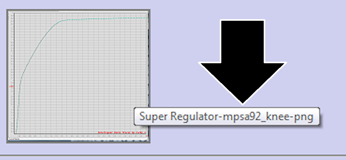

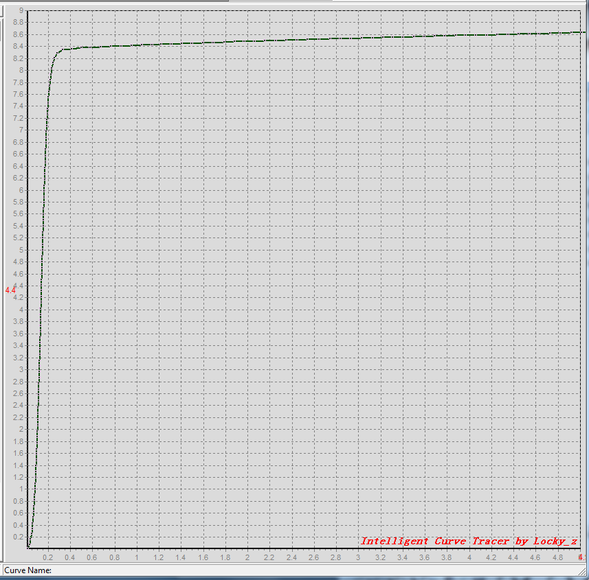

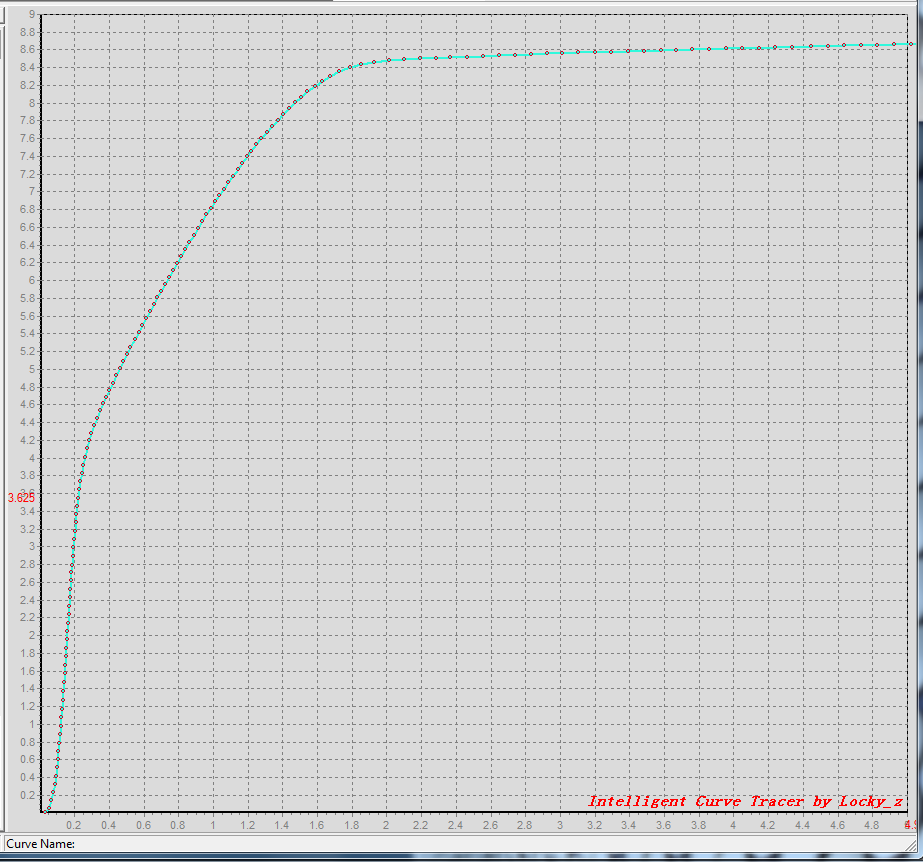

One important characteristic of the current source transistor in the Jung-Didden Super Regulator, is its performance at low VCE. Attached below are two PNP transistors, hover your mouse over the ICE-versus-VCE plot to see the part_number which is embedded in the file name.
One of these transistors makes an excellent current source at low VCE. The other one defecates the bedsheets, I'm afraid.
If in doubt, read the diyAudio thread about keantoken's "K-multiplier" and pay close attention to every paragraph which mentions quasisaturation. Then use the BC transistor types which he recommends. They're not quite as nice as the one attached below, but they cost a lot less money.

Here is what I see on Windows 7
_
I can Hover as much as I like in Windows10 + Edge , but no result. 😀
In fact the MPSA92 is a 200V high voltage transistor, not the first choice for an application like the super regulator, but nevertheless I'm surprised by it's strange low voltage behaviour.
But also keep in mind that the super regulator in it's current form is not a low drop-out regulator and that it is better IMO to stay on the safe side with 2Volt Vce on this current source transistor.

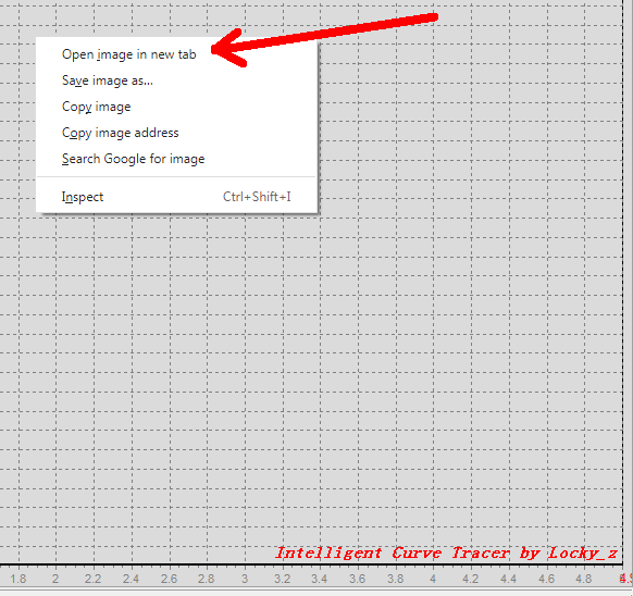

I'm sorry that your OS+Browser won't display the filename upon hover. The most obvious workaround is to simply open the I-versus-V image in its own browser tab or browser window, and then read the filename from the navigation bar of that window. See figure 1 and figure 2 below.
When you check the datasheet, you'll discover that the MPSA92 is actually a 300 volt transistor. In order to make a fair comparison, I chose the other ("good at low VCE") transistor in the plots, to be a four hundred volt device. Now readers can see that it's wrong to assume all high voltage transistors are terrible at low VCE.

Mark,
Did you make these measurements and if so in what setup.
More than those mediocre low voltage properties I’m interested why there is still a significant slope beyond 2Volt Vce, indicating a rather small value for the early voltage Va in the order of ca.150 Volt, not a thing that I would expect for a low power high voltage transistor.
Hans
Hans, send me your mailing address via PM and I'll ship you 3 pieces of each device type. Then you'll have complete control over the entire testing protocol + environment, and can employ whichever equipment gives you the greatest confidence of correct results.
