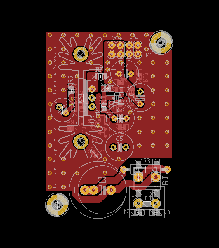

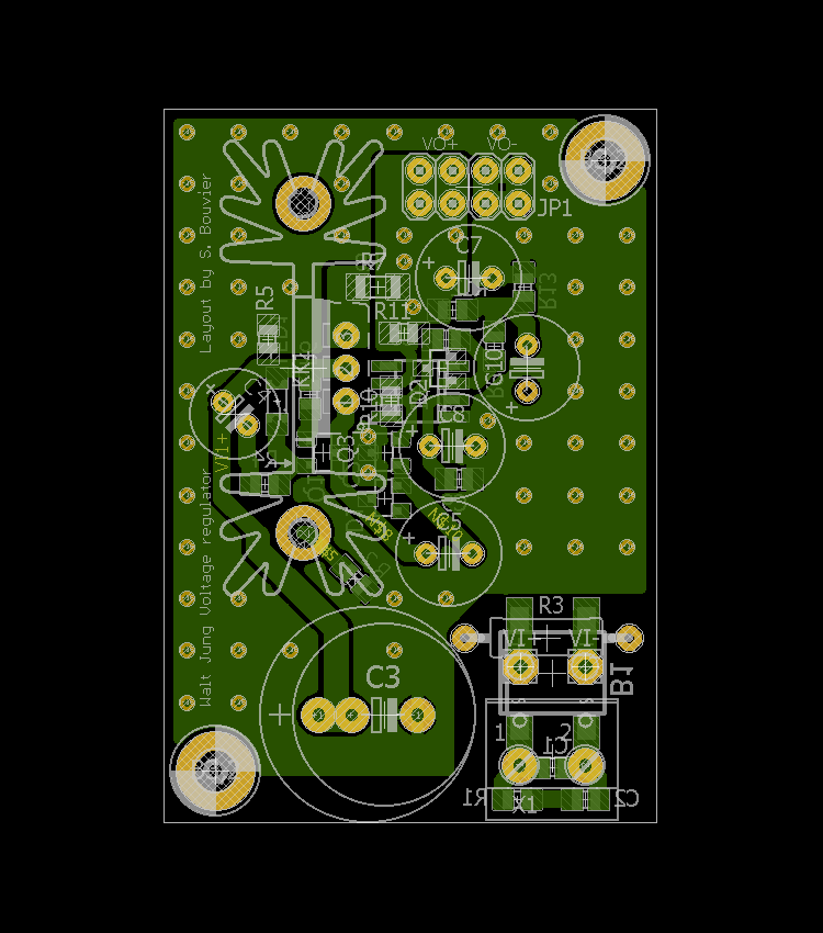

That is a very nice comparison, thanks for that!
Clearly the 825 is not the best choice based on this data, although I must admit I have almost exclusively used it because it always works as expected, never have seen any instability or other issue.
So, what would be your own preference now? Have you tested any in hardware?
Jan
Thanks Jan,
Unfortunately no hardware testing yet, but it will come hopefully.
A lot of simulations though, and a PCB ready to be populated (for personal use, see attached). I went with my own design to be able to experiment with more modern components (like the zener reference), adding the possibility to add components for stability or higher current, and use of smd with very compact layout to allow good performance and close placement to the load. Maybe it will be a success, maybe it will fail dramatically 🙂
Coming back to the opamp:
On paper, obviously the ths4031 looks great, especially at HF.
The opa1611 is a very good compromise in terms of low noise, high OLG, good phase margin, and price (and field proven now!). Stellar performance in sims as expected.
lm4562 (i.e. lme49710 duals) is decent but not great phase margin.
ADA4851 looks very good if you don't mind the higher noise.
For a reasonable application to audio with duals rails, I like a lot the new opa2210. Very similar to the older opa209, which was almost perfect except a high susceptibility to RF, which I think was fixed in this new version.
