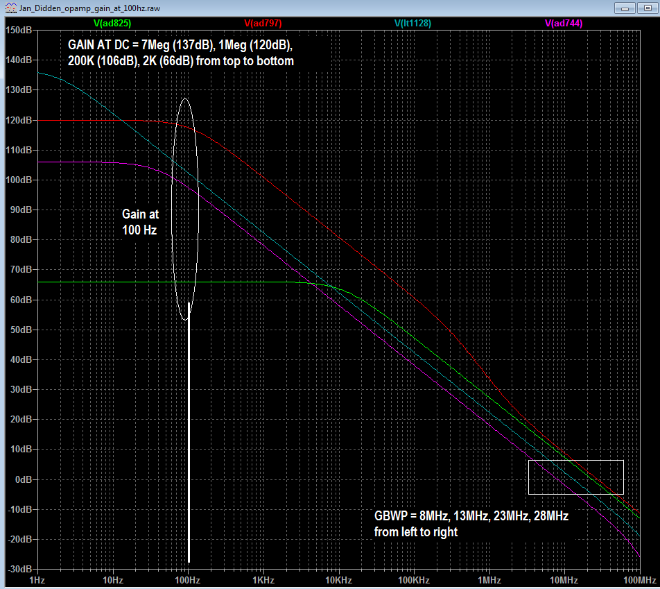

Mark, I'm not looking for a fight, but when I look at the AD825 I see a GBW of 25MHz. The AD797 is 110MHz, much higher, but the AD744 (also a Scott Wurcer creation IIRC) is 'only' 13MHz, similar to the LT1128.
Am I looking at the wrong numbers?
Jan
Jan
Here are the open loop gain curves, transcribed by me from the manufacturer's datasheets, to the best of my abilities. AD825 is significantly lower at 100 Hz.
It's a big plot; click on the thumbnail and then click on the white "X" at lower left, to see it full size and undistorted.
_
_
Ahh yes, in the end similar unity gain bandwidth, but indeed the AD825 starts out low.
Reminds me of the discussion that flat OL bandwidth in an (op)amp is a Good Thing. I never agreed to that, and this confirms it.
They all have similar gain at 20kHz, so in an audio application, similar feedback factor at 20kHz, so similar distortion suppression at 20 kHz.
But except for the AD825, they have increasing distortion reduction with lower frequencies. The distortion reduction by the AD825 at 1kHz is the same as at 20kHz, but the others have several 100 times more distortion reduction (or ripple suppression) at 100Hz, although their OL roll-off starts much earlier than the AD825.

What is the regulator Zout when using the AD825? It looks like it might be invariant across the audio band. Does this affect the sound of an audio circuit powered by the regulator?
Well, it may be flat, but the others make it go even lower with decreasing frequency. So at 100Hz where the main ripple is, the others have more ripple reduction than the '825. Mark is absolutely right there.
There is no inherent advantage in being flat. Unless it is the amps freq. response ;-) .

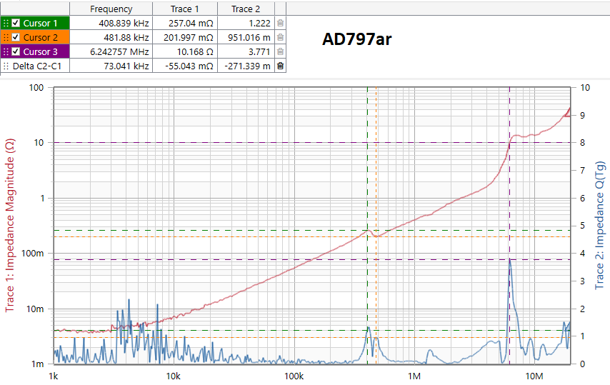

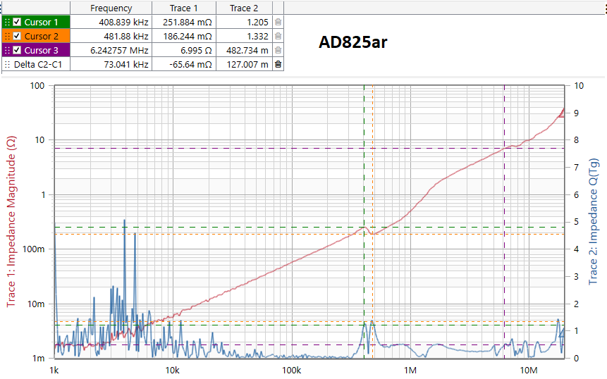

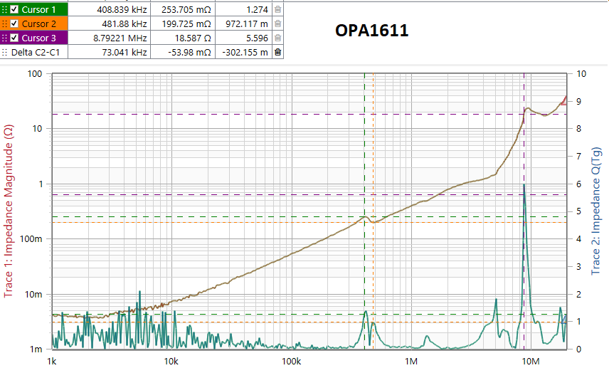

Here are some charts using the Bode-100 VNA and J2111A current injector -- a different setup from that used in the LA article (Bode-100 makes life easier). The OPA1611 would appear worse than the AD797 with regard to stability. The AD825 is no problem.
Q is derived from tg.
Thanks Jack for your excellent measurements. I noticed that both AD797 and OPA1611 have much slower slew rate (and therefore much longer settling time) than the AD817 (BJT) and AD825 (JFET) opamps, which have proved stable for Super Regulator. I wonder if that characteristic is the important factor in choosing OpAmp for SR.
I think among newer OpAmp, OPA828 is probably a better choice with slew rate is around the same as AD825, settling time is slower (120ns) but not too much. Noise both voltage noise and current noise is better than AD817 and AD825.
I don't see slew rate figure in this, as the opamp output moves only a small fraction of a volt.

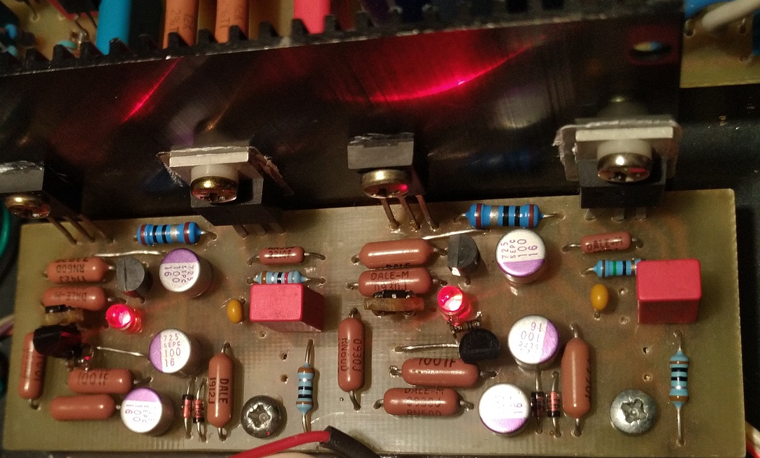

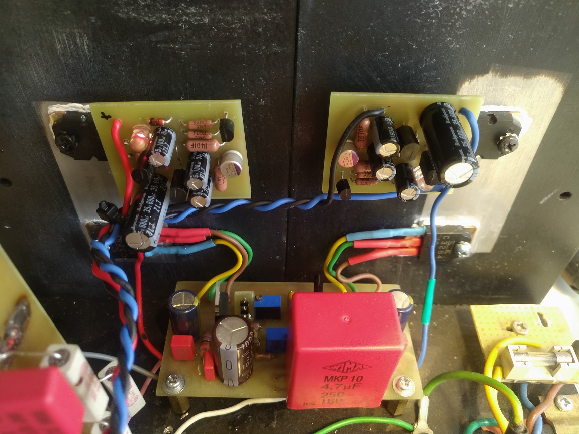

superreg no light led NEG side
Good morning to you.
I am Giampiero from Rome (Italy), I would need a little help as I am quite inexperienced on the subject.
I have completed the construction of the Superreg from DiyAudio (!) But during the connections I must have done something (some trouble ..) or everything works, I can listen to music correctly with the BA-3 to which it is connected but on the "NEG" side the LED does not light up while on the "POS" side it is on.
what should i check? what have I done?
thank you so much
(sorry my bad english)
