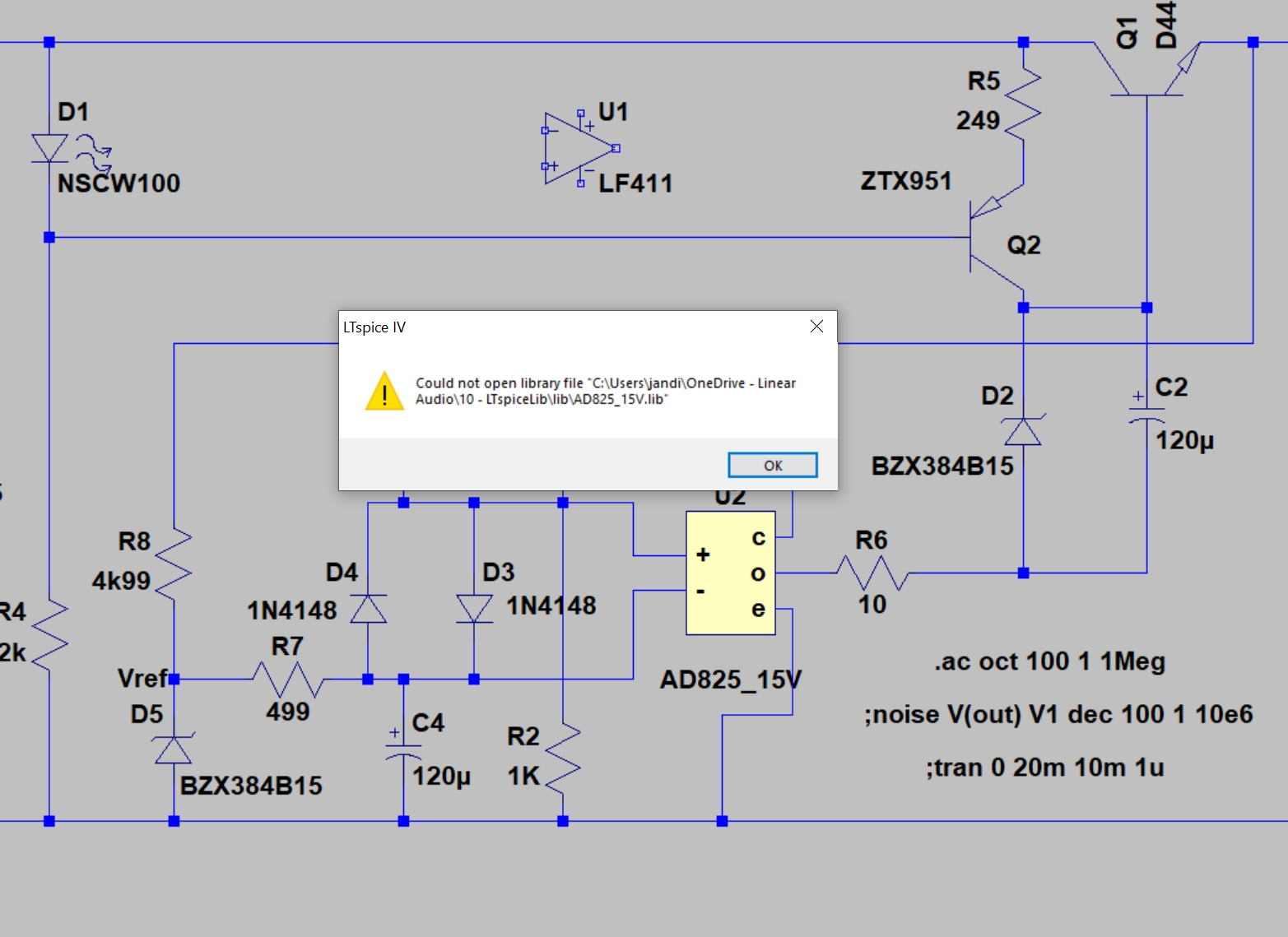

Did you get that AD825 going?
Jan
If you don't want to wait:
From LTspice, open the symbol AD844A.asy (check the name I don't remember exact);
Then click Edit|Attributes|Edit attributes from the top of the screen;
In the window that opens you see an entry for Modfile where the path to the .cir is shown. That is a path on my PC ... Replace that with the path to where you have stored the .cir on your PC, click OK and then File|Save.
That's all.
Jan
The issue is the base current for the pass device. In the min output current, all the available base current from the current source has to be absorbed by the opamp.
For the AD825 that max is about 50mA but for good operation it should be limited to half that, say 25mA. So the current source can be set to max 25mA, and that means a 1A output current with an Hfe of 40 of the pass device.
The D44H11 has a min Hfe of 60, so that 1A should be no problem, but not much higher. Assuming proper heatsinking of course.
