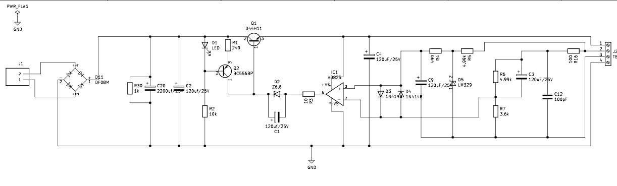

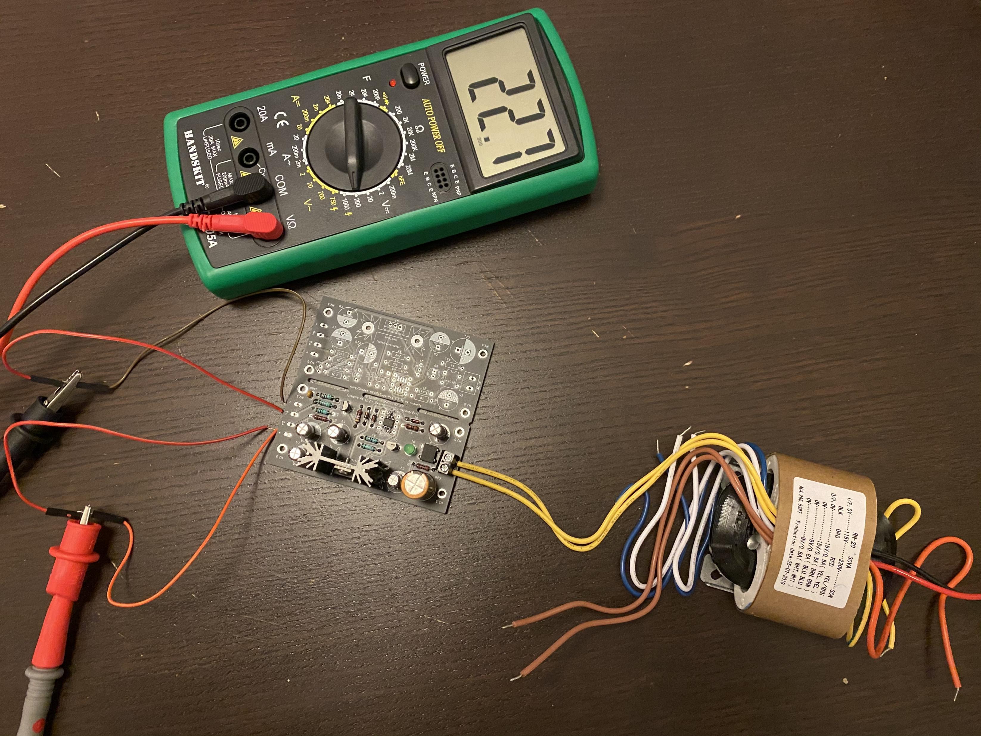

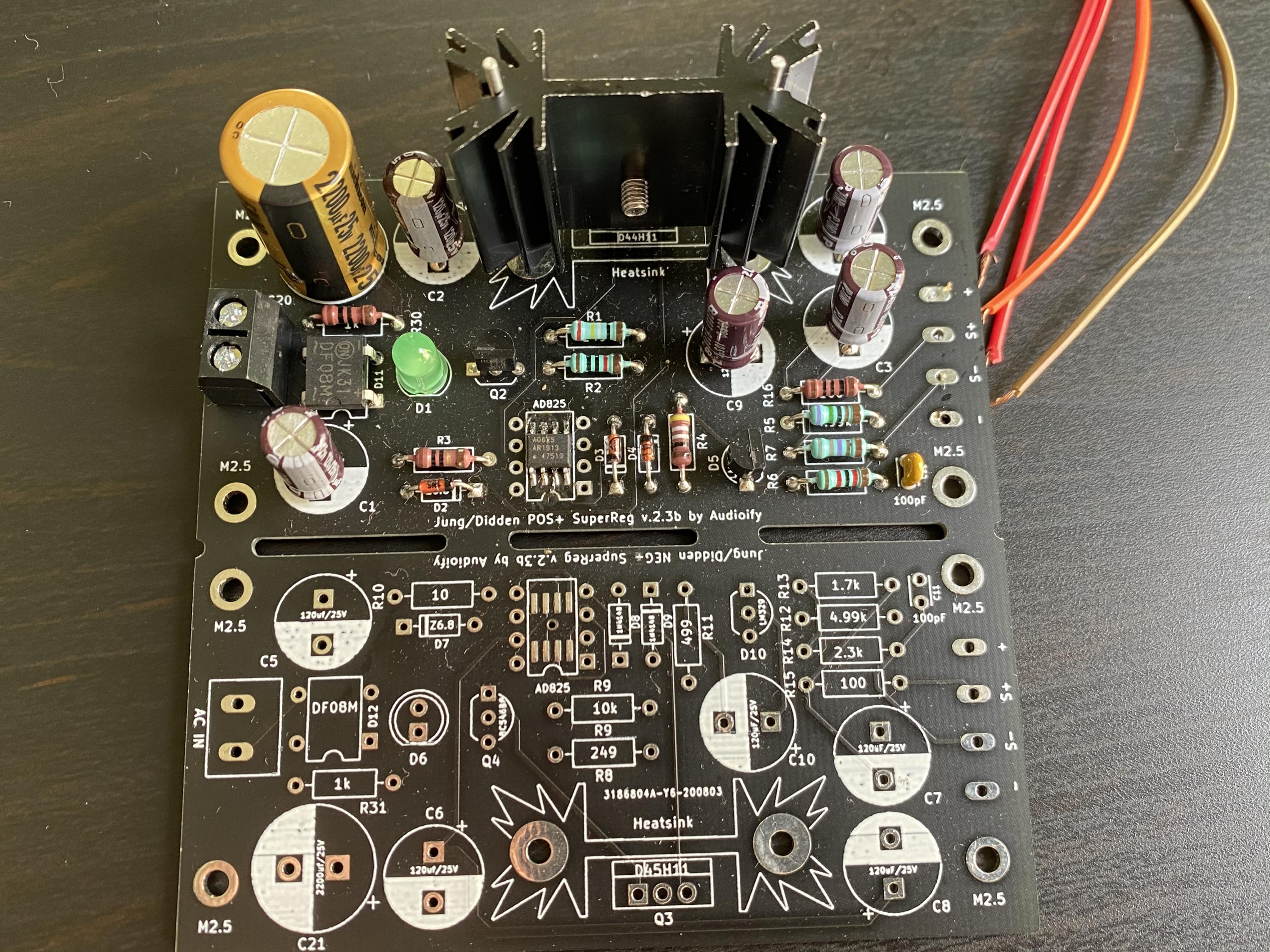

Hi again,
I put together my board... and it doesn't work :-(
Output voltage is 22.7 instead of 12v.
To learn the process for make a pcb, I design my own board on your schematic (attached).
I only added the diodes bridge stage.
My transformer give me an output of around 19v.
These are the value of my resistors (target 12v output):
R6 = 12k
R7 = 8.87k
Could you suggest me a troubleshooting steps to try to fix the problem?
ps: I know, I have to change the capacitors and the heatsink... are provisionals...
Thank you very much.

So the transformer does not provide 19V, but much more. Keep that in mind.
First check is to verify that the sense lines are connected, both output and ground.
Your clips on those wires seem flaky, you never know if the contacts are good. Make that reliable first.
If it then still does not work, verify the voltages on the opamp input pins.
What are they, and if there is a difference, is that difference consistent with the opamp output voltage?
In other words, if +in is larger than -in, is the output positive, and vice versa?
Jan

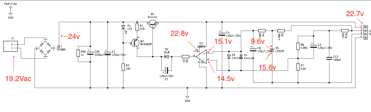

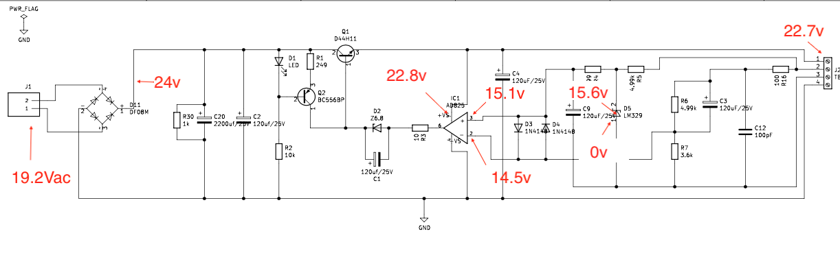

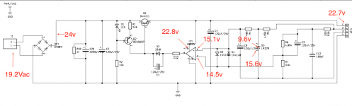

senses lines are connected.
Please look the image attached, I write on top all the voltages that I have tested.
R6 = 12k
R7 = 8.87k
Thanks for your help.
If the resistor values are what you built I would expect to see the LM329 voltage at the + input of the op amp (about 6V9 as I remember) and the close to the same voltage on the - input. For that to happen the output needs to be about 2.4 times that determined by the ratio of the 3K6 resistor and the 4K99 plus 100R, which is about 16V7.
