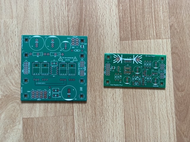

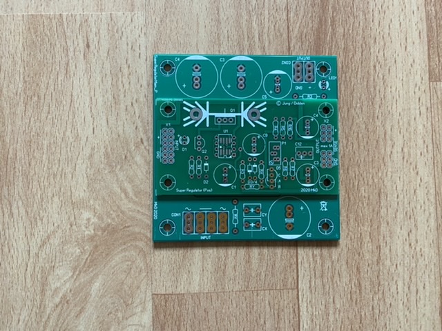

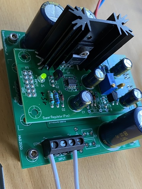

Build my own boards with a Mother Board and Active Rectifier.
Thanks for the circuit!
