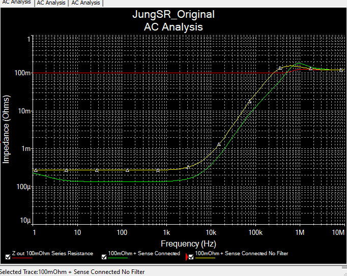

Also I think I read earlier the sense line RC filter to is to ensure stability with long sense lines but is reducing bandwidth of the reg, with the sense line not in use could I possibly remove the filter and increase the bandwidth?
Assume for a moment that you have 100 milliOhms of "resistance" in between the SR and the DUT. If you don't use the Sense terminals you've taken a high performance engine and turned it into a two-banger. This illustration was done using the AD825 error amplifier. With the AD797 Z out will be a couple microOhms! (But "simulated" phase margin @1.3MHz is inadequate with the AD797).
