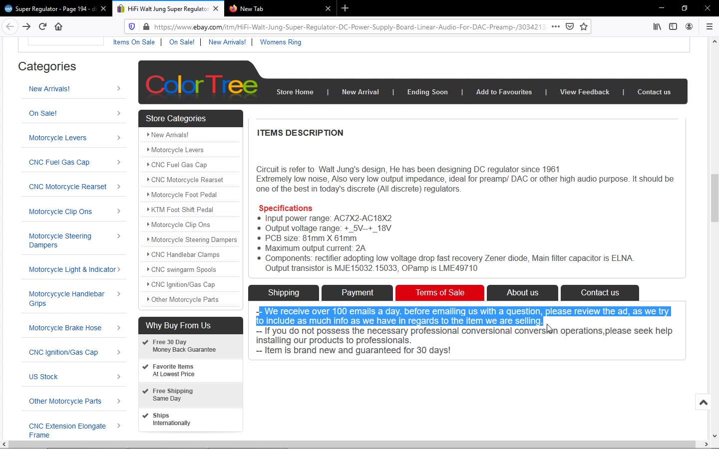

I did ask for a schematic, to see if it was really a Jung regulator, but I got no answer.
That's the most normal thing on EBAY.. there is very few who actually will answer your Question.. Still it doesn't mean that this seller is a bad guy..
It's a big Minus of EBAY Administration that they do not tell the Sellers to answer questions as a MUST, for selling their Stuff on Ebay..
It's based on Jung.. Take a look at the screenshot, it's based on Jung not JUNG..

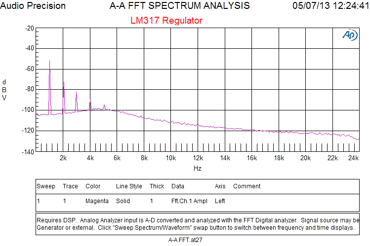

The real beauty of the SR is that the error amplifier puts so little of its signature back onto the supply rails. With an LM317 you can run an FFT and see that its sluggish error amplifier puts harmonics onto the supply rails. I didn't discover it, was reported to Jan by an observer from France:
