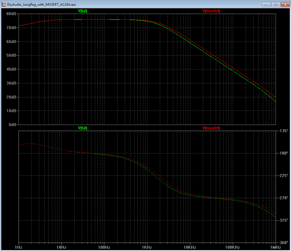

Great work, Jack! However I think it would be even better to use a newer MOSFET which incorporates the higher effective mobility and lower effective channel length improvements that the past 20 years of technology progress have produced. Maybe something like the IRF2805L (datasheet). I'm suggesting this particular MOSFET because its SPICE .MODEL is pre-supplied with LTSPICE.Here's a simulation bode plot of the SR with the MJD44H11 pass transistor and an IRFP240 mosfet pass device, AD825AR error amplifier:
When I simulate the Jung/Didden SuperRegulator with D44H11 BJT pass transistor (green trace) and again with the IRF2805S MOSFET pass transistor, I find that the MOSFET regulator's performance is slightly better than the BJTs. Results attached.

I seem to get results that look like Mark's.

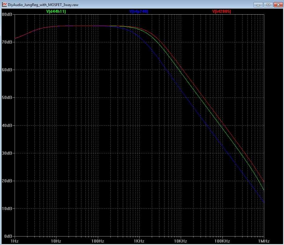

D'oh! Why not put all three on the same graph? So here they are.
- Green trace = BJT (D44H11)
- Blue trace = old MOSFET (IRFP240) that Jack simulated
- Red trace = new MOSFET (IRF2805L) that I recommend
Magnitude plot only, sorry. For phase, perform eyeball extrapolation on graphs in previous post.
That's quite interesting Mark! Wish I knew how good the various models really are. Maybe there's no way around actually measuring one.
