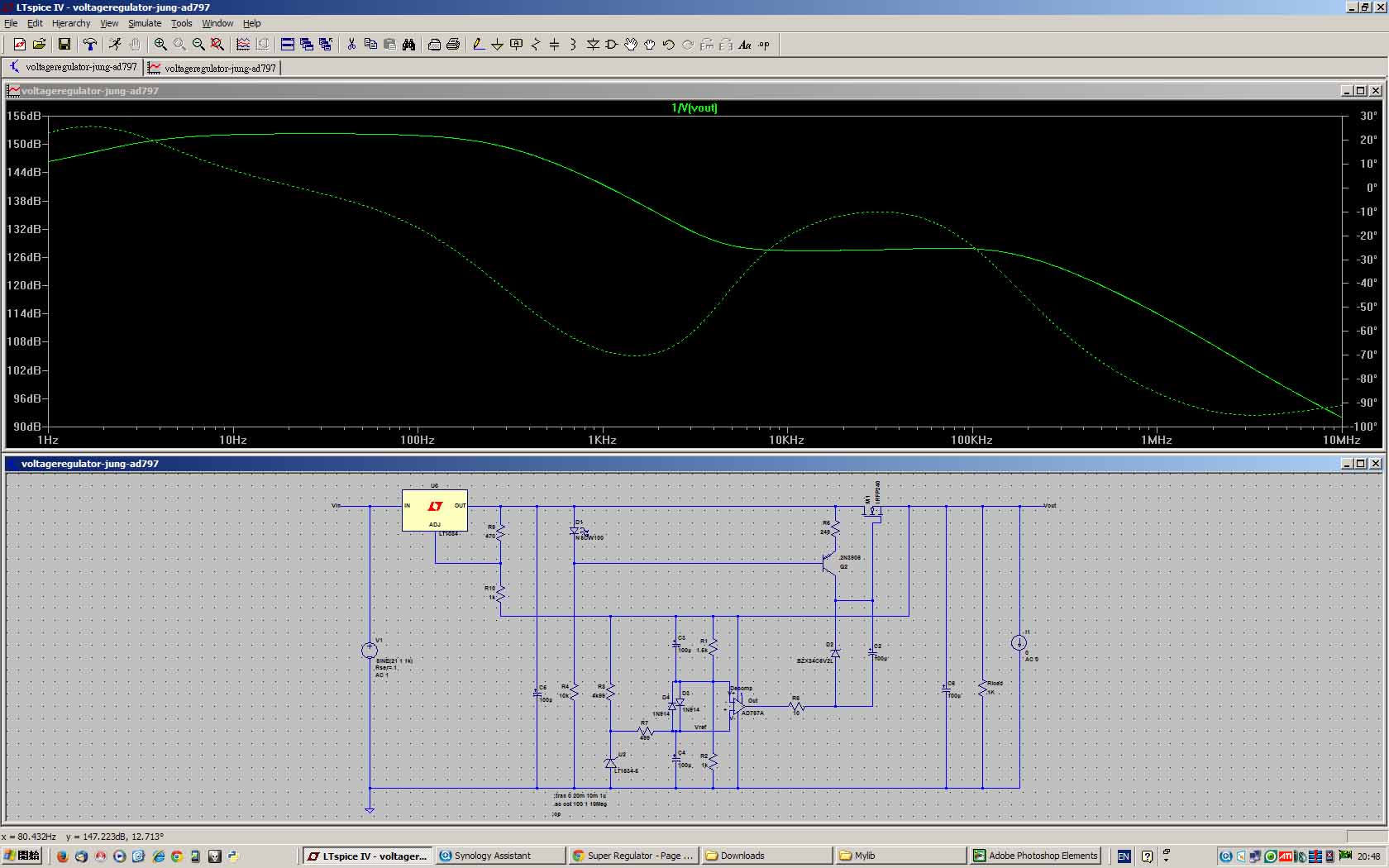

The Jung/Didden Super Regulator is a sophisticated, high performance, marginally stable circuit that is prone to oscillation, even when constructed by expert designers who have lots of experience. I recommend that you DON'T try to modify it unless you really know what you're doing.
If you can duplicate jackinnj's simulated Bode plot of the unmodified Super Regulator (in post#177), then you might have a chance of succeeding. If not, I recommend you don't attempt to modify the SR. It won't work and you'll be unhappy.
http://www.diyaudio.com/forums/blog...level-audio-part-vi-jung-super-regulator.html
Some of the resistors values in the above link are different from Jung SR 2000.
I have changed the resistor values according to SR 2000 version.
Other changes are :
replacing LT1086 by LT1084 (max current 4A);
R1 changed to 1.5k to get 12V output;
AD797 is used;
IRFP240 is used (for comparison with jack's result).
For ac analysis, instead of plotting Vout, 1/Vout is plotting so that the dB in the vertical axs is +ve.
The schematic used for simulation is attached for verifivation.

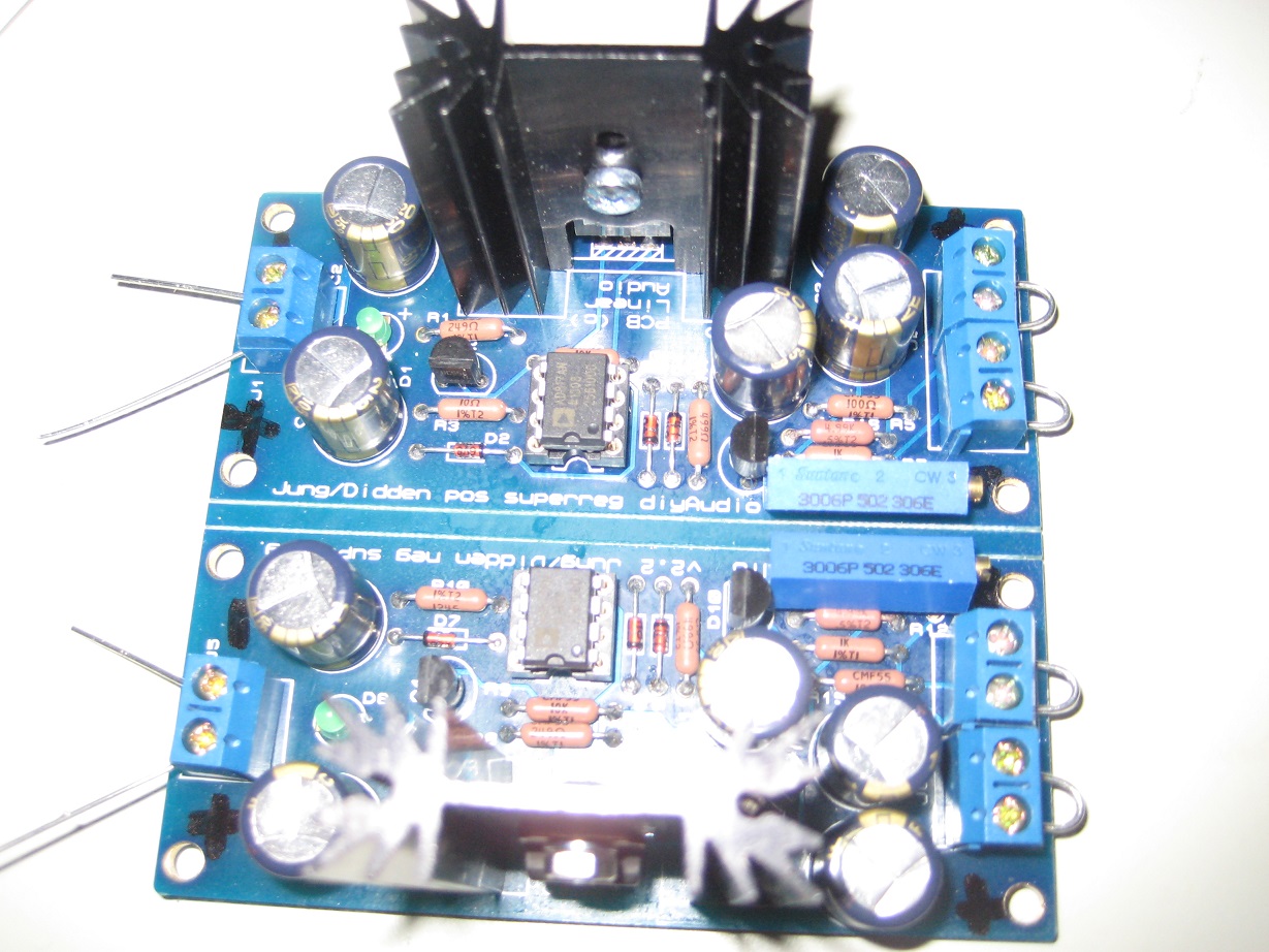

Finished my board..... is there a build thread😀
Some pics:
Tested them and regulation is real good, I can modify the input between 28 and 40 volts and the output stays exactly 24.00V. Also when loaded with a 220Ohm resistor, so around 100mA, output still is 24.00V.
I modified the V2.2 boards with a 5K trimpot at the R6 and R13 position. ( if you don't place the ceramic cap you have exactly a third hole for the trimpot ) The cer cap can then be placed at the bottom.
I intend to use these superregs for my BA-3 as a preamp which need + and - 24Volt.
I used a AD817 from Mouser.
Now have to complete the build and listen to it 😀
Thanks Jan!

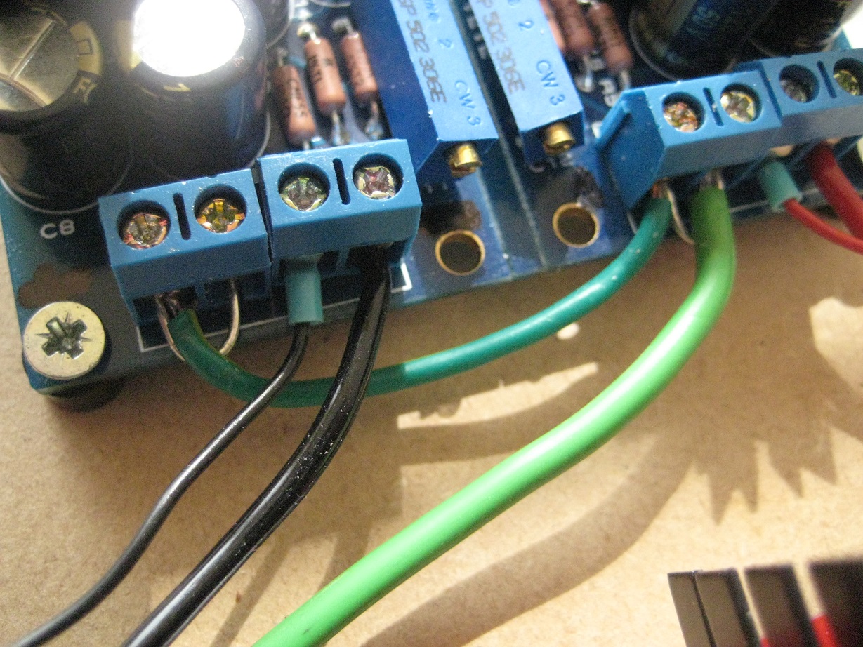

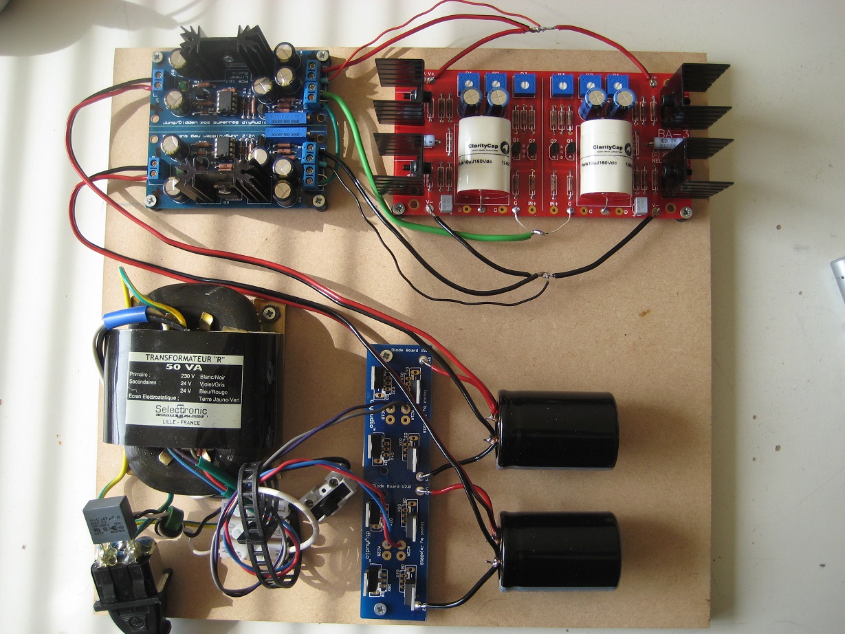

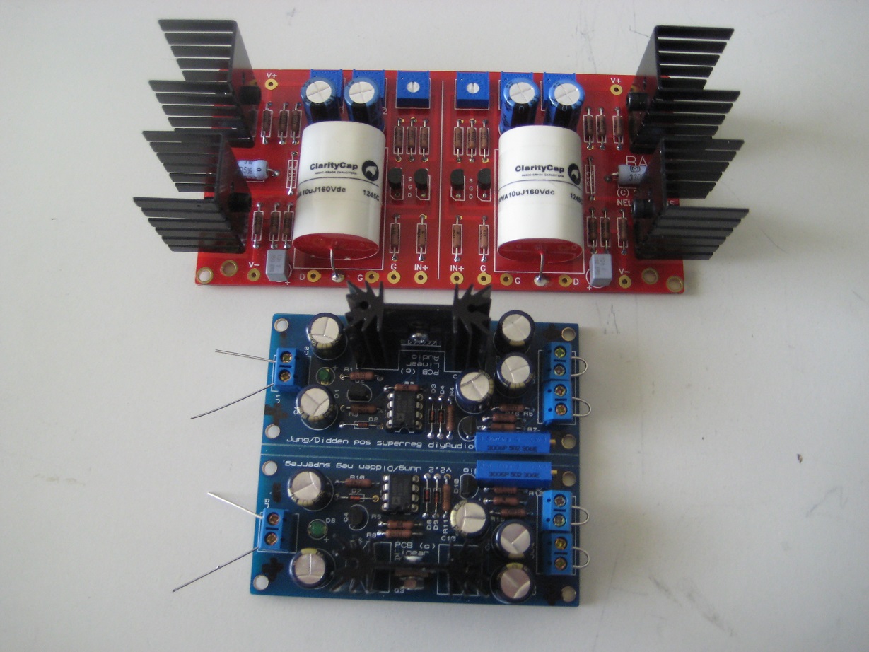

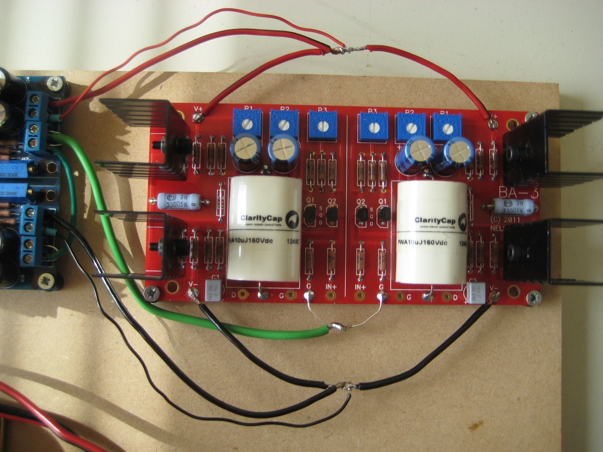

Some more pictures and questions....🙂
Is this a right implementation of the sense wires? I sense just the V+ and V-
As you can see I had to couple the positive and negative regulator at the end of the PCB to create a common PSU ground to the BA3 board. Green wires. I included the sense in this common PSU ground.
Is there an other (better) way to do it?
I consider building another set of superregs so I can feed every rail of the BA3 board separately. 4 rails, 4 superregs. Will this enhance performance or at least channel separation?
Walter
The only suggestion I have is to duplicate the green wire from the neg reg to the board, to the same point where the existing green wire goes.
Also then run the ground sense wires from each reg (which you now have jumped in the terminal blocks) to this same point, as you have done with the 'hot' sense wires.
The next step would be, as you say, to get another pair of regs. 😉
