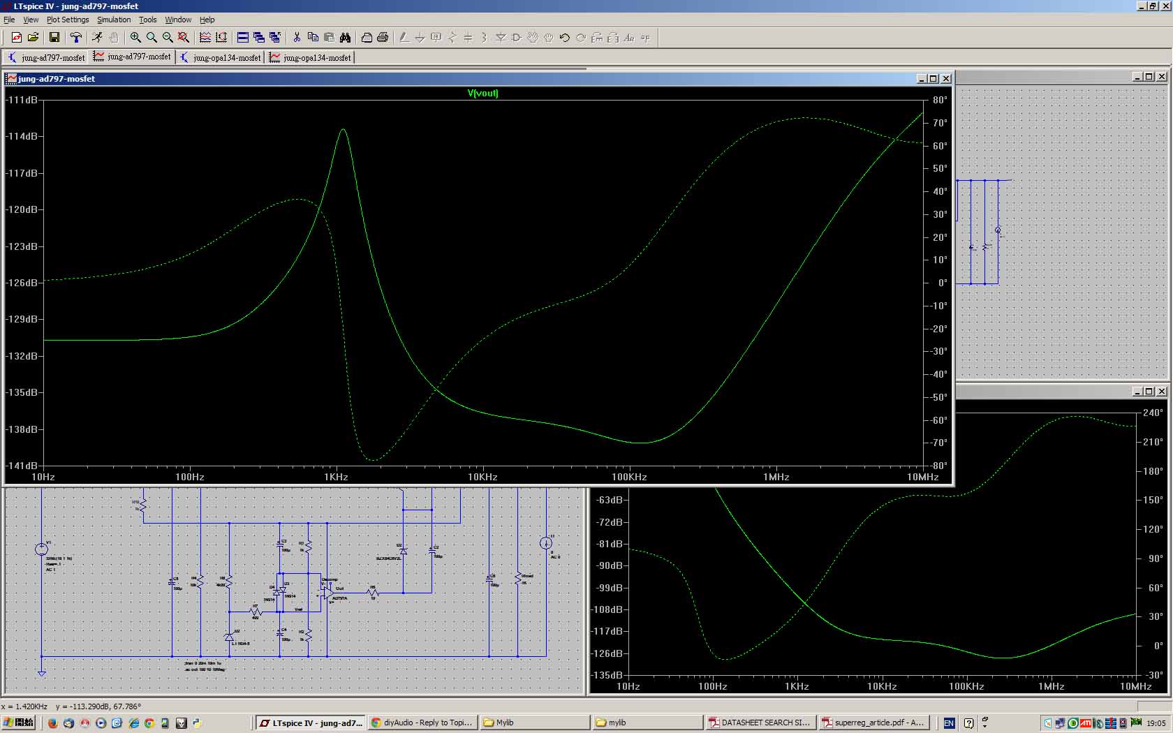

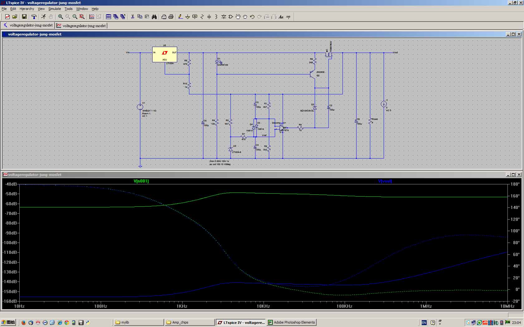

Just plug AD797-15V model from AD into the asc.
Need to made an update to the MOSFETs model in LTSpice.
Sorry for posting a wrong plot.
I re-ran the simulation (some resistor values in RJM's blog are different from Jung's 2000 article). I plugged the values show in the article into the schematic. It seems that there is something wrong around 1~2kHz if AD797 is used. For some MOSFETs, simulation cannot be run with AD797.
If replaced by OPA134, the plot looks more stable but the performance at low frequency is ...
The 797 is a somewhat different opamp from 'the others'. For one thing, it has an internal neutralisation loop based, iirc, on positive feedback. I don't know how accurate this is reflected in the spice model.
I do remember that the 797 was harder to stabilise in a practical superreg and both Walt and I eventually recommended other opamps for the design.
