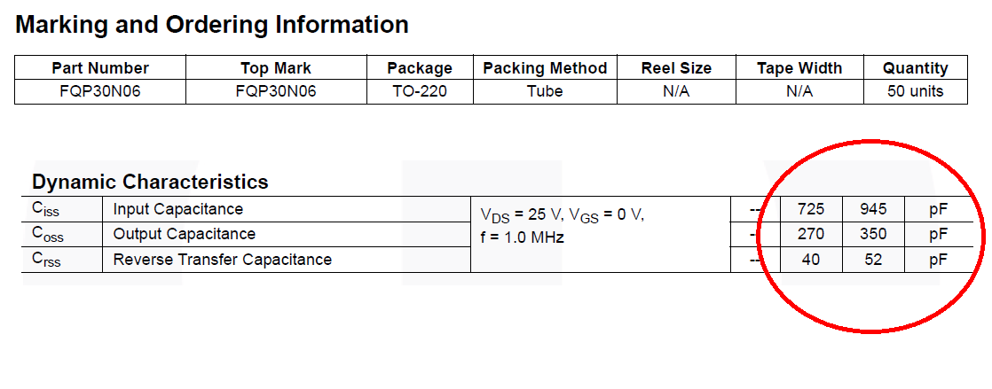

Let's do a comparison of the D44H11 BJT at 50mA, and the Fairchild FQP30N06 MOSFET (datasheet) also at 50mA.

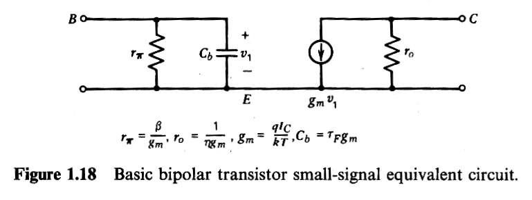

The Hybrid Pi model of a BJT is attached (Gray and Meyer, p.36). To calculate its base-emitter capacitance we need the base forward transit time tauF and the transconductance gm.
tauF is just another way of expressing the transistor speed: (tauF x 2 x pi x fT) = 1. Since we know the fT of the D44H11 is 75 MHz, that lets us calculate tauF = 2.12 nanoseconds.
Transconductance gm is simply (Ic / (kT/q)). At room temperature, (kT/q) = 26 millivolts. At Ic = 50 milliamps, gm = 1.92 siemens.
The base-emitter capacitance of the D44H11 at 50mA is thus (tauF x gm) = 4077 picofarads. Pound it out on your calculator if you don't believe me: More than four thousand picofarads. And it increases linearly with collector current.
The gate-to-source capacitance of the FQP30N06 is 945 pF (see datasheet excerpt below), and the gate-to-drain capacitance is 350 pF. Add them together and you find that the total capacitance at the gate is 1295 picofarads. That's 3.1X lower than the base capacitance of the BJT. Remember that both devices are operated as followers, so there is no Miller-effect multiplication of capacitance in either of these circuits.
Thus we see that in some cases, SuperRegulator pass transistor capacitance is significantly lower for MOSFET than for BJT. Contrary to the conventional wisdom.

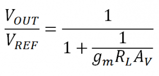

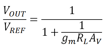

Jan, I suspect you're speaking about the transconductance gm of the series pass transistor. Work out the transfer function of a voltage regulator consisting of a pass transistor with transconductance "gm", driving a load resistor "RL", with an error amplifier whose (finite) open loop voltage gain is "Av". From the voltage reference input to the regulator output, the transfer function is
Please note that pass transistor transconductance gm is multiplied by open loop gain Av.
BJT transconductance is higher than MOSFET transconductance; it's true. But the ratio is less than ten to one.
Opamp open loop gain Av varies much more than ten to one; for the AD825 (76dB) versus the AD797 (146dB), the ratio is 3000 to 1. Yet the impact upon measured low-frequency Zout in Jack Walton's curves, is only 10 to 1 (see attachment). Conclusion: as long as (gm x Av) is big enough, you'll get world class performance. Want to use a MOSFET pass transistor? It'll be wonderful; just make sure to pick an opamp whose open loop gain Av is greater than 80 dB.
