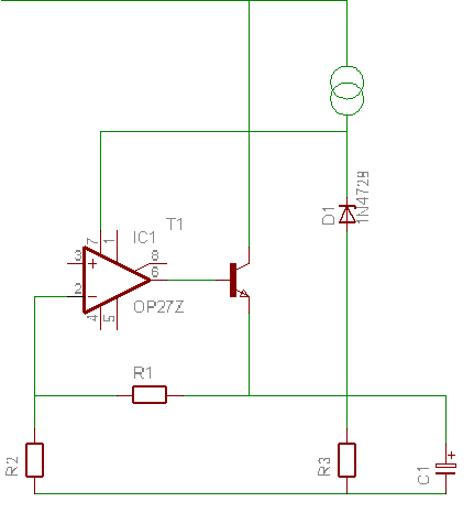

I would like to suggest an alternative method that avoids the level shifter (at least inside the feedback loop). I would welcome your comments on the approach shown in the attachment (apologies I have not yet learned how to insert an image into a post). R3 is probably is not required because the values of R1 and R2 can be adjusted to sink the correct current.
Having one less transistor in the f/b loop may help with stability and transient response. Also the finite current source impedance will affect only the supply to the opamp rather than a hgih impedance point within the feedback loop.
  • jungreg.zip
Same as above.

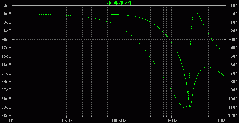

I was reading with interest the discussion regarding the current source, and making its value less sensitive to supply voltage. I'm looking at a SPICE simulation of the 90 Volt version posted here: http://www.diyaudio.com/forums/showthread.php?postid=256528#post256528 I tried several things. I removed the LED biasing resistor and replaced it with an ideal current source. Then I removed the LED and its biasing resistor completely, replacing the LED with an ideal voltage source. I looked at the voltage transfer function from the unregulated input to the output, that is, the small signal AC line rejection, from 10 Hz to 10 MHz. The result? Absolutely no change whatsoever. Kind of like the old Twighlight Zone episode where the doctor shouts "No change!!!" (sorry, you had to have seen it).
On a slightly different subject, there's been some discussion of the load capacitor and its effect on stability. For the 90 Volt reg, I decided to post a plot of the simulated voltage transfer function from the base of the PNP emitter follower connected to the op-amp output to the output of the regulator itself. As I mentioned before, the load capacitor is 100 uF with a series inductance of 30 nH and a series resistance of 0.25 Ohms. This gives a series resonant frequency of about 93 kHz. Note also that the ESR of the cap is of the same order of magnitude as the open-loop output impedance of the pass element. You can clearly see that the cap interacting with the pass transistor gives the circuit the behavior of a very low-Q notch filter, but with high-end rolloff. That filter has phase lead above the 93 kHz center frequency, which helps the stability situation somewhat. The solid curve is the magnitude and the dotted curve is the phase. For this circuit, you don't want the unity loop gain frequency to be much above 3 MHz or so.

I have two remarks on this very interesting post, if I may.
Firstly, the fact that you can find no difference in the line rejection when changing the input cs configuration. I find that VERY strange. I would accept something counter-intuitive, because such often are the ways of mother Nature, but no change? Really?
On the transfer function curves, I note that the dip of the magnitude is just 8dB or so. Although it does diminish the curative effects of the control loop in that area, 8dB is not dramatic.

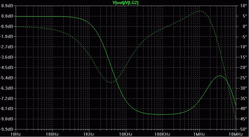

Is it too much to ask to run the same simulation but now with an output cap of 1uF, 5nH and .01 Ohms?

Hi guys,
Regarding the simulated line rejection results, please note that I'm not making the claim that these are some kind of ironclad results. It's really just to say, "This is what I found". I'm going to try some more things and see what shakes out. I did have to use a .NODESET directive to get the DC analysis to converge. I need to figure out how to get LTSpice to report the DC operating points it found for the AC analysis.
Walt was right about the Zobel network affecting the results, though it is a bit subtle. The plots without the Zobel network (not shown) show slightly less phase shift at 10 MHz - about -37.5 degrees lag instead of -45 degrees, and -8.0 dB of gain. I found that reducing the Zobel network series capacitance by a factor of 10 still killed the 50 MHz parasitic just fine. That should kill the extra phase lag from this contribution.
Per Jan's request, I've shown a plot with a load capacitor of 1 uF, having a series resistance of .01 Ohm and a series inductance of 5 nH. The attenuation at the notch is 33.3 dB, which would correspond to an output impedance of the pass transistor of 0.45 Ohms if it were purely resistive. This is consistent with the 61 mA operating current from the DC current source load. The behavior with the 100 uF cap with 0.25 Ohm ESR is also consistent with that value of pass transistor output impedance. I think this plot shows pretty clearly that a low ESR cap is not good. The notch can be so deep that it forces the loop gain magnitude to unity at a frequency below the notch where the phase is lagging considerably.
I would expect the D44H11's to do better here than the MJE15030 I'm using, because of their higher ft. I have done some checking of the simulated ft of the MJE15030 model vs the data sheet curves. They agree well with the data sheets. Those results are shown here http://www.diyaudio.com/forums/showthread.php?postid=245533#post245533 Note that I incorrectly wrote "IKF" in that post when I should have written "ITF", which Christer later caught. Maybe I could get one of the mods to edit this.
I did the plot below by replacing the 100 uF cap with the 1uF cap. I'm now beginning to wonder whether Jan wanted this or to add it in parallel with the 100 uF cap. The Zobel network has been removed for this simulation.
