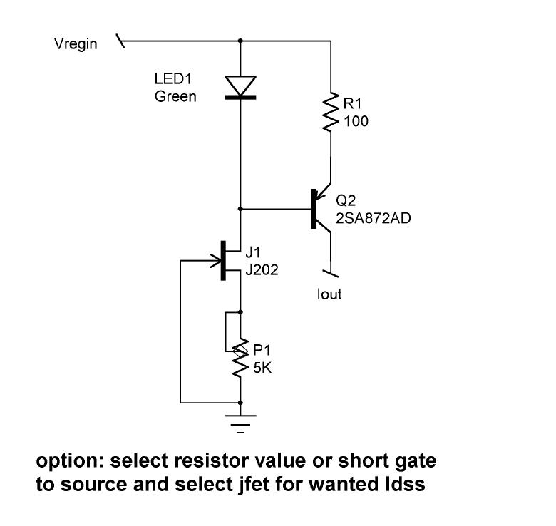

One change I have tried and also described in a post somewhere up north was the replacement of the entire input current source by a JFET current source. In other words, get rid of the LED, the PNP and related resistors and connect a FET CS directly from raw input (or after the prereg if implemented) to the pass transistor base. This improves the input ripple/noise rejection manyfold. But I found that a 1 or 2 mA CS was not enough to obtain good regulation above 100mA load or so. I had to look for a CS spec'ed at 5.6mA, that worked fine. As I noted earlier, these CS'es need some 5+ V across them so they ruin your dropout voltage. Still, it is an elegant and worthwhile mod if you have the extra input voltage. And it wouldn't need a PCB change I think.
I'll answer the comments above referencing also Fred D's sch. of the modified Isource, post # 390.
Yes, Jan, I can agree that this would work to some degree, and be both better and more simple (if not cheaper). I also agree with you that these JFET current regs. need lots of voltage to get beyond their knee, and flatten out to the highest Z. 4-5V maybe.
That said, they also may not be high enough in Z. I have found that a JFET cascode always works better for highest Z, albeit at the expense of even more voltage loss. Now we're up to 5-6V or more if another JFET is used as the cascoding device. But, given the high desirability of a cascode, modifying Fred's sch. further may be the very best alternative in terms of minimum component count, and also reasonable cost. Here's what to do with it:
1) Replace LED1 with a 6.8V zener, cathode to Vregin (dynamic Z will be a few ohms). This can be dropped down to 5.6V if headroom loss is a great worry.
2) Replace X2 with a 10k ohm resistor.
3) Replace Q2 with a PN2907A (lowest cost, lowest C part for the job, excellent Hfe).
4) Replace R1 with a 2N5459 JFET, selected for 4-5mA for the currents you describe. For lighter currents, a 2N5457 will suffice at around 2mA.
Most of the above parts are available from Digi-Key or Mouser for pocket change. High voltage parts can also be sub'd if desired for the 90V reg, with the 10k R adjusted upward in value.
This type of Isource has been tested both on the bench and via simulation, and the output Z is higher than that of the prior suggestion (which is limited by the non-cascoded xstr's sensitivity to Vcb variation).
A general point which should be understood about this type of regulator. With the inherent tight buffering of the op amp errors due to the rail bootstrapping, plus the reference diode being fed from the regulated output, the Isource errors constitute the major dynamic source of errors. Thus almost anything that can be done to improve Isource stability etc. is very much worthwhile (some might even read that to mean audible).
In other words, those posters asking about what the reg output does for various Isource topologies are on the right track. The answer is that it will change dynamically due to Isource imperfections, if you allow them to happen.
Now, after all that, maybe the prereg looks good?

I a little confused as to the interpetations people are taking from my idea.
All advocated was the replacement of the 10K resistor that biases the green LED. This LED serves as the reference voltage for the bipolar current source. There is no change in headroom since the 10K resistor sees the input voltage minus the 1.8V drop across the Green LED. There is plenty of voltage to operate a jfet or two terminal jfet current source in its linear and high inpedance region.
Walt is correct in stating the the J502 is fairly expensive and it is avalible for around $ 1.60 from Mouser. Another choice would be the the Vishay J202 at about 42 cents.
http://www.mouser.com/catalog/616/306.pdf
I am not suggesting not using a preregulator, but just a simple change from a resistor to a jfet to increase the PSRR of that portion of the regulator. It
is a very simple change that looks worthwhile to me. I will hold off on how to get rid of the level shifting circuit while still retaining the bootstrap supply
for the op amp (mod to ALW 14 volt regulator) by using a certain transistor
as the buffer between the op amp and pass transistor. I am afraid a riot would
break out.

I think that you could change the green led to a red one and get lower effective voltage drop. Heck, you could use 1 diode instead of an led. Then a FET current source would be really more important. You should use current source fets if you can, and are not expert. They are already selected and optimized at the rated current. The Vishay j202 seems to be a pretty good deal, if it is like the j502 in performance.
Don't expect VERY high effective impedances with fets, unless they are long gate devices. This would be unusual with cheaper fets. Cascode is recommended in many cases.
If you NEED a current source, the j202 on reflection is actually a poor choice for a current source, UNLESS you know how to sort for current or calibrate it with a series resistor. This is beyond most people here, and it takes a certain amount of time and a large number of parts. There are better parts with a lower Vgs, such as the 2SK170 Gr that would work OK, once selected out to the right current value of Idss.
Don't use a J202?
I thought that you said that you need a long gate device. According to Siliconix AN103, a J202 is such a device.
Yeah, I would use the '170 too, but only because I have a lot of them around.
Depending on the current range you are designing for, you can make a FET CCS with a dynamic Z > 1 Megohm.
I think we are generally in agreement, +/- a few tenths of a dB, in a manner of speaking.

Ok folks, we are talking in circles.
First of all: Do we just want to use a fet as a current source from the supply input? If we do, then we have to use a low Vp device. That means, high Gm. It will have marginal output impedance and it will amplify its own noise, but it can be made to work.
Or do we want to use a fet as a current source to bias a LED that is connected to the supply, while the fet current source is connected to ground? Then, a relatively high voltage 40-50V part, usually a long gate type, like the J202 is recommended, as it will allow relatively high voltage across it, and because it has low Gm, will not amplify its own noise as much. A current source fet will work as well, but they are fairly noisy, and relatively expensive. Their greatest advantage is that you know the current they will pass, because they are selected at the factory to have a specific current.
Effective impedances above 20K are practical with the fets discussed here, but only a cascode will get you there, for sure. Watch out for short gate devices (high Gm) They sometimes look like a triode, rather than a pentode.

YES, THAT'S WHAT I HAVE BEEN TALKING ABOUT ALL ALONG.......
Your just having fun with us now John...... The J202 was recommended as replacement for the 2N4340 mentioned in the Siliconix "The FET Constant Current Source" ap note. It has very a low output conductance of a few micro-mhos typical of those jfets that make good current sources and a drain to source capacitance of about one pF. It seems that jfets with large foward transcondutance like the 2SK170 don't make the best jfet current sources.
I agree that a two terminal current source would be better still, but I created a near panic by recommending one THAT COST A DOLLAR AND SIXTY CENTS! Putting a trim pot together with a jfet to dial in the current to the value desired is easy. It is not beyond any one here with a soldering iron, a VOM, and the initiative to read the article referred to above. In the context of biasing the LED in the BJT current source, the actual value of the current biasing the the LED is not that important. I would shoot for a value in the 0.5 to one mA range and not get anal about it in this particular circuit.
Once again, all of this was about biasing the LED for the bipolar constant current source and making the BJT current source more immune to voltage variations in the supply voltage. I believe it is worth doing whether one is using a preregulator or not, but obviously it's more important when not using a preregulator. Assuming an LED impedance of about 30 ohms (based on measurements) the change in LED voltage with input voltage is about 30/10000 or 3 mV per volt. One hundred ohms of emitter degeneration gives about 30 microamps per volt change for an output impedance of about 33.3 K ohms.
It appears to me that the bias current change the in the LED voltage reference is the dominant factor controlling the effective output impedance of the BJT current source under discussion. Replacing the 10 K resistor with a jfet current source with a 1 megohm impedance should give an improvement in output impedance of about 2 orders of magnitude, a pretty good return for the investment of one jfet.
