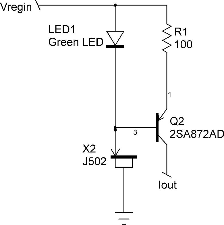

I replaced the 10K resistor bias for the current source LED with a jfet current source. This should result in about a 45dB improvement in LED voltage change with respect to input voltage change. Replacing the 10K with two 5K resistors with a cap to ground might be an even better approach.

One change I have tried and also described in a post somewhere up north was the replacement of the entire input current source by a JFET current source. In other words, get rid of the LED, the PNP and related resistors and connect a FET CS directly from raw input (or after the prereg if implemented) to the pass transistor base. This improves the input ripple/noise rejection manyfold. But I found that a 1 or 2 mA CS was not enough to obtain good regulation above 100mA load or so. I had to look for a CS spec'ed at 5.6mA, that worked fine. As I noted earlier, these CS'es need some 5+ V across them so they ruin your dropout voltage. Still, it is an elegant and worthwhile mod if you have the extra input voltage. And it wouldn't need a PCB change I think.
I thought that this was also what Fred meant, but I now see that this was no so. Anyway, any comments from your side?

Fred, what about a LM336 and the JFet CCS?

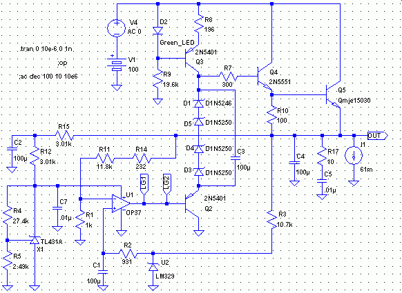

Understood. When I mentioned the op-amp idea, it was mostly offered to Fred for consideration, and I know he's well aware of these issues too. I've done quite a bit of SPICE simulation of a 90 Volt version of the Jung super regulator and would be glad to post the results if anybody's interested. This includes transients of load current and unregulated input voltage as well as stability analysis. However, I suspect that the interest in the 90 Volt version would be much less than for the classic version of the regulator. For the 90 Volt version, I had to use a slower pass element, which was also combined with an additional bipolar in a Darlington configuration for increased output current. Because of the extra phase lag from this, I wasn't able to achieve stability with the feedback resistor bypassed.
I simulated the performance with a number of op-amps, and indeed the AD825 had the best transient response for pulses of load current. The AD797 was a complete disaster in this application both for stability and transient response. However, I found that the OP37 gave transient response almost as good as the AD825, but with about a 40 dB improvement in line rejection at 120 Hz. Since this is for a power amp application, the low-frequency ripple rejection is important to me. Those results were what prompted me to mention the idea of op-amp substitution.
Here's the schematic from the simulator. Bypass capacitors on the unregulated input are not shown. The Zobel network of R17 and C5, together with R7 killed a 50 MHz parasitic in the pass transistor that showed up in transient. All the 100 uF electrolytics have 30 nH and 0.25 Ohms in series internal to the model. I've got multiple zeners in series because the tolerance on the lower voltage ones is tighter than the high voltage devices. The dissipation in the TL431A is such that the DIP version is necessary. It's too much for the TO-92 unfortunately. Based on Walt's post earlier, I'll probably replace the green LED with a voltage reference. I may use a MOSFET for Q2 based on Fred's input. The dissipation in some of the resistors is much higher than I'd like.
