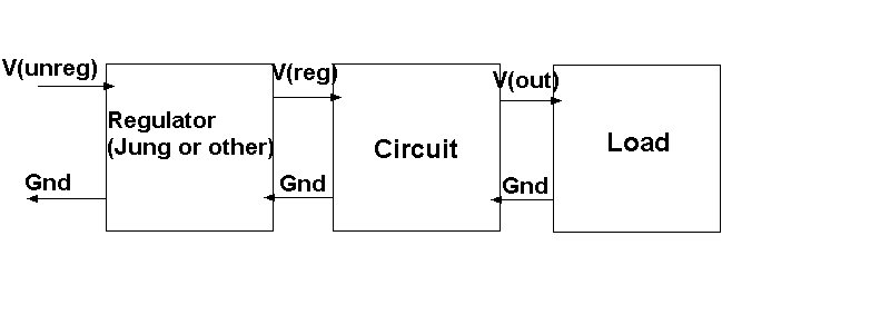

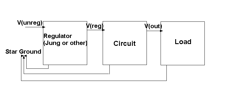

I have a question about grounding/return paths.
My next 2 pictures will show the 2 possibilities I'm thinking about, and I don't know which is good.
The 1st uses some kind of "floating ground", the ground of each component (PCB) is taken from the component (PCB) before it.
When I'm thinking about return paths, this one looks better.
But if somewhere in your circuits you have to feed multiple loads, or loads that have other sources connected to it, you'll have ground loops
The 2nd connects every ground to star ground, but return paths create loops :/
Help! 😀

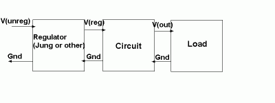

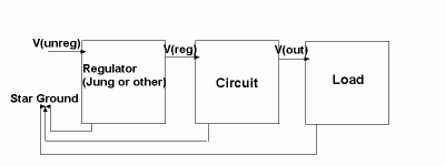

Help! 😀
While being no expert on this, I suppose the answer could
depend on the actual detailed content of those boxes. I
think Jan's discussion of this in part 3 of the TAA articles
will provide you with a satisfactory answer (in theory, at least).

Bricolo said:2nd scheme:
Scheme 2 gets my vote. Using a sense ground connection allows the star ground point to be moved from the "regulator" block to the "circuit" block.
JF
Precisely. If you take both the 'hot' as well as the return sense lines from the circuit block, you control the supply right at the point where you would want the ideal DC source. That is the concept of the remote sense in the Jung/Didden/Galo regulators.
JF

First, I'm not sure what part you don't understand. You don't know why I choose scheme 2 or you don't know why I indicated that the sense lines allow you to move the star connection to the circuit block. So, I'm not sure which question I'm trying to answer.
As far as scheme 1 and scheme 2, it really depends on where the sense circuitry is connected (where the Kelvin connections are located). At first scheme 2 looked right to me, but it's dependent on the sense connection.
As in a four-wire ohm measurement, there are two "Kelvin" connections: upper Kelvin (Ku in diagram) and lower Kelvin (KL). These are the sense lines, of the greatly simplified Regulator circuit. The regulator will regulate the voltage across those two points. Because of series resistance, the voltage at other points in your whole circuit will be not as well regulated (though perhaps the difference is small).
The reason this helps is because the current in the relatively low impedance conductors of +Reg and +Reg Return have voltage drops (again perhaps small). The sense lines +Reg Sense and +Reg Return Sense are relatively high impedance connections to the voltage reference. The Regulator is looking/sensing/regulating across the Kelvin connections.
To the best of my knowledge, the best place to place the Kelvin sense connections is where your most sensitive circuitry is (ie the input to the amplifier circuitry). Someone at diyAudio wrote that the most sensitive circuitry should be closest to the power supply. That way fluctuations in the power section of your circuitry are downstream of your sensitive circuitry. Rather than the sensitive circuitry being down stream of the power section.
Simply put using the two sense lines properly compensate for the series resistance loss of the power and return lines.
I would expect that the Kelvin connections are the place to have star connections. The +reg side is starred as the +reg return is a star.
Comments welcome.
Also, if anyone is familiar with something called a 16-wire Kelvin connection (where each of the 4 traditional Kelvin connections each have 4-wire connections), I'll appreciate some information. I'm sure that ran across that once, but can not find any reference to it (thought it was from a Texas Instruments page).
