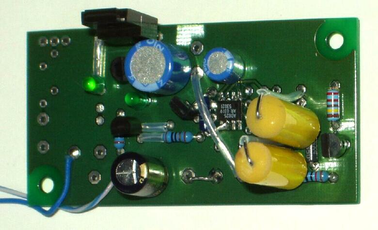

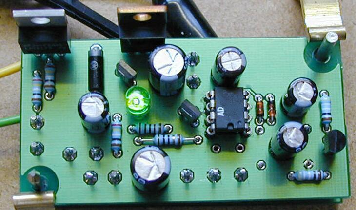

Dear Mr. Jung,
A bit late perhaps, but I would still appreciate a copy of the article. My email address is ybpkwan@yahoo.com.
I have also experimented with one of your regulator designs, not the usual EDN version, but that from Electronics Design Analog Application Issue of June 1997, with a few modifications :
-- Replace D1, D3+D4 by two sets of LM336 5V in series with a green LED to get 7.5V. I used LM336 instead of LM329 because I like the idea of being able to adjust the voltage by connecting a 10k Trimpot across the diode.
-- D2 is red LED
-- Q1 is D44H11; Q2,3 are 2n2907's; U1 is AD797 amongst others
-- R6 is adjusted to allow 2mA through D1
-- Additional 7.5V ZD between emitter of Q3 and ground to lower dissipation of latter
-- L1 included but at 330uH
The rest is pretty much the same as in the article, and I have followed the grounding scheme, etc . straightly. With an OP37 as U1, there were no stability problems and the noise level is beyond the resolution of my oscilloscope. But I did experience some stability problems with AD797, and even worst with FET opamps like OPA604 or OPA637.
In the end I solved the problem by adding an additional RC filter between Vout and pin 7 of U1, plus a current source (J508) to replace R6. But I still do not fully understand the cause of the problem (I think LM336 is quite sensitive to PS noise), and wonder whether what I did was the best way to address the issue.
Your comments therefore most appreciated.
Best regards,
Patrick

The article in question can be found at http://home.comcast.net/~walt-jung/wsb/PDFs/Low_Noise_Power_for_Analog_Circuits.pdfI have also experimented with one of your regulator designs, not the usual EDN version, but that from Electronics Design Analog Application Issue of June 1997, with a few modifications :
The D1 change is functionally OK, but if working at low voltages, LEDs work better for D3/4. I assume you *aren't* doing 5V. A *high* voltage for D1 is better, as it means less gain from the error amp. Plus, an LM329 is more quiet than an LM336.-- Replace D1, D3+D4 by two sets of LM336 5V in series with a green LED to get 7.5V. I used LM336 instead of LM329 because I like the idea of being able to adjust the voltage by connecting a 10k Trimpot across the diode.
OK if R7 is scaled like in the 4/2000 article (249 ohms).-- D2 is red LED
Q1 change is OK, *PN2907* is preferred, actually.-- Q1 is D44H11; Q2,3 are 2n2907's; U1 is AD797 amongst others
Swapping op amps isn't encouraged in such a finely tuned system, unless you are fuly prepared to troubleshoot. The AD825 of the 4/2000 article seems to be much improved as to stability issues. See caveats and tips in that article on stability.
OK...-- R6 is adjusted to allow 2mA through D1
I don't understand why this is necessary, or how you mean it is connected. Q3 won't overdissipate, unless you are making very high voltages??? How much current is coming from Q2?-- Additional 7.5V ZD between emitter of Q3 and ground to lower dissipation of latter
OK-- L1 included but at 330uH
Pretty much the same? I don't think so! I repeat, see caveats on stability! FYI, OP37 and OPA637 are *NOT* unity-gain stable!The rest is pretty much the same as in the article, and I have followed the grounding scheme, etc . straightly. With an OP37 as U1, there were no stability problems and the noise level is beyond the resolution of my oscilloscope. But I did experience some stability problems with AD797, and even worst with FET opamps like OPA604 or OPA637.

Jung Super Regulator, collecting the parts
I have finished the positive regulator using the kit I got from ALW. I made few changes that seemed good ideas in theory, but I have not done listening test to compare with the stock version of the regulator. I cut the trace to the op amp supply pin and added a series 10 ohm resistor before the 10uF Oscon decoupling cap. This was to not have two high Q caps in parallel and to decouple the op amp from the bootstrapped supply at high frequencies where the op am has very low PSRR. The increased impedance for the op amps supply is not an issue since the driver between the output BJT and the op amp is a low capacitance mosfet. The mosfet is a very high impedance for the op amp to drive at audio frequencies and should not wiggle it's supply despite the 10 ohm resistance. The higher gate to source voltage of the mosfet allows the use of a LED, with it's much lower noise, for the level shifting. A correctly RC bypassed LM329 might be an even better choice. The current source and pass transistors are 100 MHz Toshiba BJTs and the regulator appears to be very stable. I would use a Hitachi C1775 and A872 for the current sources if I had some on hand. I replaced the 10K resistor bias for the current source LED with a jfet current source. This should result in about a 45dB improvement in LED voltage change with respect to input voltage change. Replacing the 10K with two 5K resistors with a cap to ground might be an even better approach. The feedback and voltage reference filter resistors have been greatly increased in value to allow the use of F-Dyne polypropylene and foil caps. Lead free 4% silver solder was used for the whole board. Will probably try a pre-regulator later on.
Andy did a fantastic job on the PCBs and I look forward to finishing them and listening to them this week. I hope he and Walt both, will forgive me for messing with an already excellent design, but it seems to be a rather incurable habit of mine at this point.
Fred
No, I will not answer questions about this on the forum, Mr. Pand S. I might discuss the rational for the changes via Email to interested individuals, but really don't want to get in that level of detail on the forum.
Fred

A picture may not not beat a thousand words
"At this point anyone that can't understand what you said shouldn't be messing with the circuit in the first place."
I was joking about refusing to help anyone. But as you point out, changes of this nature require an intimate knowledge of the circuit. I really don't think most people should make changes this extensive. Despite the description, there are about a half a dozen questions one should be asking before attempting these mods. There is more to this than I have described, and I would not attempt this on the basis of only what I have written, it is insufficient information. I do think I add the LM329 level shifting circuit but it will require a little Spice modeling to do correctly.
As you can see Andy's stock version is much nicer looking than my modified version and is shown with the DIP op amp package option.
