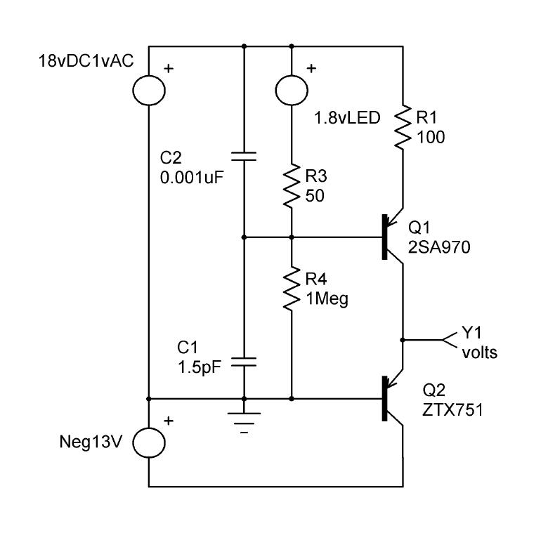

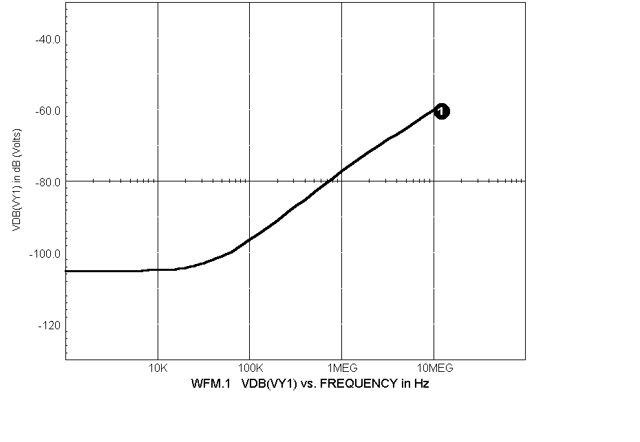

Fred Dieckmann said:Rejection curve for Spice model of the constant current source at the emitter of the pass transistor driver circuit above, for the AWL/Jung regulator.
sorry,my disturbing, MR. Fred.
In my mind,You are an expert. I like your post.Although my English is poor,I had learned more knowledge from your post.
thanks a lot!
I want to know all what you say,but ....some sentences you writed maybe longer to me,I had a lit difficulty to read.
thanks again!!!
Fred,
Interesting curve. >100dB to way above audio. I guess we are over the line of diminishing returns. In practise, PCB leakage, stray capacitance etc will make sure that you stay below this curve. No point in going further, except for mental masturbation (will this go past the censor?).
Jan Didden
Jan Didden

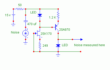

We don't need no steenking simulators, phase I
Measured the PSRR of the circuit shown below. The current in each LED is around 1 mA.
I threw it together with the parts that I found close at hand, so I don't want to hear any kvetching about using a 2SK170 as a CCS.
Jocko
Jocko

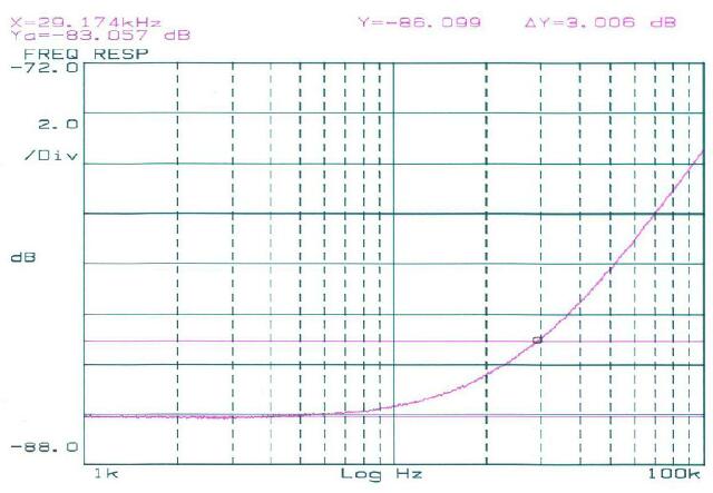

.....phase II...
Here is the measured performance of the circuit. Since it may be hard to read (decent pens are getting harder to find at short notice), the data is:
PSRR @ 1 kHz = 86 dB.
PSRR @ 29 kHz = 83 dB.
Not bad for something thrown together, and not optimized.
Jocko
Jocko
