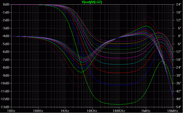

Another pass element transfer function plot...
Just for grins, I though I'd do another plot of the voltage transfer function of the pass elements of the 90 Volt regulator I posted here: http://www.diyaudio.com/forums/show...6528#post256528. I wanted to show the variation with load current and frequency. This plot is from the base of the PNP emitter follower connected to the op-amp output to the overall output of the regulator. Since the open-loop output impedance of the pass element is roughly inversely proportional to DC load current, you'd expect less and less attenuation at the series resonant frequency of the load capacitor (about 93 kHz) as the current goes up. And that's just what is seen in the plot. This plot steps the current from 20 mA to 200 mA in 20 mA steps. The highest attenuation and greatest phase variation with frequency are for the lowest current, with the opposite effect for the highest currents. This clearly shows that the stability of the circuit depends on DC load current. Also, one should not depend on getting a whole lot of high-frequency attenuation out of the load capacitor - certainly not more than a few dB if the current is at all high.
A couple of the phase traces are a very pale red and purple and almost invisible. Also, the colors for the phase plot unfortunately aren't the same as those for the magnitude plot at the same current. This appears to be a minor bug in LTSpice.

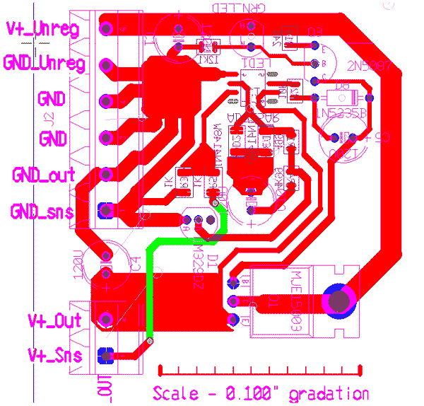

Nice work but the ground around the reference seems :scratch:
The ground at the connectors can be improved I think. I think you have missed the "ground sense" concept. You must not connect them internally and if you want that you must do it with some resistor+cap. Do you use groundplane? If not I recommend that you do.
i didn't put the ground plane in yet -- it makes it harder to see the silk when you screen-capture the image.
i will move/reverse the GND_OUT and GND_SENSE and connection to the "star blob", that's a good point.
the compromise -- in Walt's article he uses a "hole" or "pin" for the connections. I have chosen to use MKDS15_2RMI and MKDS15_6RMI connectors.
btw, I saved the entire thread and copied it to a PDF unexpurgated -- it's an entire meg, but if anyone wants one email me.
Here's my take. This layout is for a regulator whose load is adjacent, so it doesn't have any wire connectors. Sorry none of the parts are marked, it's a bad CAD package. Q17 is the pass element, the current source is on the left, and the reference is on the right. This is the "Improved Improved" regulator with current-setting resistors replaced with JFET current diodes.
Boss de Plane de Plane!
" here's a first cut:"
And here's the next one, rotate the output transistor from 9 o'clock to noon. The emitter lead is the least important one to have long since it's resistance is inside the feedback loop. Put a base resistor right at the base of the output transistor and keep the base and collector traces short. This is a high bandwith circuit. The single point grounds don't need a big fill or does the output. Let the feedback and sense traces do their job and don't worry about fat traces that are inside the feedback loop. Your ground sense line isn't and needs a jumper for using either local ground are the sense lead to the load. I am really curious why you left out AWLs enhancements which are worthwhile. Think current paths and the tightest layout you can get. I would not bother with a ground plane on a circuit this small and a two layer board which puts the plane 0.065 from the traces. Use some guard traces around the feedback network and return them to the ground pin of the op amp if you nervous without the plane. There is much much more to this layout than meets the eye as Jan and Andy and perhaps even Mr. Jung will tell you. I don't want to speak for Walt, but Andy and Jan have weighed in on this several times. You don't need the clamp diodes with the 825 and theyare taking up room in the most critical part of the layout!
One immediate reaction to jackinni's post was to move the connection from the V+_unreg to the collector of the pass transistor. Doesn't make sense to run the entire load current around the board and generating false voltages between the other points connected to this trace.
Other than that, I agree largely with Fred.
Jan Didden

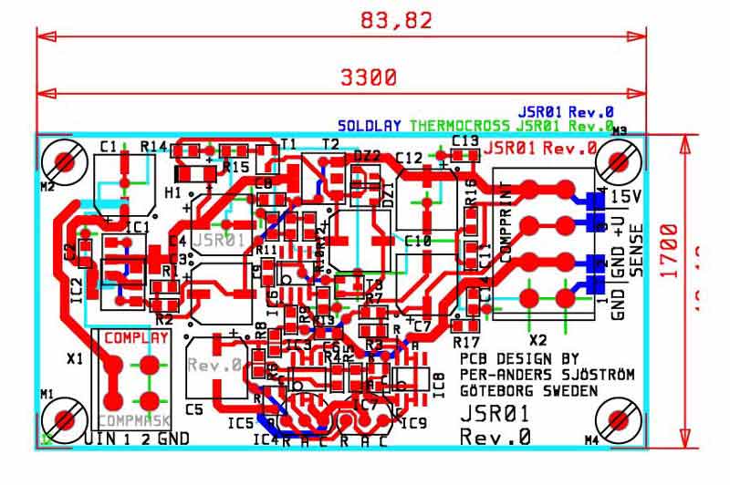

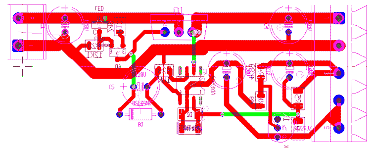

Here is my implementation of the regulator.
The green traces are connections to the groundplane, not shown. I have made room for three different kinds of references, TO92, SOT23 and SO08. It is also a negative regulator in the same pcb. The Wago connectors are huge compared to the other parts. If I ever will make a pcb I probably have 50 or 95 um copper (35 um or 70 base material + 25 um plated).
If someone want to think something, I have a minor "error". The sense ground isn't 100 % perfect but 10 mm 95 um copper won't create so much voltage drop of some uA's. It's around IC3, C6 and R8
