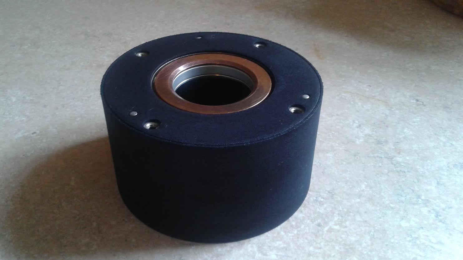

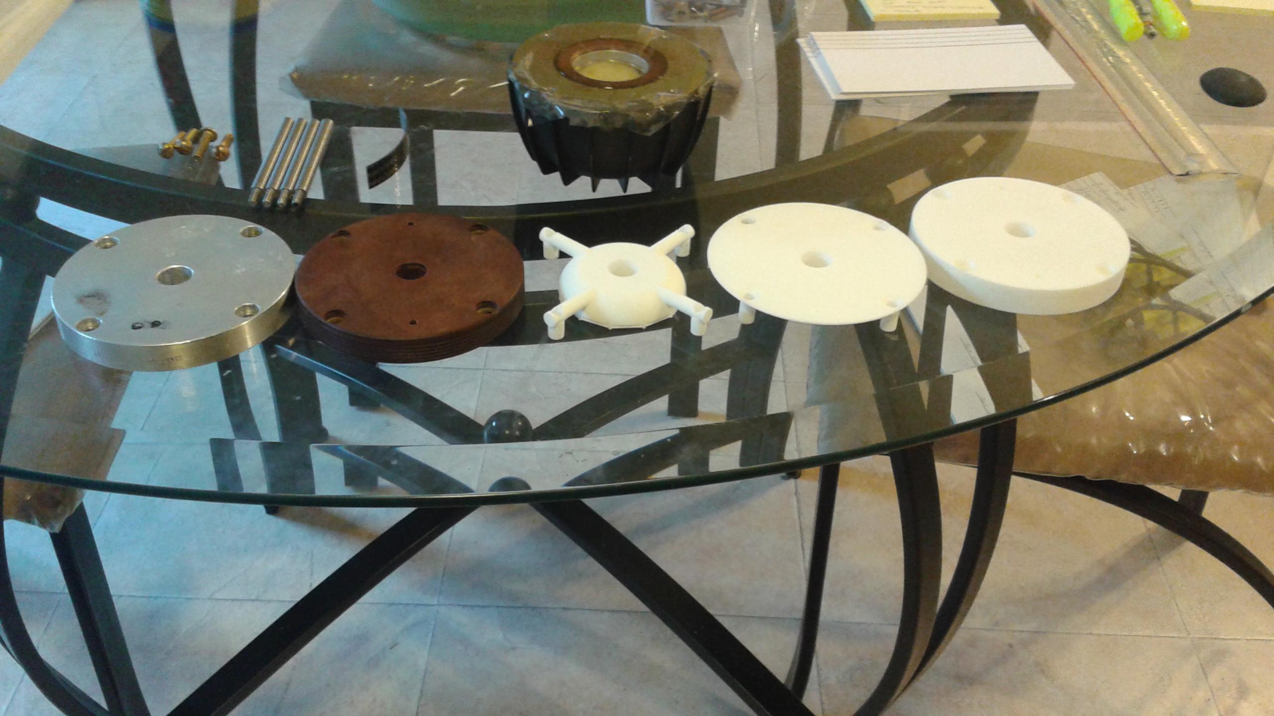

Top-plates Finalist
Thank you Steve I know we will.
The image shows the 5 top-plates to be tested. three materials and 3 geometries. Aluminum, nylon, Panzerholz. There are some nice visual changes that will be made when it comes to the motor should be a nice surprise.
The second layup is being done as the mold is only big enough for around 8 lamellas future lamellas will be made from a much bigger mold. The Ideal mold is one in which a pair of speakers can be made from. Since the shrinkage problem has been solved the lamellas are much more controlled in curvature and overall dimensions. The accuracy I am now getting from 8 so far is +-(.05mm)in terms of bent height before the range was something like .25mm
