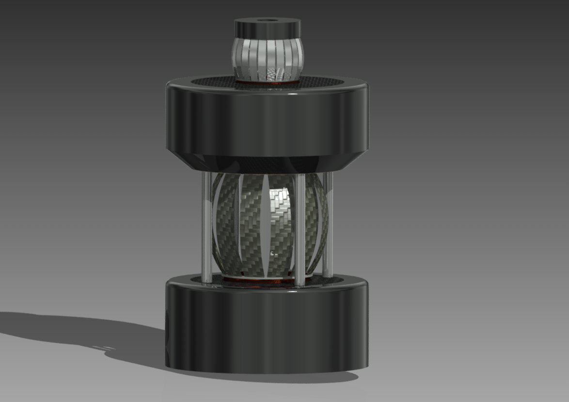

Summer Project - Replication of MBL loudspeaker 101mkII
Build
Finished speaker

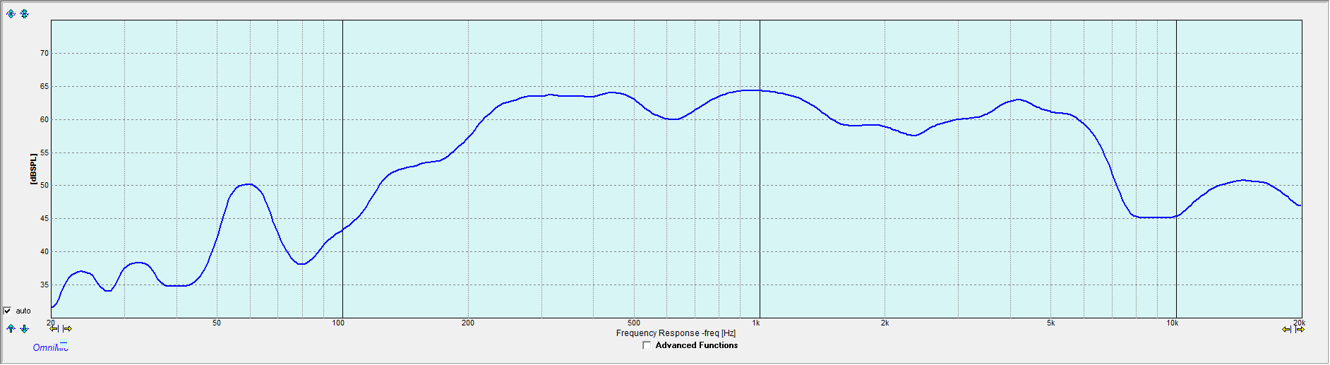

Quick measurement
Attached is a quick measurement taken in roughly the same spot as the earlier versions. a pseudo anechoic chamber will be built to allow for measurements in the future for direct comparisons.

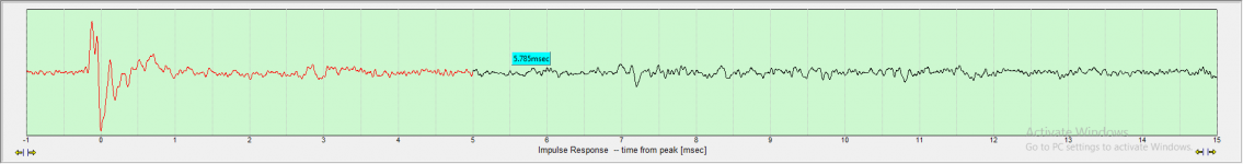

It appears there is some problem there in the impulse response as showing in the very initial impulse dip and the quick rise. It almost looks like a cone driver and tweeter would look with different rise times. Not sure what we are seeing there.

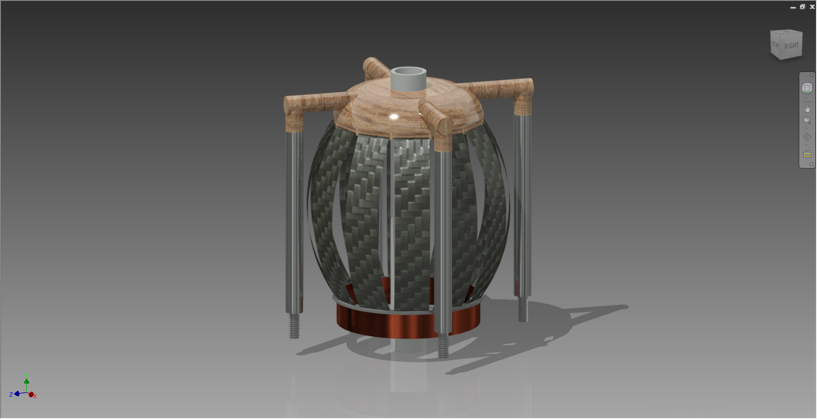

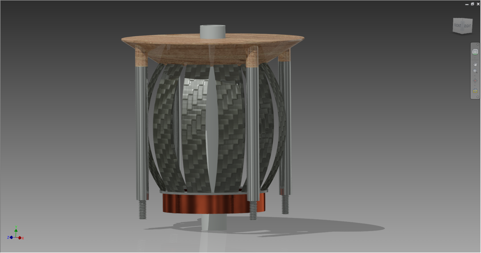

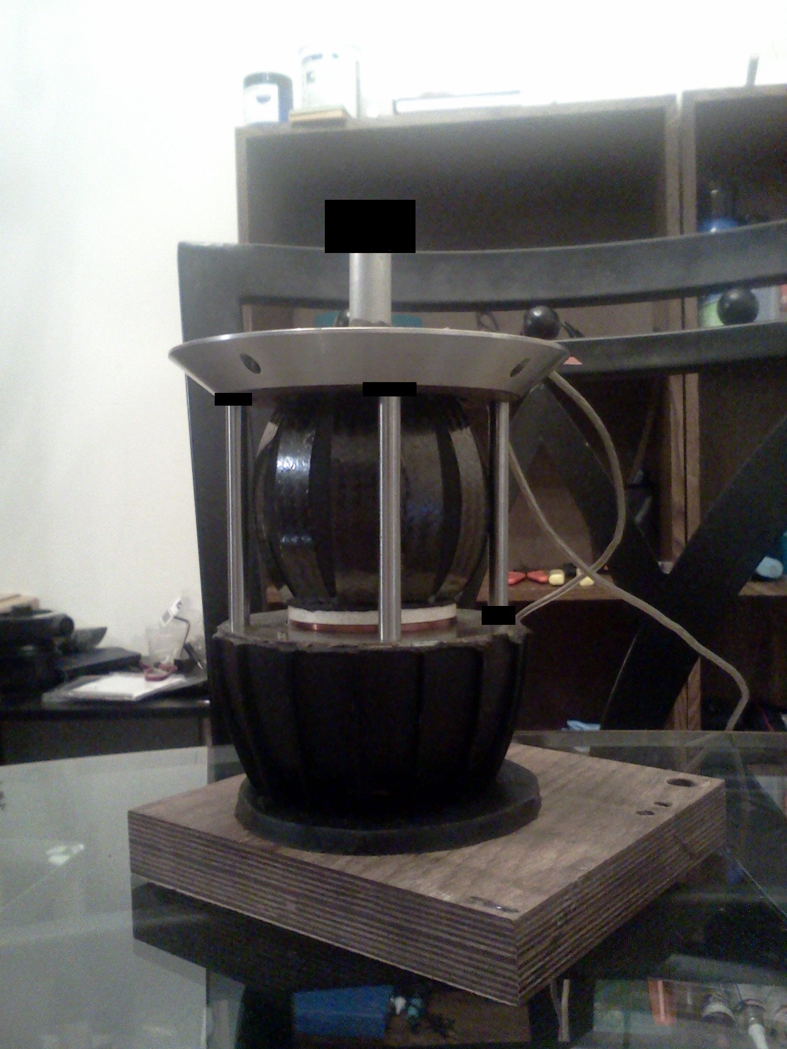

I was not satisfied with the build quality. I will Build a new unit fixing and building upon the errors in the build. I have designed 2 new top plates to be tested they are different in geometry. The plan is to build a testing rig as well as a listening rig. So that different units can be directly compared.
I have listened to these speakers a few years ago at HI-Fi Arena in Bucharest. A special sound but hard to replicate the speakers...atleast in my opinion. But I see that you had the courage to go get your project started and even managed to complete a large part of it. I wonder how it will sound at the end.
I am exited for what is coming There is always head room in development. The reasons for the gaps in advancement are mostly only due to financial reasons. As you may know projects like this one off completely custom experimental ones are not cheap.
