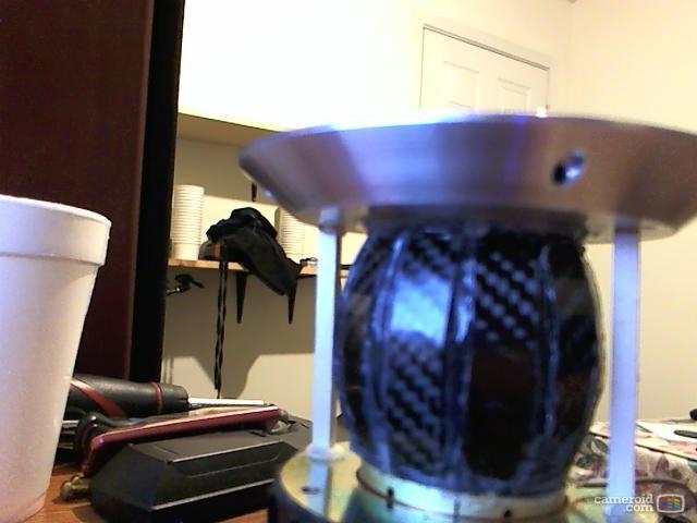

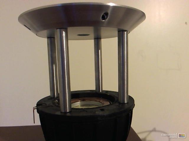

The following is a picture of all the machined parts that have been assembled.
Dimensions are near exact just different perspectives.

Realised working model
The following are both a picture, and a motion picture of a working mbl mid-range.

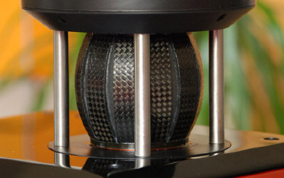

Looking good, man. Just to clarify, the picture on the left is of your speaker, and the picture on the right is of the manufacturer's speaker, correct?
Did you end up using the samurai carbon fiber for it or what weight in oz/yd did you use? How does it sound to you?
Yes the speaker on the left is the clone, and the picture on the right is merely for a comparison. This was a really quick and dirty version. Most of it is incorrect, it was made quick and easy just for fun while I sort out the kinks and work on the advanced version. This is why I did not post any measurements. An advanced version will be coming out next week so stay tuned. The carbon weight I am using for experimenting is 5.7 twill weave. Samurai carbon fiber and vacuum/oven curing will be on the final version which again should kick things up a notch. The actual tonality is very neutral although the highs are missing. The music floats from the very air itself even when 1/2' from the speaker it all stays in focus. I hooked up aTang Band 1337sd and the mbl, and spread them about 5 feet the sound was very good and was the most holographic sound I’ve heard. So to say the least things are looking good.
Awesome. How many layers did you use of the 5.7 oz? The latest pic is a little blurry but I can't see any voids between the fibers. Well done. The real MBL looks like it is plain weave cut on a bias. What are you using for the surround.. Or the creased, foam-looking material between the lamellas? Also curious why you chose silicone glue over epoxy to secure the lamellas to the VC.

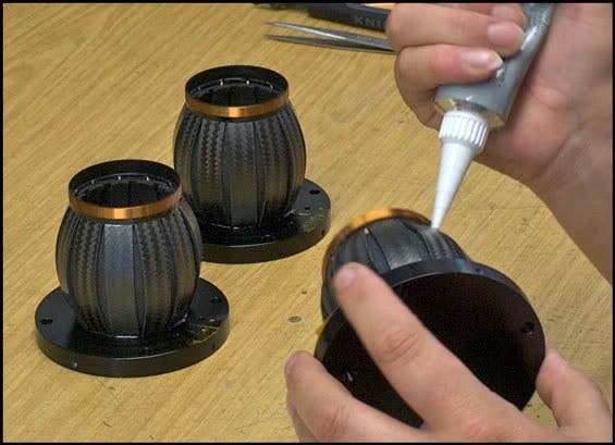

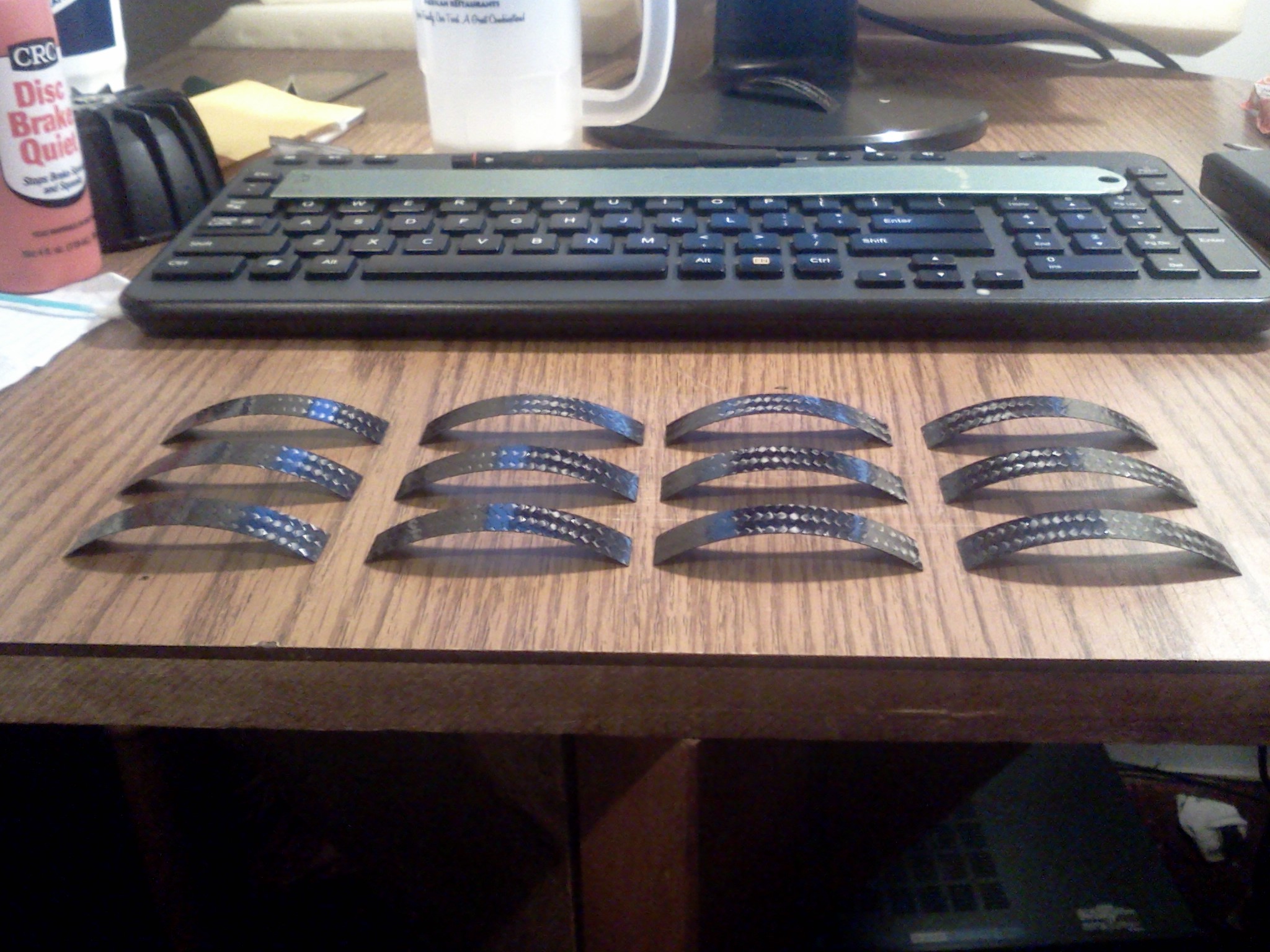

First official build ready
This has been a long time coming. The first official mbl clone build is ready to go, further post will show the final result and measurements. This is the set of lamellas for the first build. Test have been done to show the VF and FW contents which will be used and varied in further variations.

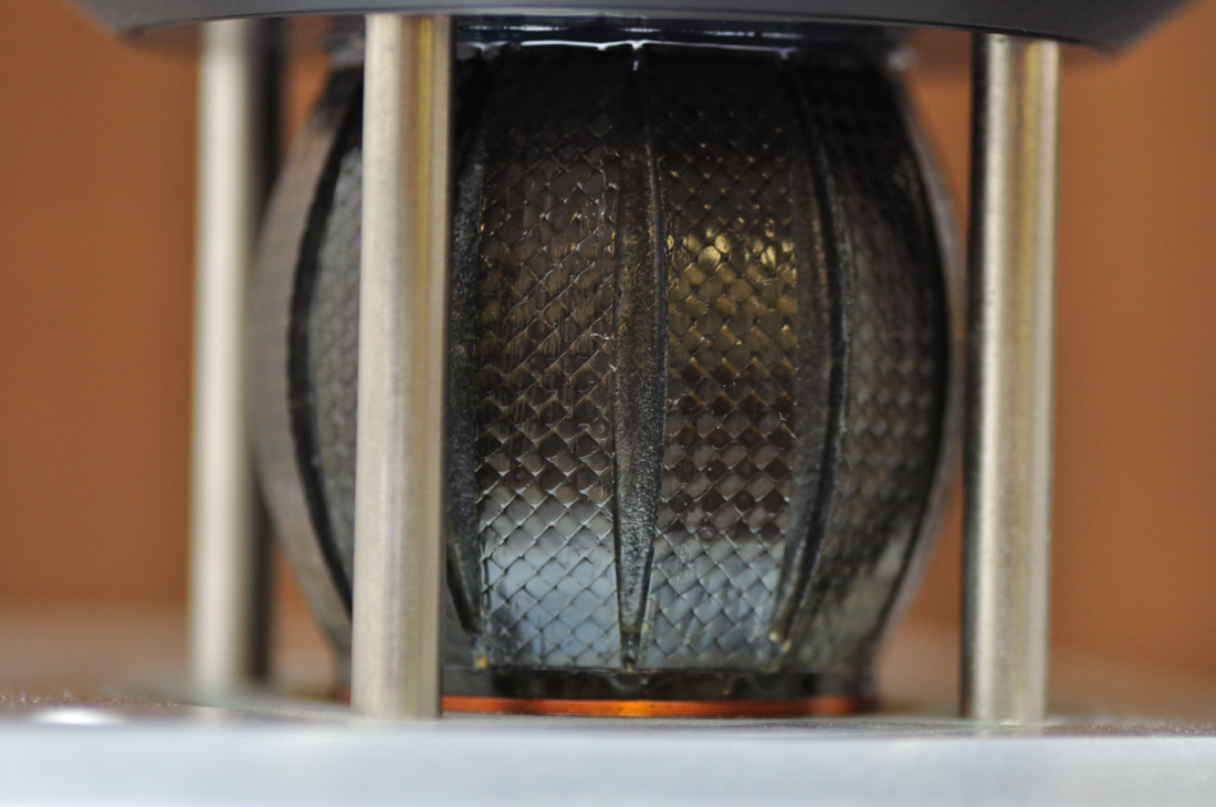

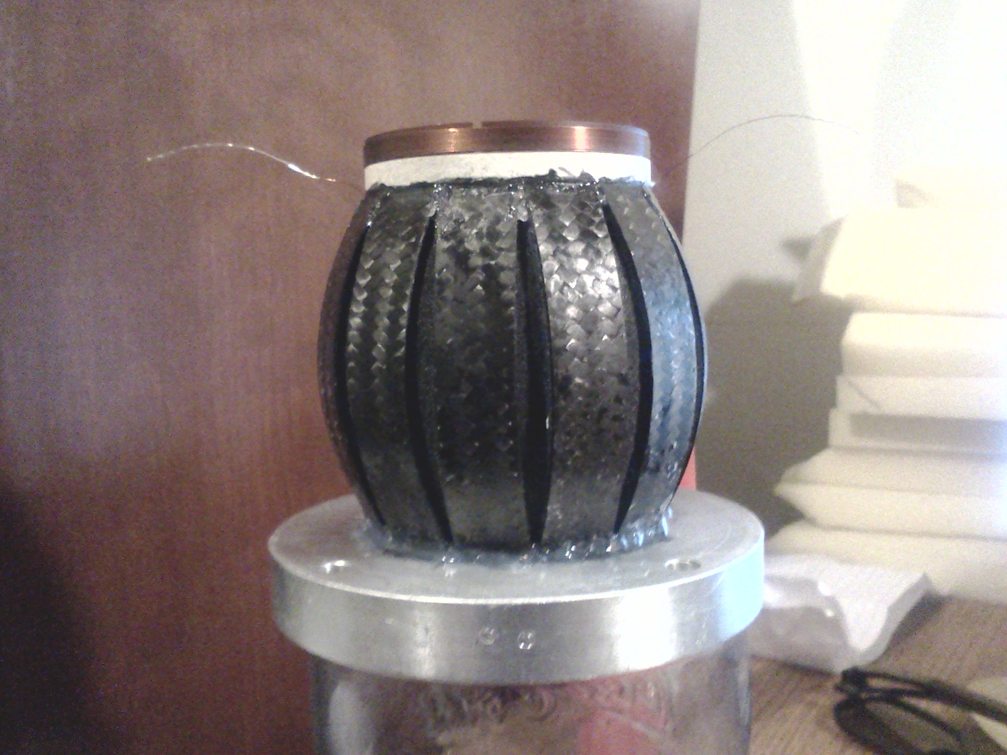

This has been a long time coming. The first official mbl clone build is here, further post will show the final result and measurements. This build has all the proper materials and dimensions as the real thing. The build I feel came out very nicely. I used job specific aligning rigs and shim with which I was able to get a near perfect alignment. Ofcourse there are improvements to be made in the construction of the clone.

The sound is pretty clean with nicely rounded mids and highs. There seems to be no peak in the frequency graph, like should be expected with composites. The sound is big and open with a tactile texture to the instruments. I have high hopes for this project, seeing how this is only the first of many revisions. The video does not do the clone justice.

From the pictures I can't see if the gap between the petals of the diy version is sealed. I can see the poliester damping inside but... must the spheres be airtight?

Hello Karellen. From the lastest image only the lamellas and seal is shown. The poly-fill cannot be seen from the perspective shown. The seal is exactly the same dimensions and topology included. Total mass comes in at 7.00g. Ferro-fluid "adheres" to the magnetic parts of the motor. So far I have not used Ferro-fluid. I will upload a video recorded with a hifi microphone when I get home.

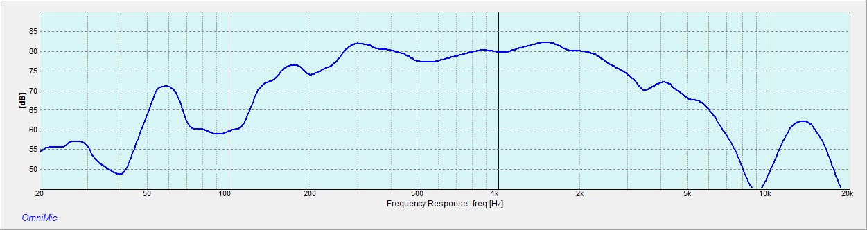

Frequency graph
Here is the frequency response graph. The measurement was indoors and taken at 1 meter. The graph seems good within 300 - 2khz. I will be paying close attention to bring the upper frequency up in the newer models.
