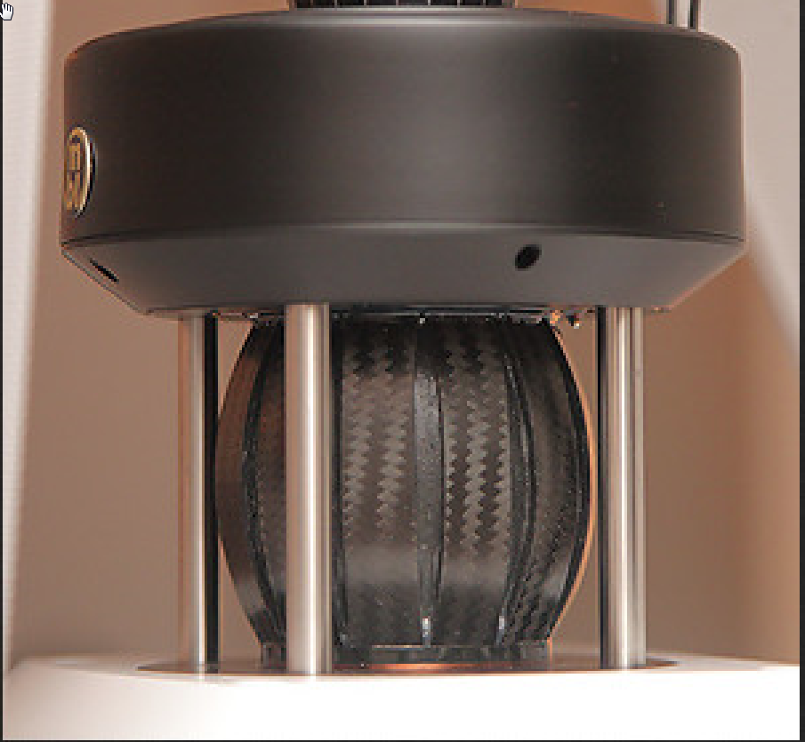

Summer Project - Replication of MBL loudspeaker 101mkII
Complete

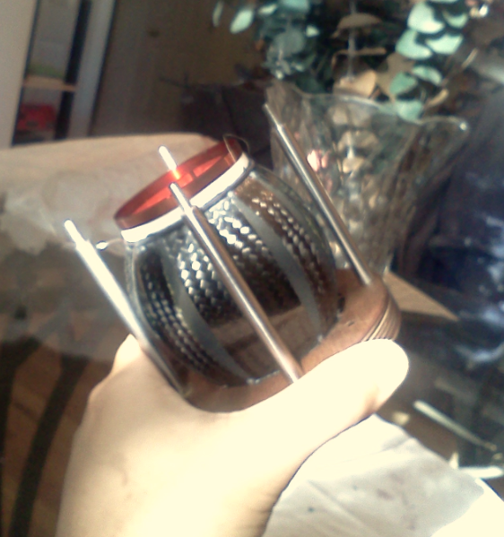

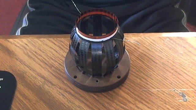

Finished speaker assembly along with its cousin. Let be just say these things make amazing monitors.

Will do karellan. The amount of variables for the lamella are high so testing and perfecting is going to take some serious effort. Other parts of the speaker of also part of the plan further down the line. There are some good ideas for sealing and such.
The testing stage is officially here all problems that hindered me in making a very accurate, reliable, and fast speaker have been solved. This New build will be a test of all of this after that changes in materials and construction will be tested and results will be shown here along with a recording.

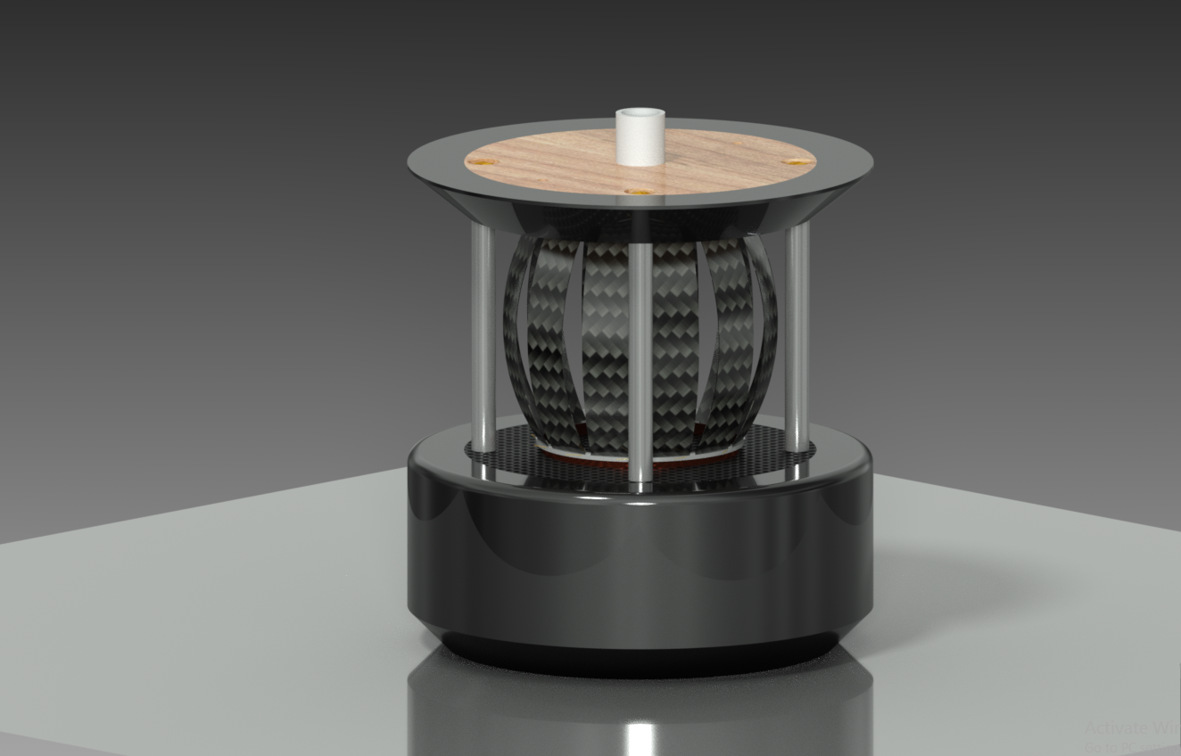

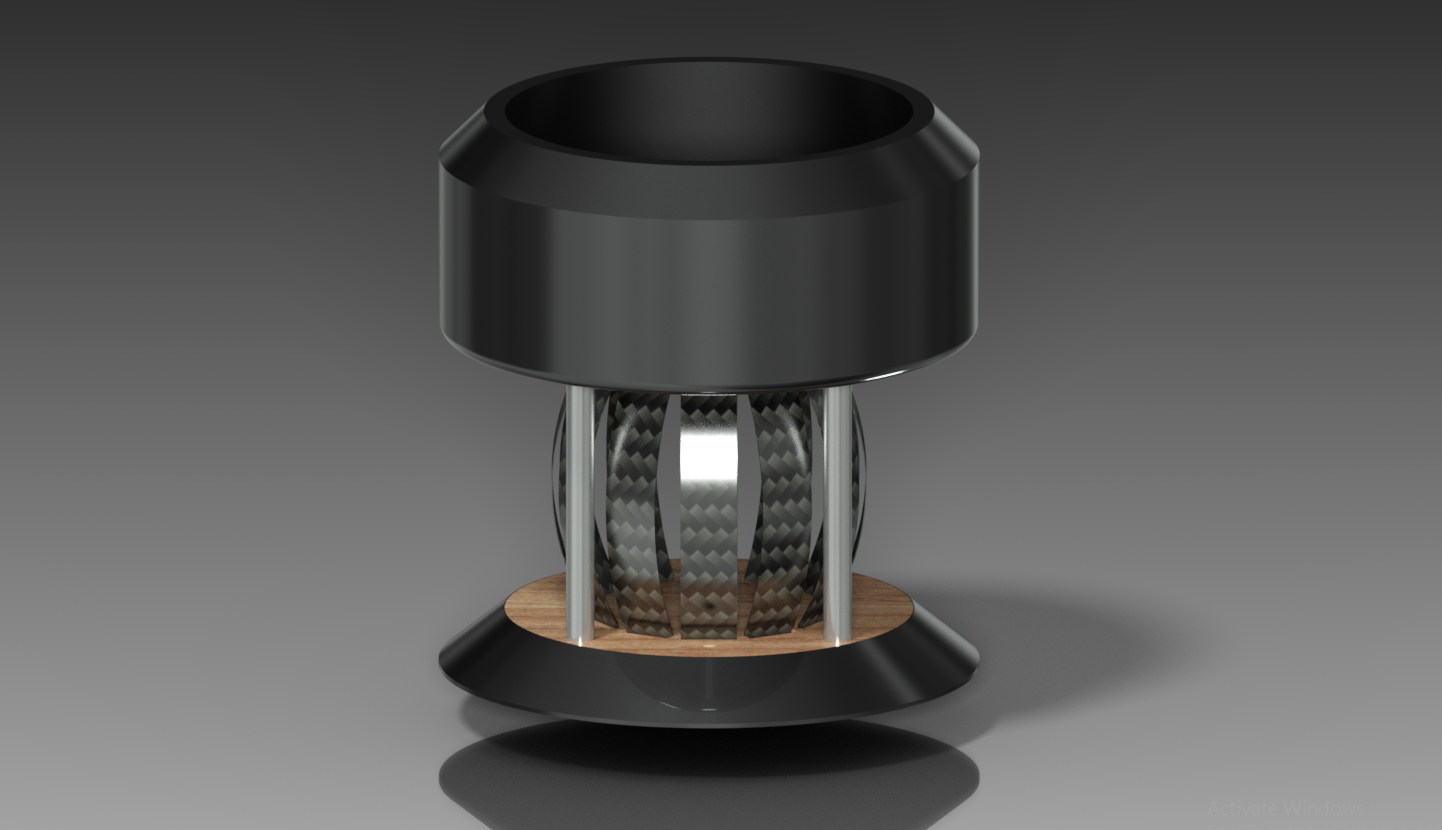

New Build on the horizon
A new build utilizing all of the new processes is in the works. I will be sure to include a recording and measurements soon after.

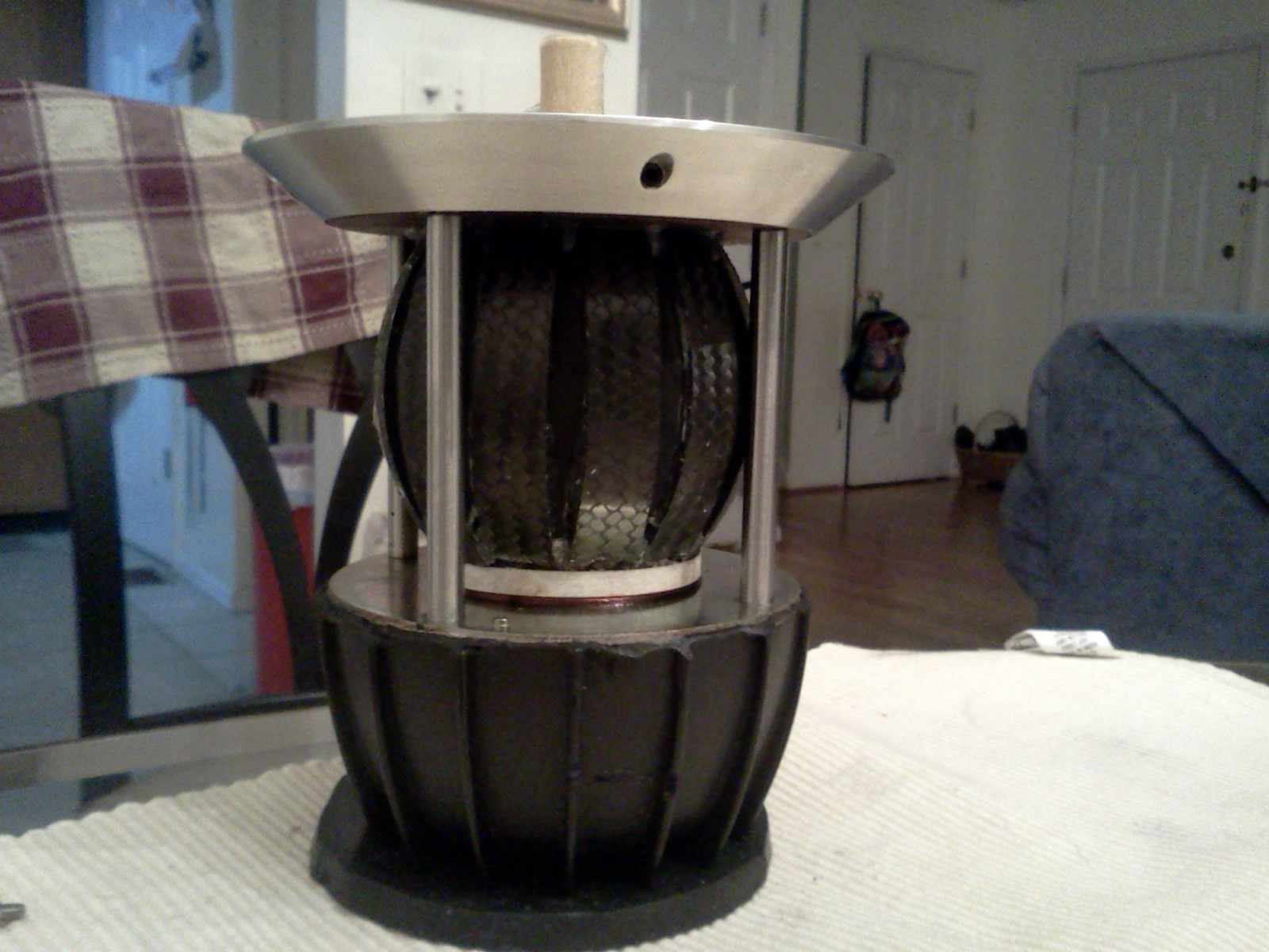

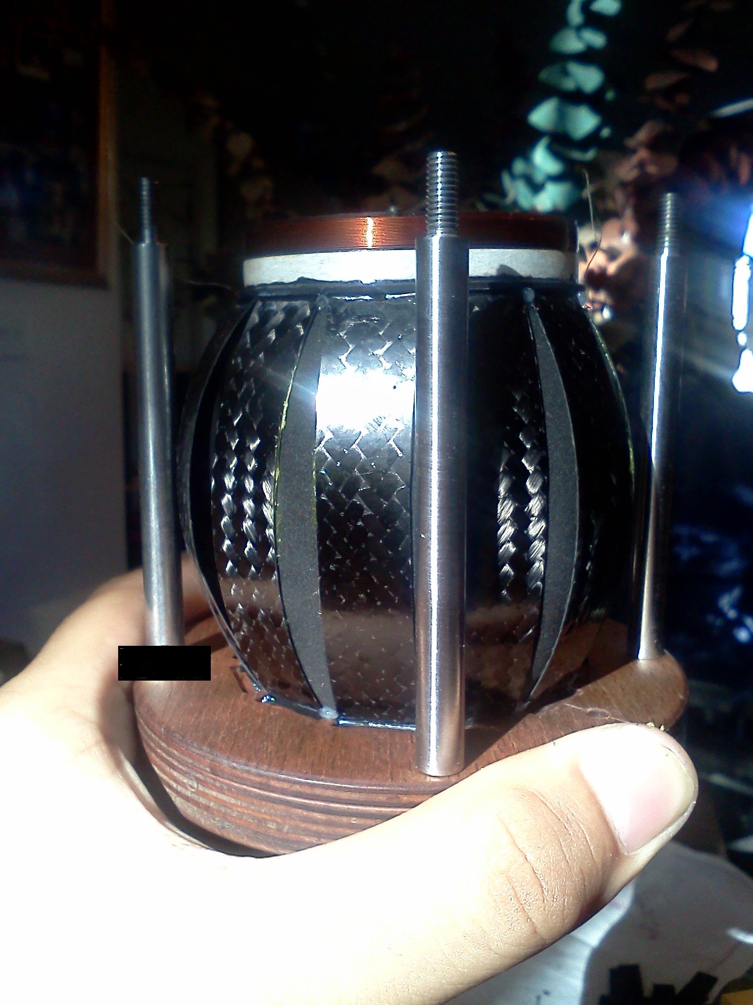

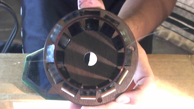

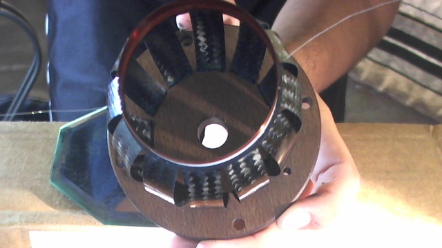

Thank you Karellan. The process is working great although I did find a few kinks that werent anticipated in real life assembly. This will no doubt be the best most accurate assembly. The first few test will show a difference within the same mid-range unit. changes in "additions" that will will show a before and after effect. The ones after will be a whole other mid-range with a design that should increase sensitivity.
Thank you karellan the amount of craftsmanship needed is insane. The amount of research and development needed to make a system to allow for the perfect alignment of all elements far exceeds it. No it is not EVA. It is in fact Neoprene foam. There are several tricks in building this thing that one only will truly know if they build it and research the heck out of it. The actual alignment system I use is in my opinion a little more "correct" than mbl. All from what I seen tells me they may be a little out of plumb so to speak.
Testing at every stage is crucial to know you will not end up with a messed up speaker. The most important thing to get all of the lamellas right and have to proper know how and equipment to place them. After that its simply a matter of careful hands. The speaker is finished there is a lag to when I post. Speaker has no apparent rock modes. only clean sound.
