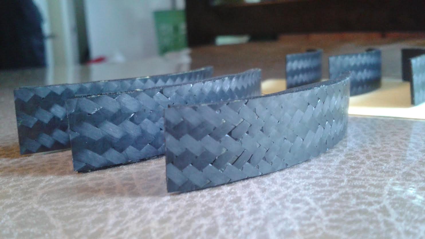

Idk what their tolerance is. My measurements are done with a run of the mill caliper. But each one is measured until I am absolutely certain. I sand down the edges and measure every few strokes and the end measurement is taken about 5 times to know for sure and I can pass it.
BigE,
It is hard to compare a stamped aluminum lamella to a composite part made with a different shape. I have some future ideas for Magnasanti to try but one thing at a time. I don't think that 0.25mm is going to cause any problems with sound quality or working tolerances, that is only 0,010" a very small difference that could be greater on a stamped metal part.

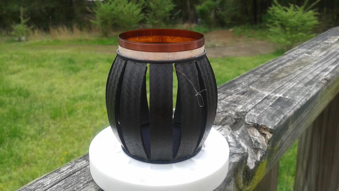

All cut
Lamellas are all cut and ready for gluing. In terms of laminate quality this is better then the previous attempt due to added care in the layup process and post process.

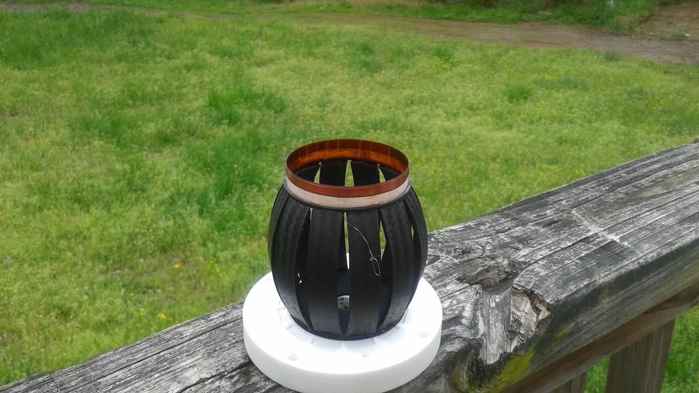

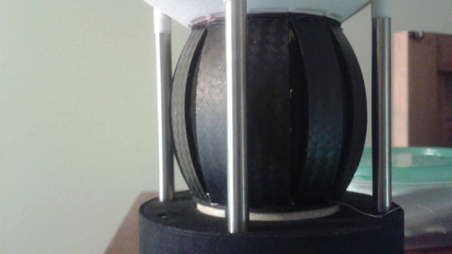

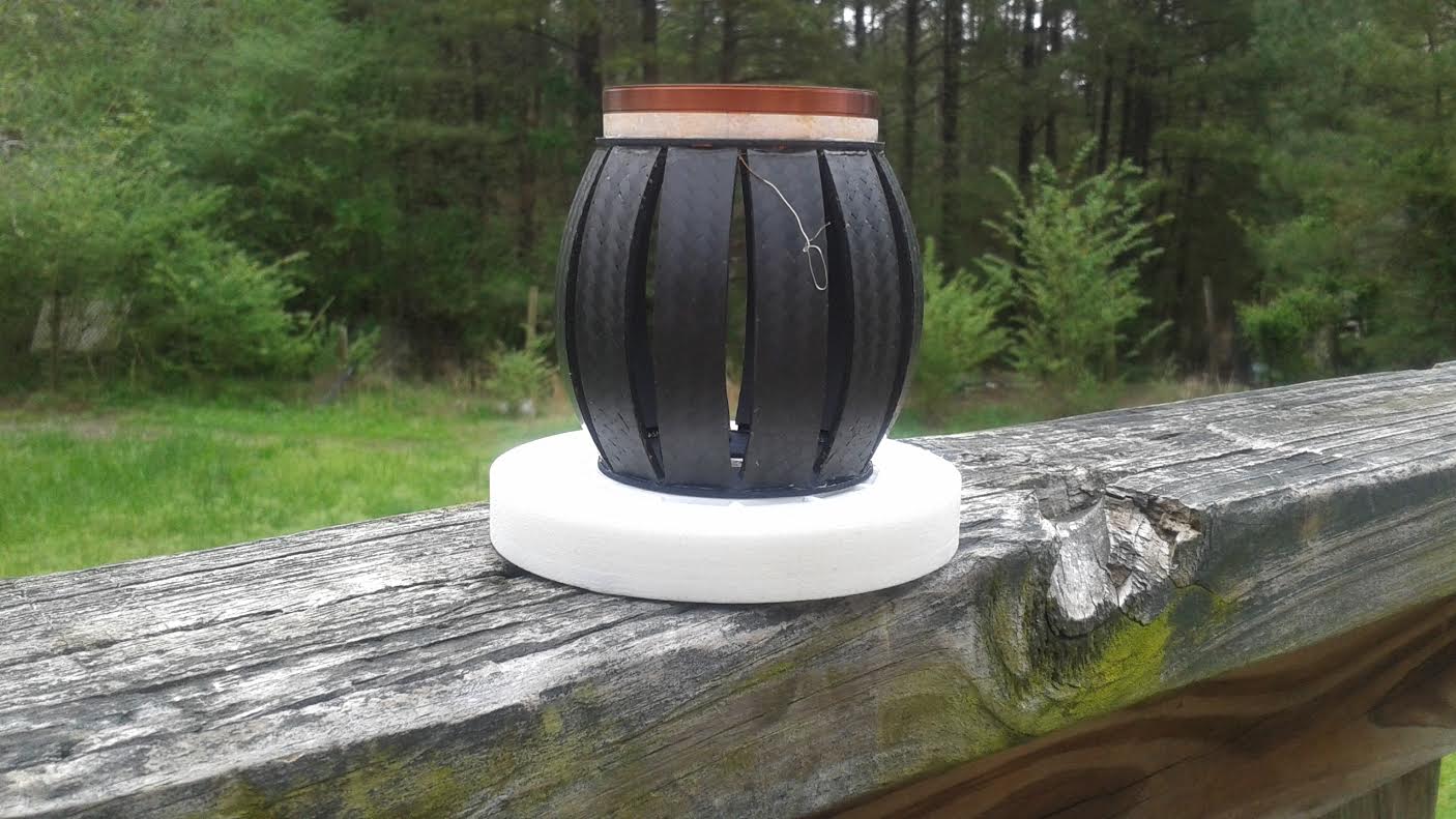

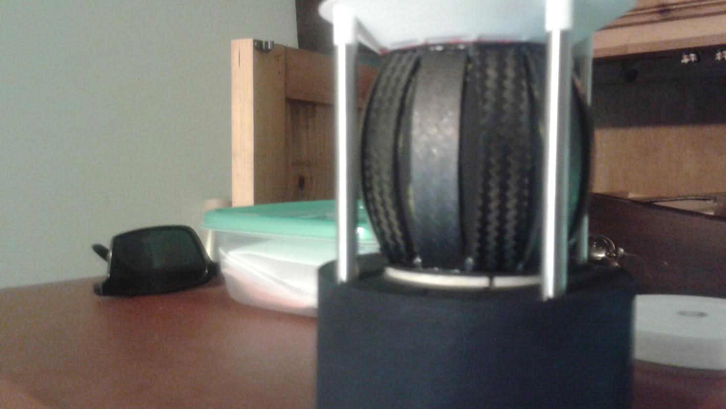

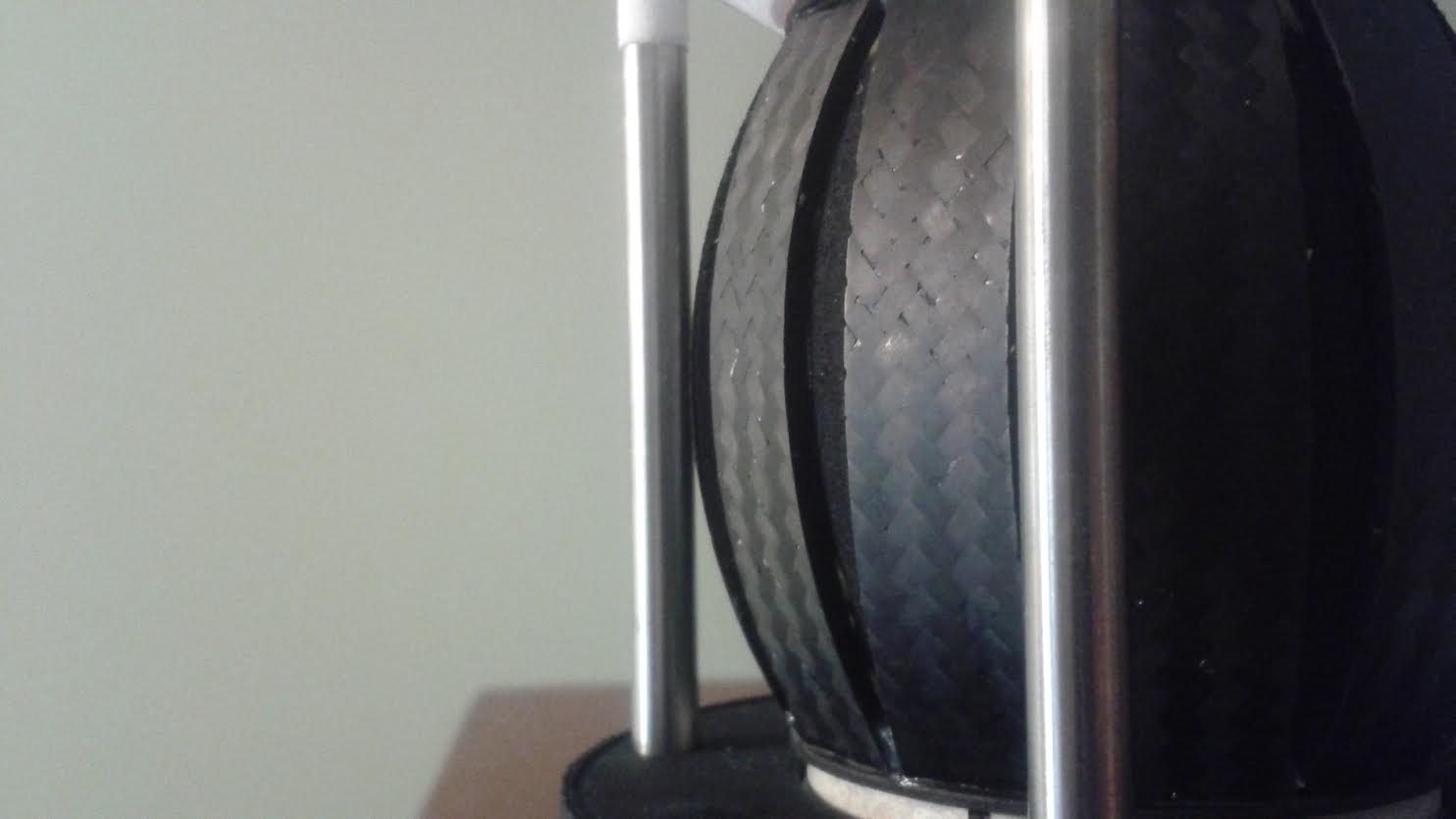

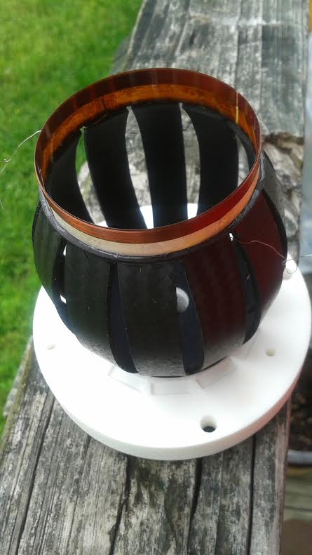

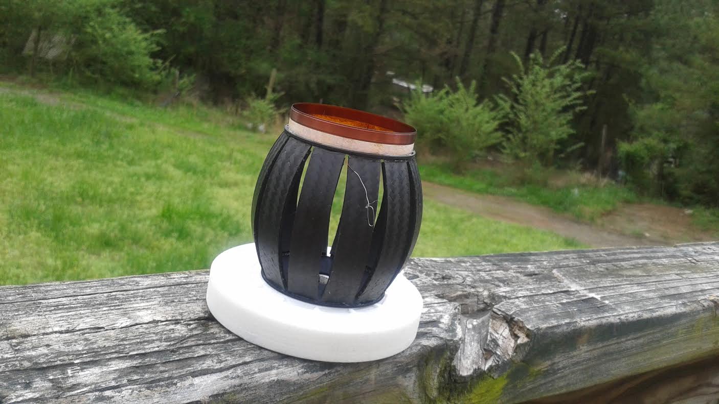

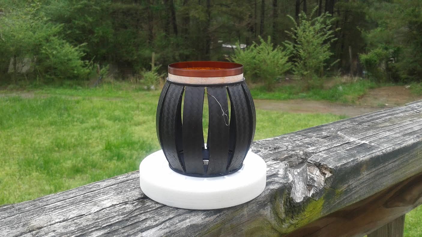

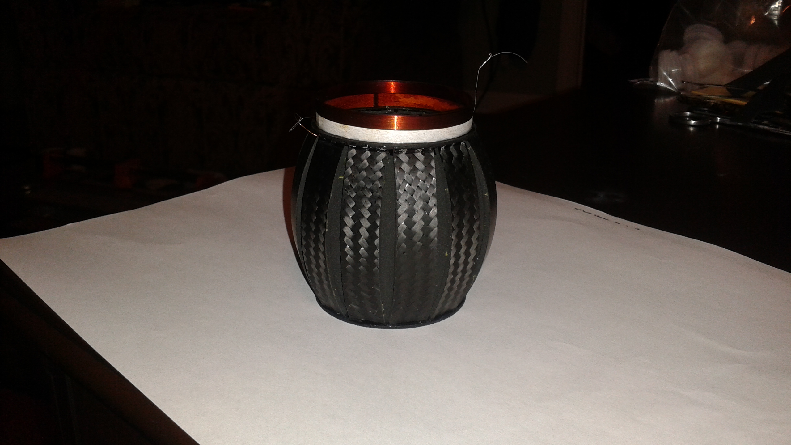

Head shots
This the closest I have come to making an mbl quality driver. This is due to a new found care and process route in laminates, cutting, craftsmanship, and rigs.. Take a look and tell me what you guys think. The inner sealer will be attached tonight.

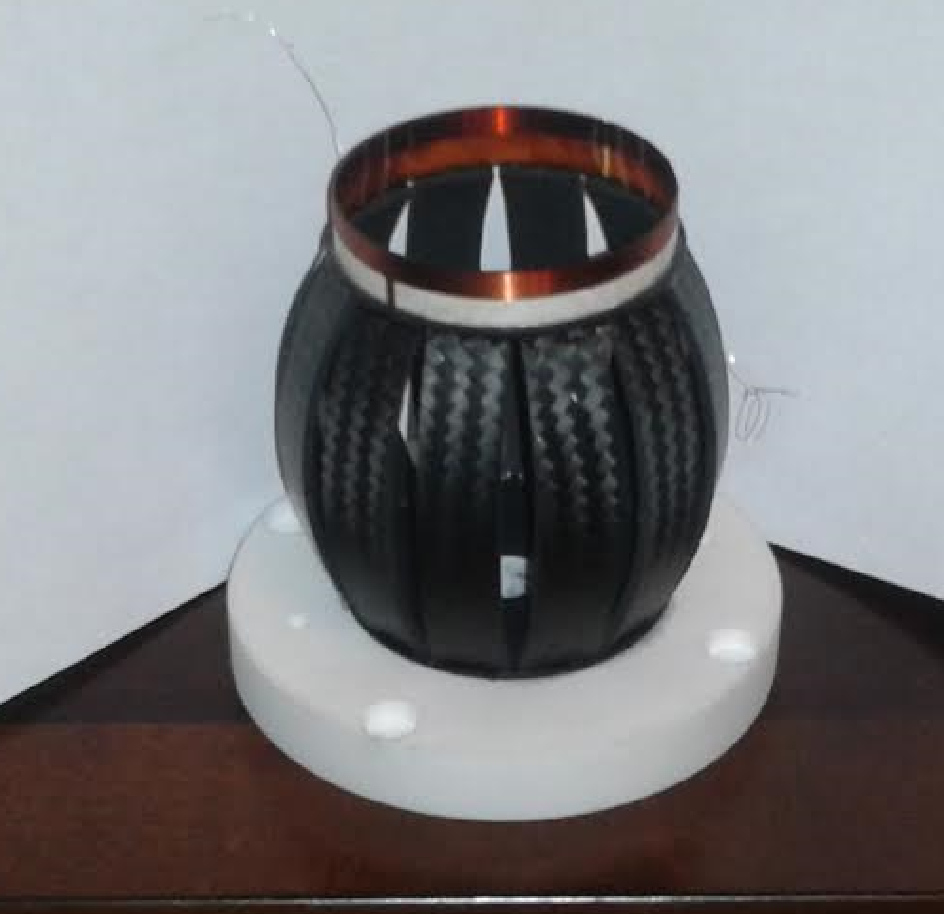

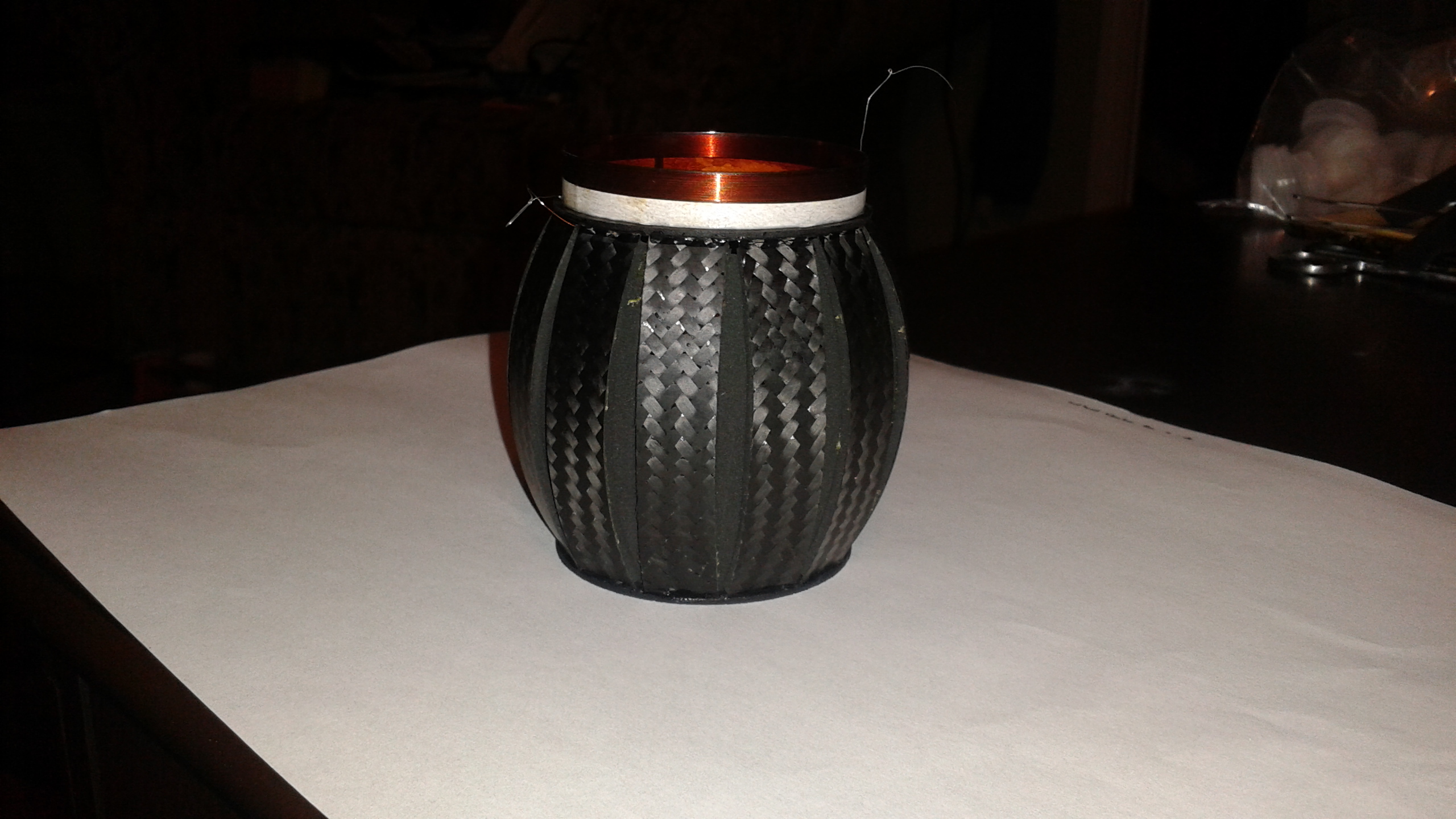

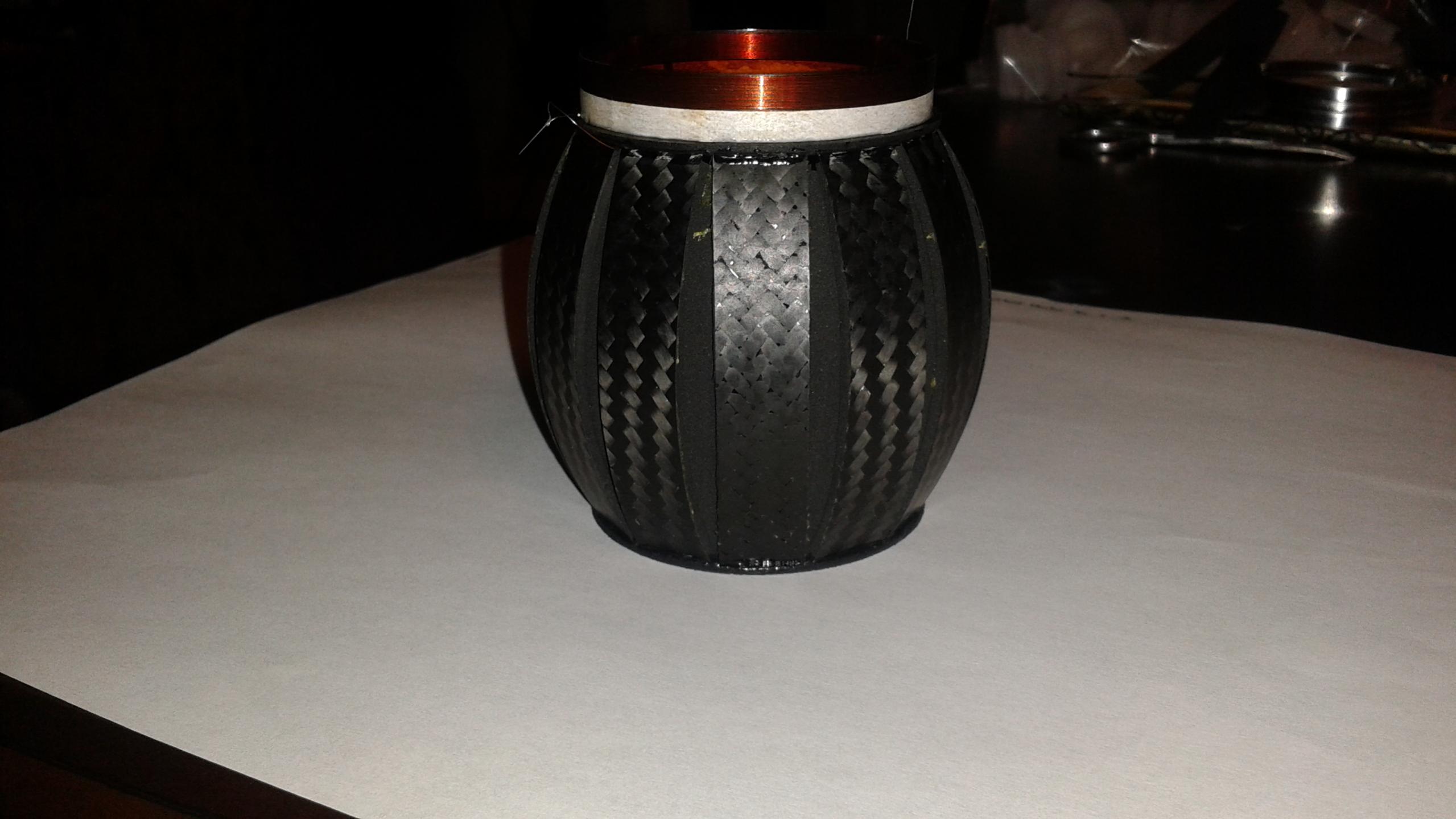

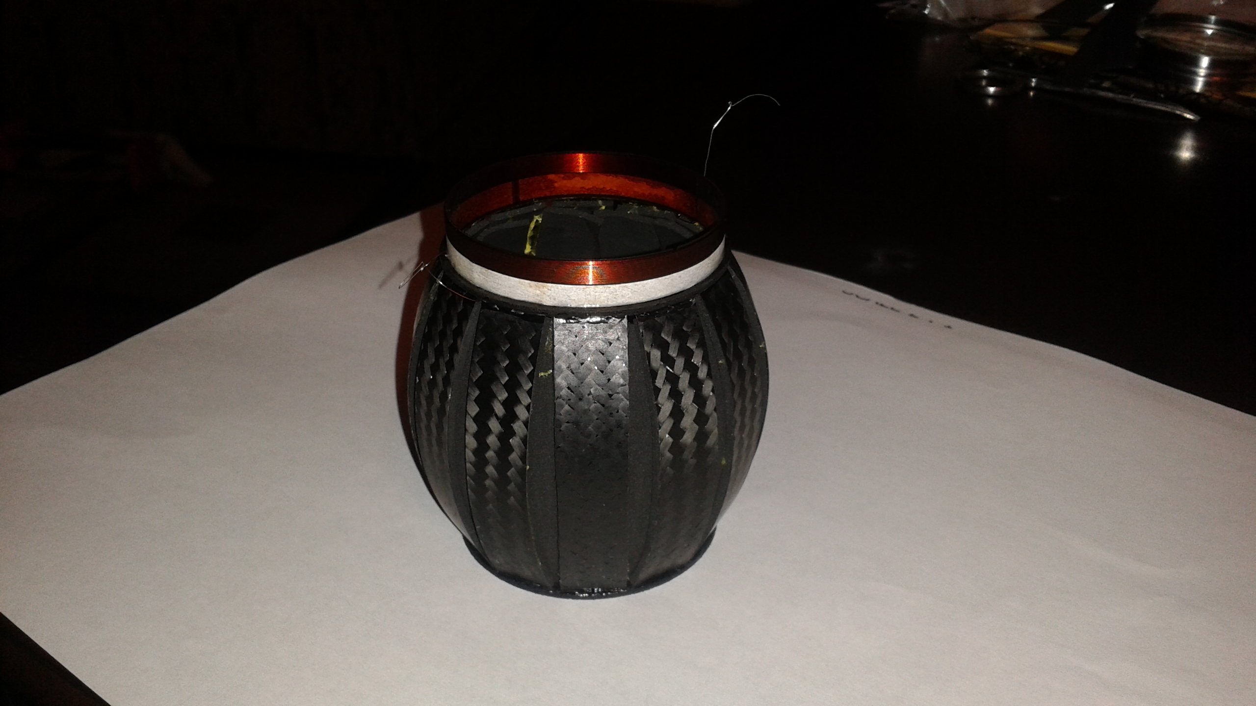

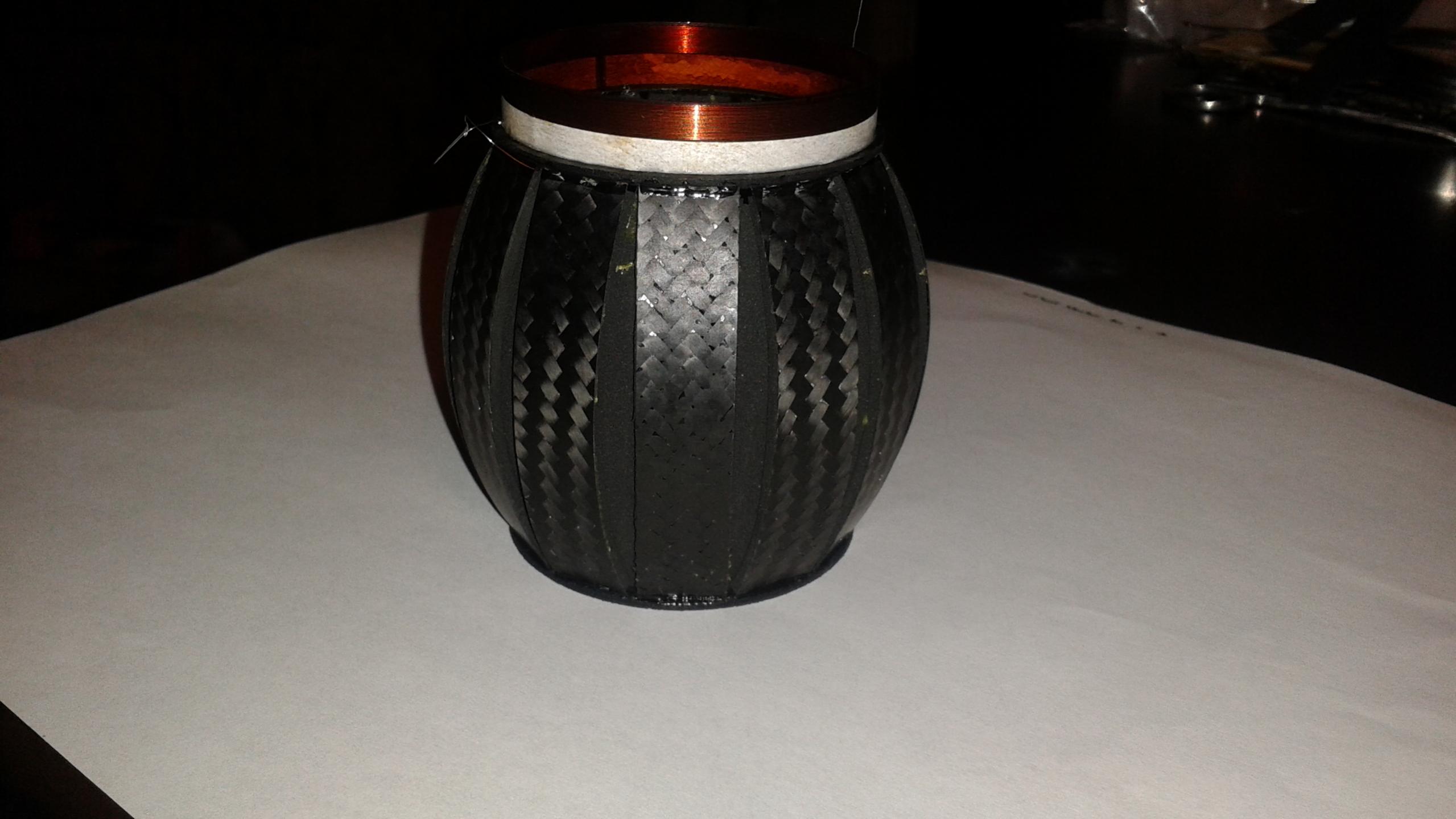

Inner sealer is put
The inner sealer is put I still need more practice on this matter but it turned out ok. Still needs final sealer and filler. Next time it will be ready and playing some tunes.

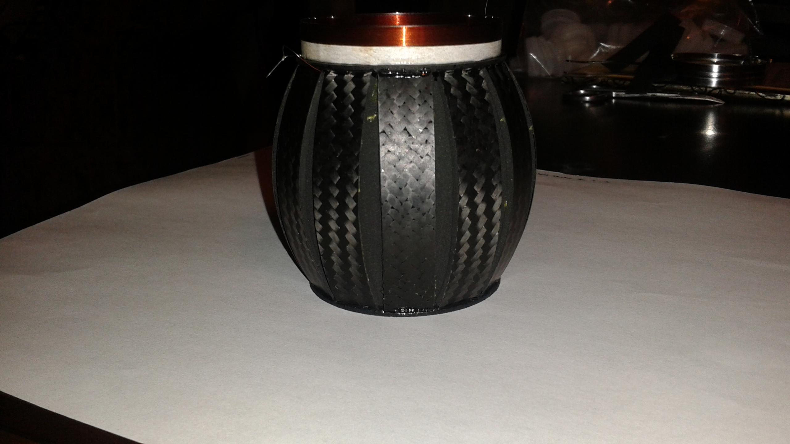

No I am not using infusion to make these laminates. I am just using a vacuum and a proper technique for the lay-up and post process. I really like the matt Finnish in these that matches the mbl look. This is due to using frekote as a release agent. This One I feel is pretty close to mbl quality I still need to work on a couple of things that if I decide to make another It will be simply for the purpose of making a perfect mbl quality driver. All others will be made for experimenting to achieve better than this control measurement.

This is the first speaker with no audible voice coil rub and buzz from any distance just clean sound a landmark which any builder of this speaker can be proud of. I will post videos later. Measurements will be done later when I get the stand made.
