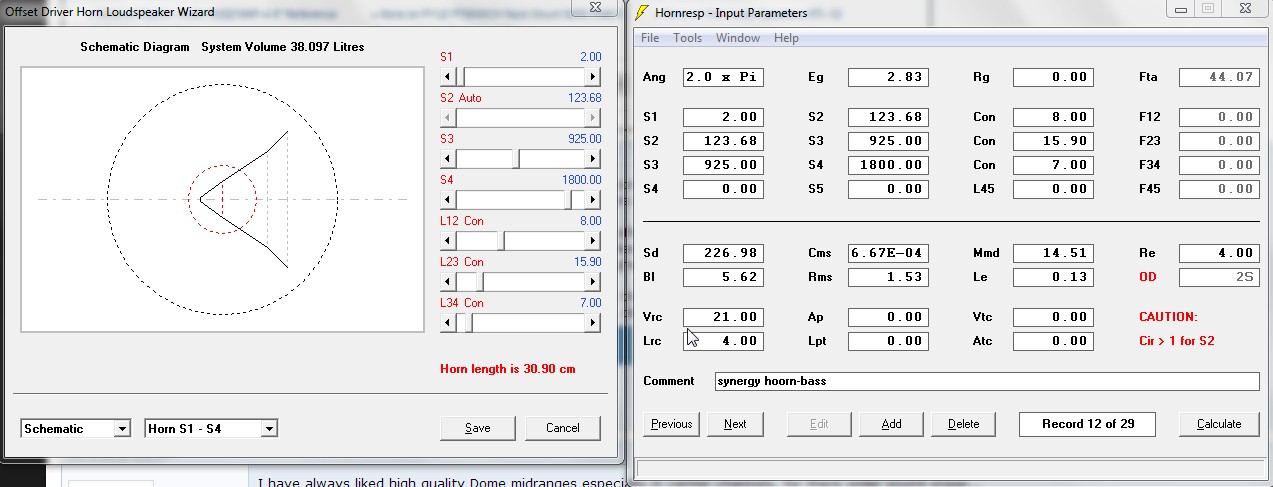

Thanks for the tip, I go looking there. I have here some sims with a beyma 3 inch, not expensive and do good, but I now I have first close the back of it measure and then input that data in hornresp for real sim.

ButI do learn this way the good things, I need to studie the sim better with hornresp and synergy horn.
Or maybe a nano mid? ;-)

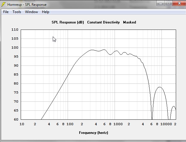

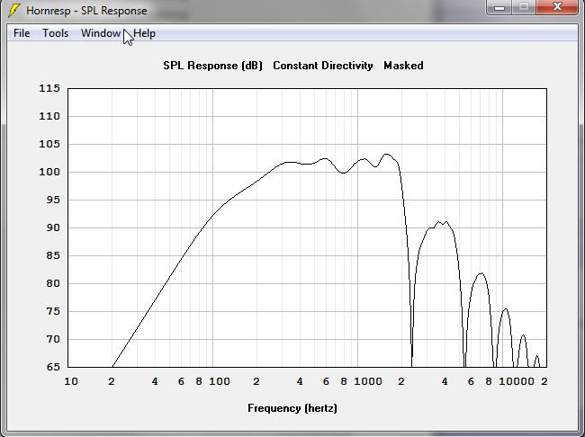

But serious, nowq i see why you guys have so much problems with reach of mid to high.
I change the 1.90 cm to 6 cm and see 1.800 Khz is just usable, with 4 cm I get to plus minus 2 khz or some higher.

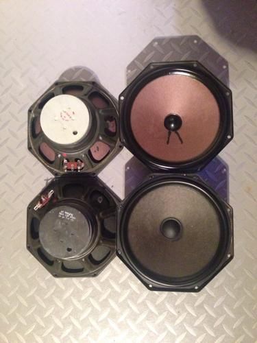

I have some old phillips speakers, two of them for the bass-mid.

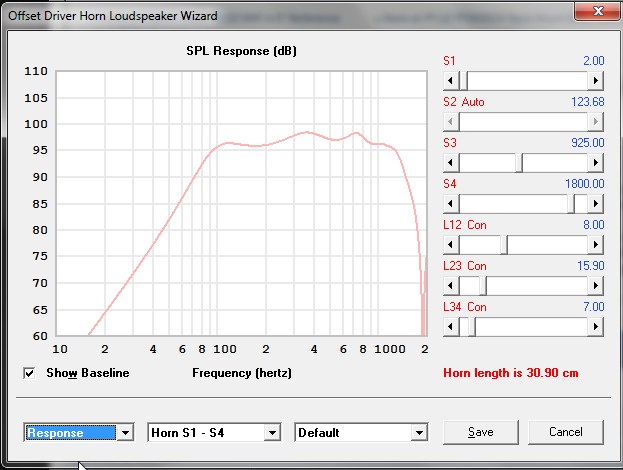

I think it looks good but I also thing I miss something, I do need als VTC/ATC for the sim?
The graph itselfs looks good, alost perfect for this 1970 AD8066 bas woofer of 50 watts, I do use two of them. The dome idea is ice, maybe a low FS dome mid speaker? these are lying around with FS of 400 hz.

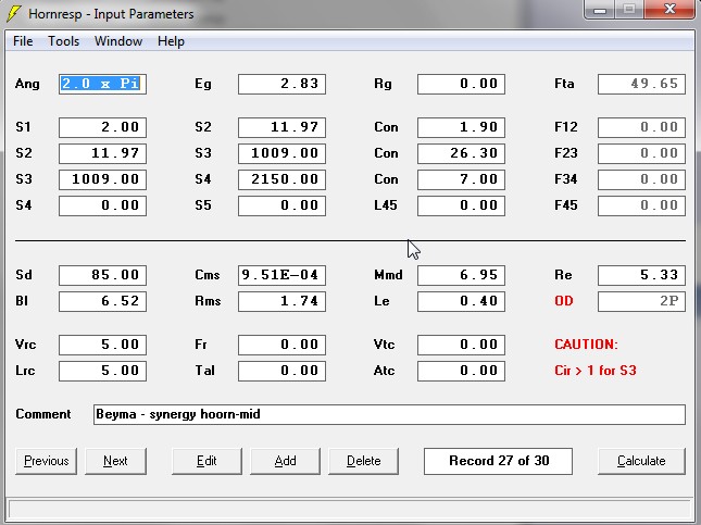

I do simulate synergy this moment, because it is raining here, that is netherlands euhh. Oke do I have to let S3-S4-S5 the same for all bands? like bass-high mid?
only S1 and S2 changes with speaker, I go search for horn resp inputs there are I think a lot of it.
I see just that the compression driver section has not offset driver in hornresp, the bass and mid do, this because the tweeter is on top? this way I see
that things get better.
