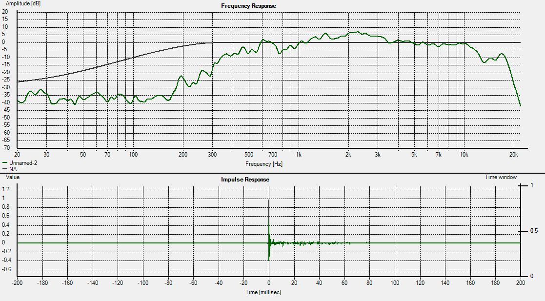

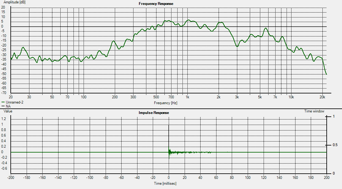

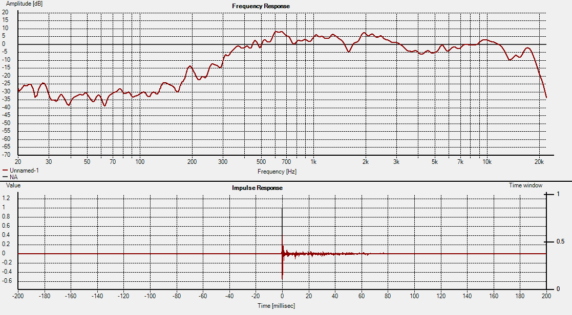

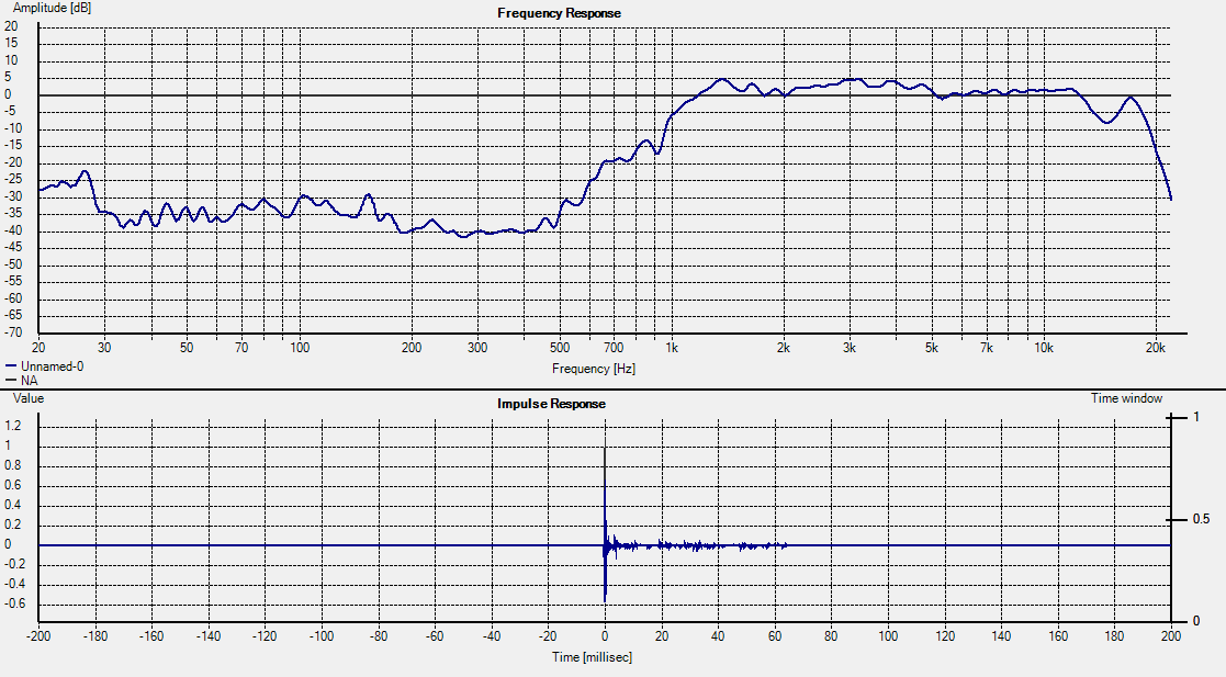

Here are some quick ( and not technical) measurements. This was done in living room, no mic stand, etc. Just a quick look at what I was listening to.
Measurements are as follow:
1. Just the CD in horn
2. The mids alone
3. CD crossed with 2.2mfd cap, mids fullrange, 1 small triangle of foam placed in horn behind the mid ports and before the CD .
I am just messing around with this build. I have plans to really build a Unity Horn at some point. I was thinking I could build a portable party speaker with this test unit? It does not sound bad right now.
Steve
