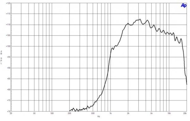

B&C DE5 response
B&C DE7 response
B&C DE250 response
(All three measurements on the B&C ME45 horn. First two are in conjunction with an adapter.)
Ya killin' me John 😉
B&C's own measurements indicate that the $44 DE5 has more output at 2khz than the DE250. The DE250 has about 3dB more output in the top octave. That's not a huge difference.
The HUGE difference is cost and weight; the DE250 is more expensive and much much larger.
In 80% of the cases, the DE250 is going to work better, but there are definitely some 'edge' cases where a DE5 will work rather awesomely. Particularly if space is a big issue (and for me, it definitely is.)

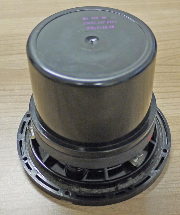

Do not now if these are still available. Phillips has old ones who are big for mid domes from the 70,s, see picture, it is just a thought.
Freq: 350-5000 Hz
Spreekspoel: 2 inch / 5 cm
Inbouwdiameter: 13,4 cm
Inbouwdiepte: 11 cm
Gewicht: 1042 gr

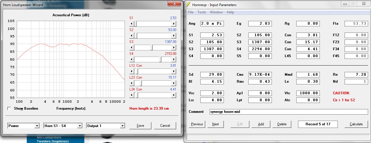

I have look at a akabak script, but this can easely be done with hornresp, just keep horn the same for all sections and move only L12 put S2 on automatic.
Get the ports right and go with that banana. Unfortanely the 60 x 60 can simmed but 60 x 90 I do not now.
Is this the right way? ;-).

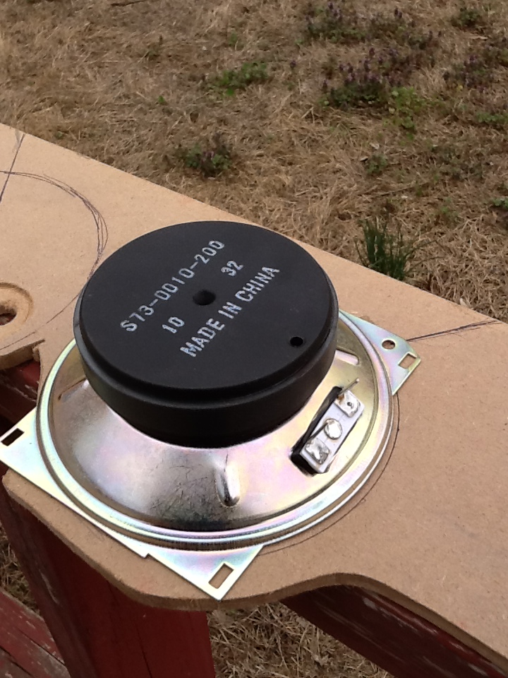

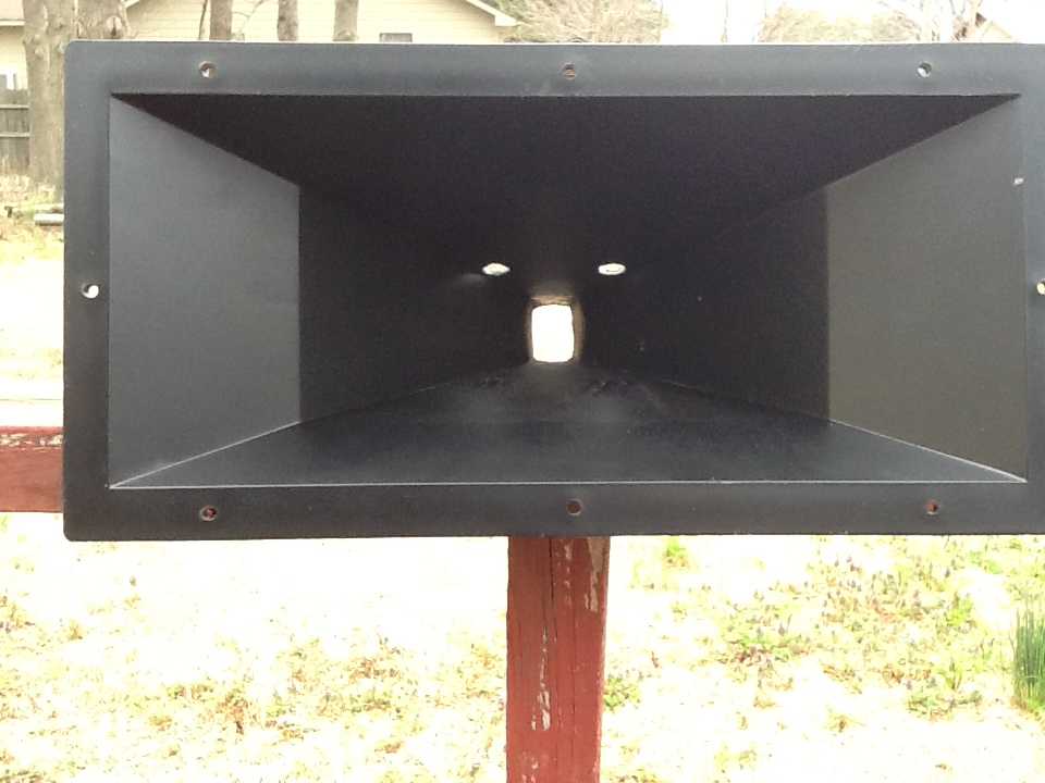

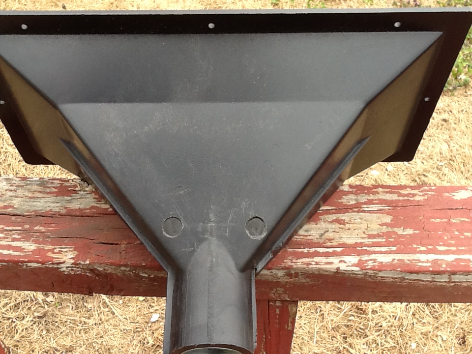

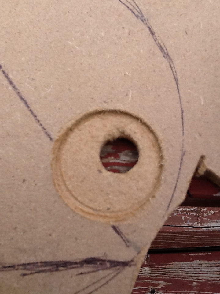

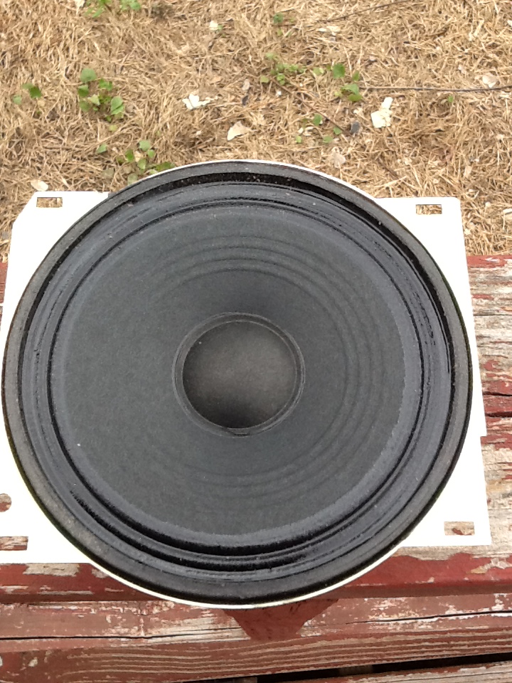

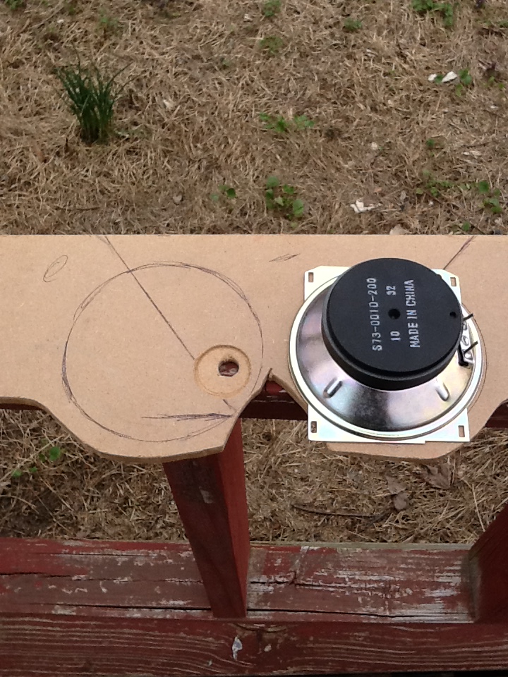

I figured I would dump random Unity horn build info in this thread. Nothing I am doing warrants another thread on the subject, and really this was most of where I have read about Unity Horn information.
Here is what I have going on:
B&C DE10: B&C DE10-8 1" Mylar Horn Compression Driver 8 Ohm 2-Bolt | 294-600
Cheap $5 Horn from MCM
Part Express buyout mids: 4" Paper Cone Sealed Back Midrange Speaker A0100008FP09IA | 289-135
So slap them together and it is actually not to bad sounding!
Not much math going on here. I tried to get the mids and CD as close as I could. The mids are not sealed very well, and the whole thing is just tossed together with hot glue right now. The mids have a FS of 900hz. I would like to coat the cones and try to lower the FS some.
