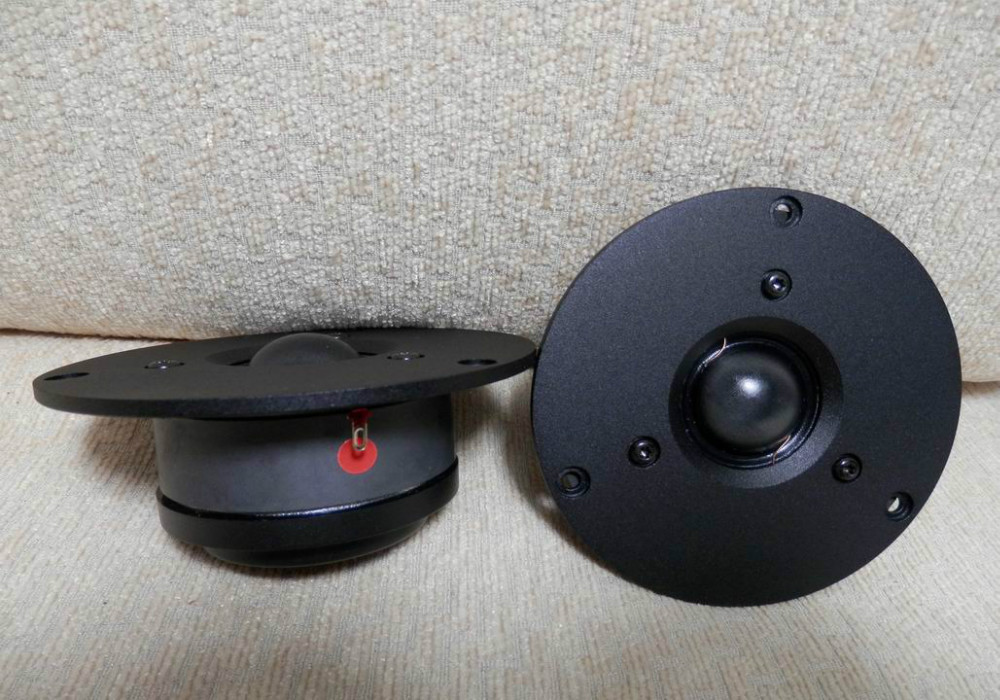

Now, that's a thought. Uses less space, that's an advantage. I don't know about the strength of the dome, will it survive?
We would need to find out how to couple it to the horn (kind of build your own pressure chamber). May be a simpel ring would work, could be a stepped tap shape. One ring on top of the horn to make it fit (as it is a dome, which needs some space not to touch the horn), then a smaller hole and again smaller tap opening both in the panel of the horn. So a 3 step tap. 🙄
Also, the synergy would always be a 3-way horn since the dome's don't go low enough, with 1", mid-range and low/mid.
500 Hz is not a frequency where you could cross a Tapped Horn with, would leave a gap of 300 - 350 Hz.
Will give less stress to the 1" CD. 😀
It is a way to go, but needs much work.

What would be the advantage of going that route?
From various musings here and elsewhere, there seems to be a real demand for a smaller, home 'hi-Fi' version of a synergy.......one where extreme efficiency and power handling wouldn't be a priority. Combining for dome mids such as the RS52 from Dayton would still provide substantial efficiency and power handling with extension to 300hz and 3khz likely.
Sure, diffraction might be an issue with the HF driver radiating against the exposed dome grilles, but there's mechanical ways of reducing the destructive interference. Would trying out the theory with a sheet of plywood and an already owned 1" horn reduced to the throat?.....I say most definately. The JBL M2 waveguide shows us that there's more than one way to create a suitable guide.

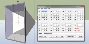

Here's the 1" thick material I plan to use (as shown around the horn mouth) to absorb sound diffraction: Echo Eliminator
hulkss, I'm going to attempt a build very similar to yours and I'm still trying to make up my mind about the size of the horns and the use of a secondary flare to avoid midrange beaming. I want them to maintain proper directivity down to 300 Hz, but don't want a horn that's 41" wide! I have two questions for you, if you'd be so kind:
1) I noticed that in your spreadsheet you've used 500 Hz as the lower limit for your horn, although it seems you're intending to have the midranges reach down to 300 Hz. The use of 500Hz clearly produces a smaller horn. Am I correct in assuming that this is because you going to use Hughes' method involving foam/cotton instead of the second flare?
2) I saw in Hughes' whitepaper that "Many types of acoustical foam were tried", but he doesn't specify what thickness or density he finally arrived at. How/why did you choose this cotton material, and what's guiding your choice regarding the horn size and the proportion that will be lined with this material?
1. I intend to put the horn in a baffle board that will effectively extend its low frequency capability some. The response will be -6db at the lower crossover frequency.
2. The cotton material has better acoustic properties and will work well in a home setting. Hughes was designing a pro-audio product that has additional requirements for durability, resistance to moisture, etc.

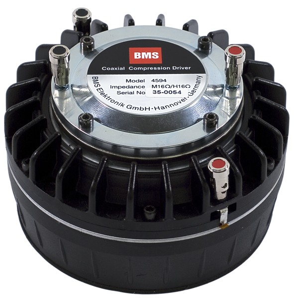

I started my Synergy horn project as a backup solution while I was waiting literally years for other solutions I had ordered. The first was a set of three SEOS24 horns with BMS 4594 coaxial drivers. The second was a new Synergy horn from Red Spade Audio.
The SEOS horns amazingly just arrived in the mail (the large ones).
Link: Horns
The Red Spade project is now looking like it will happen too:
Link: Red Spade Audio: PSE-144 dispersion
Not sure when I'll get around to building my own horns now. :scratch:
