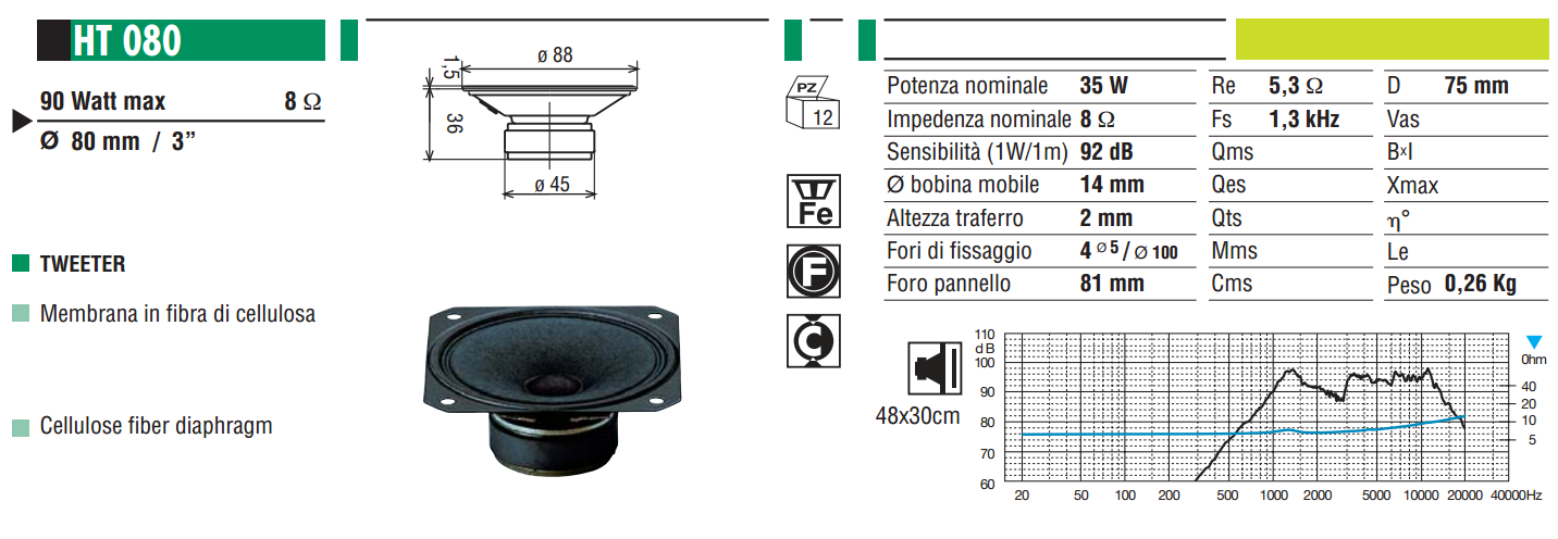

I've been doing some T/S measurements on the Ciare HT-080 and the Visaton M10-8 and so far it doesn't look very promising, for the Visaton at least. With the Ciare I'm having som trouble measuring the -6dB points due to its almost resisitive impedance charateristics.
/Thomas
/Thomas
I'm calculating the T/S parameters from ESP:
Measuring Loudspeaker Driver Parameters
Can anyone recomend an alternative approach/method to the -6dB volltage?
/Thomas

I've been trying to do some T/S measurements on the Ciare HT080, but its almost non-exixting impedance peak makes it close to impossible to get the -6bB (or even -3dB) points.
The other candidate (Visaton M10-8) is not looking too primising, sadly!
