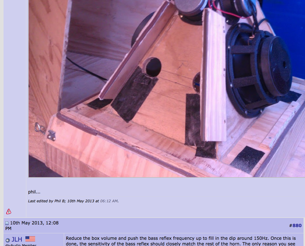

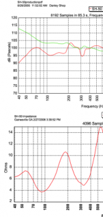

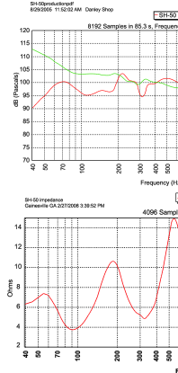

Two of the four ports are visible in the shadows to the right and left of the upper coil.Take this picture and show me exactly what you mean. What port are you talking about?
The proximity of the wood blocks right and left of the coil to the port probably would lower Fb somewhat compared to the 3/4" depth round cutouts without them, though that sort of "ducting" would be hard to simulate.
At any rate, the the SH-50 Fb looks to be around 80 Hz, resulting in a frequency response "bump" centering at 70 Hz.
The distance from the woofer to the port is irrelevant because as soon as the woofer moves, the entire enclosure is pressurized and the sound emits out of the port. This is very much like a syringe. It doesn’t matter how far away the plunger is from the syringe exit, as soon as the plunger moves forward the fluid begins to exit the syringe. Air is compressible, but for all practical purposes the effect is instantaneous.

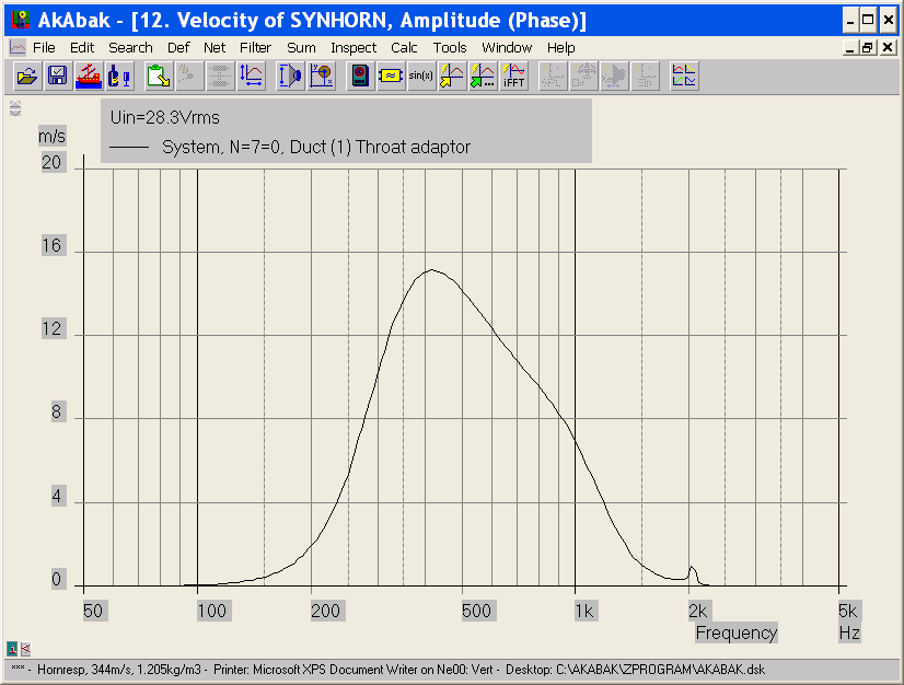

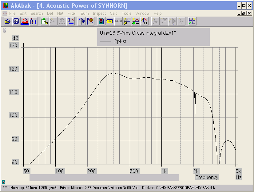

A short update on the Synergy mids I'm working with (AuraSound 2").
I've done some more modeling in Akabak and read a bit more about port noise and harmonic distortion. The port edges need a slight edge radius, about 15-20% of port diameter. The end conditions should be symmetrical to avoid harmonic distortion as the direction of airflow reverses.

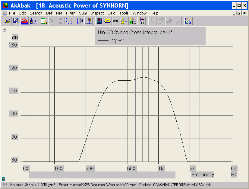

Here is the frequency response unfiltered, and then filtered with a bandpass filter to achieve a -6 dB crossover point at 300 and 1200 Hz:

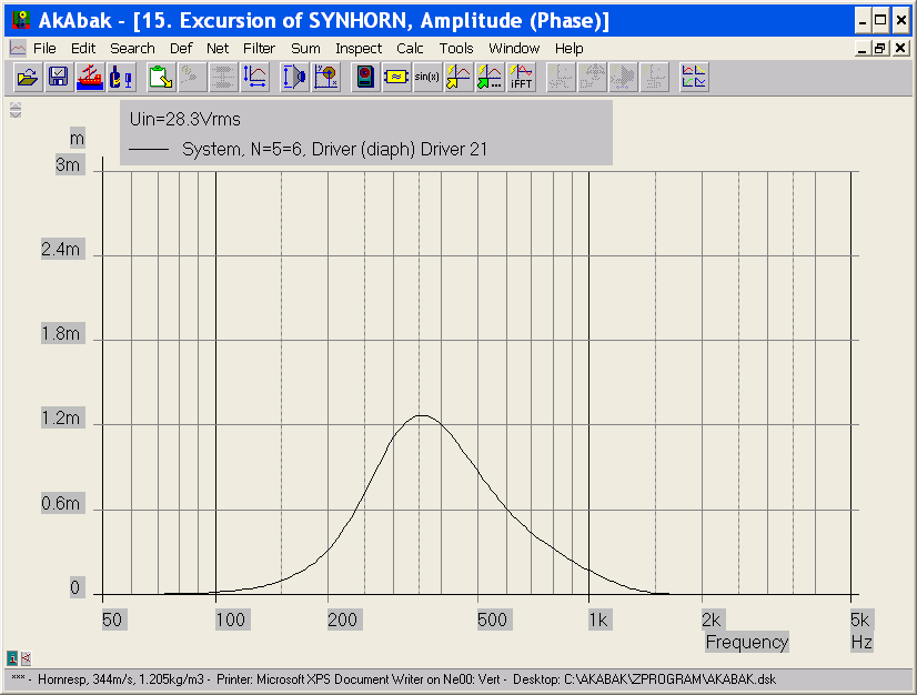

Here are the speaker diaphragm displacement and port velocity curves (with the bandpass filter):

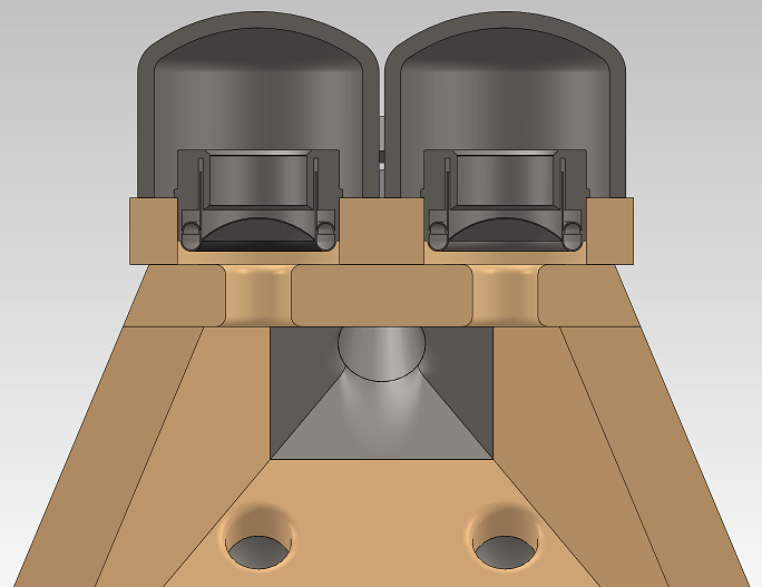

Here is a cross-section through two of the drivers showing the design as currently planned:
I guess the next step will be to build a simple tuning test rig with the driver, rear chamber, front chamber, and port to verify the tuning resonant frequency.
The frequency of the box/port system resonance, Fb, is determined by the length and diameter of the duct, the internal volume of the enclosure, and the speed of sound in air.
The port output is phase inverted from the back wave of the speaker, the inversion brings it in phase with the front wave (lagging by one wave period) reinforcing the front wave.
The SH-50 Fb is around 80 Hz, speed of sound is 1130 feet per second, 1130/80=14.125 foot wavelength.
Within 1/4 wavelength, sound waves reinforce, 14.125/4=3.53 feet.
The SH-50 horn path is less than 2 feet, regardless of the port placement in the horn, the port output is within 1/4 wavelength (one wave period behind) of the speaker's direct output.

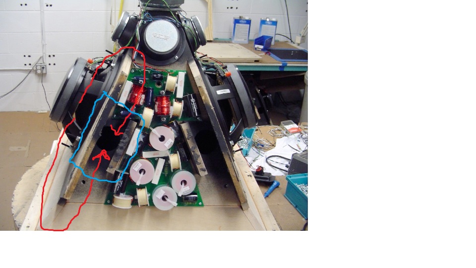

please see the attached picture,
What I mean is the path from the driver to the low(rear) port has to follow the red lines.
I believe the blue marked square area, or maybe a larger area between the dividers form part of the the actual bassport, not only the small holes which enter the hornwall.
Hopes this makes sense.
greetings,
Kees

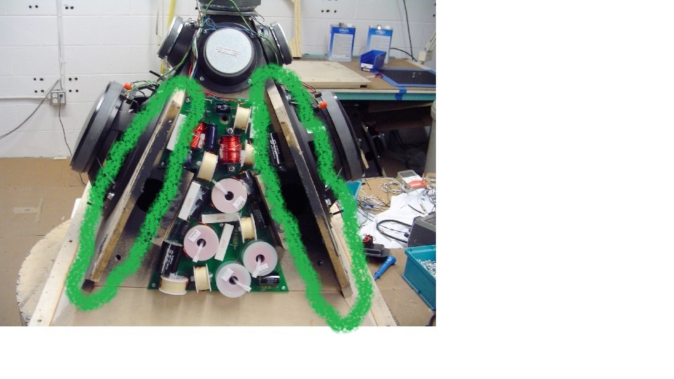

The pieces between the crossover board and the horn wall do not look like they are tall enough to contact the rear cover to form a duct/port tunnel. Those pieces look they are there for bracing the horn.
...I mean the green cirkeled ones, they definately touch the wall, the outer cabinet is attachted to it with some screws.

Yes, the green circled ones do touch the outer cabinet walls, but those would not create a port. The only port in the SH-50 is the diameter of the hole and the thickness of the plywood.
The hole and the thickness of the plywood are the only port exit, but the proximity of the port to the exterior sidewalls and the green and red circled parts all would affect tuning.Yes, the green circled ones do touch the outer cabinet walls, but those would not create a port. The only port in the SH-50 is the diameter of the hole and the thickness of the plywood.
The Fb as built would be lower than if the port holes were moved to where the inductors are.
That`s what i was trying to figure out. Thank You ...
