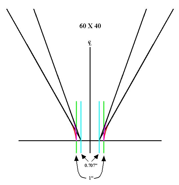

It’s best to draw out your horn throat and take a ruler to measure it. This way you can be sure what the actual flare rate will be. When you machine out the throat to 1" in diameter, you in effect decrease the flare rate. The throat becomes more like an exponential contour. See attached diagram. Measure the length it takes to go from 5.07cm^2 to 10.14cm^2. For a 60 X 40 horn this should be on the order of about 1300Hz.
I'll try to explain what I was getting at with the Summa reference. I understand the reasoning that the comp driver won't exert any pressure on the horn walls once its output is past the point in the horn where the circumference is greater than the wavelength of the lowest freq we want to achieve (1200hz in your example). This makes sense since as you've been hammering home the conical horn has a variable flare rate.
Where my confusion lies is with e.g. the Summa's 15" waveguide. From pictures I'd say that 15" includes the radius transition to the baffle. Taking a guess, the radius begins where the waveguide is about 10-12" in diameter. For the Summa to hit 900hz, we're looking at a circumference of about 15", which is a diameter of 4.8". Obviously Earl's waveguides are much bigger than this (4.8" dia), to control the directivity to match a woofer at the xo. It stands to reason in my mind then that the compression driver in the Summa is exerting some pressure on the waveguide walls past the 15" circumference, otherwise it wouldn't need to be as large as it is. I also understand that the radius to the baffle helps control directivity at the low end to prevent waist-banding the polar pattern there, contributing to the larger size.
Drawing that line of reasoning to the Synergy horn, it seems to me that the horn will be constraining the comp driver's directivity past the area where the flare rate no longer loads the device (a catch-22 to your line of reasoning, I know). This would be the region where we are tapping the mids in, and I wonder if at off axis angles approaching the horn wall angle (for a 60x60 then we would say 30°) if the comp driver would in fact "see" the mid ports? Or does the fact that we are using square horns here mitigate that effect like you say? Or is comparing one of Earl's waveguides to a conical horn comparing apples to oranges?
If that isn't clear as mud I'll make some drawings

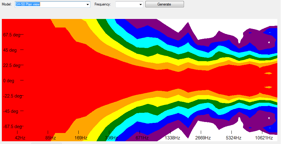

Here is a full 30Hz to 15Khz map view of the horizontal pattern of an SH-50 which is a large 3 way Synergy horn with mid drivers similar to the Unity horn Nick sold. This is 3 dB per division, taken from the clf data which is averaged to 1/3 oct smoothing.

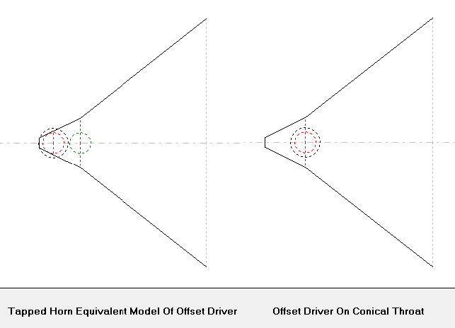

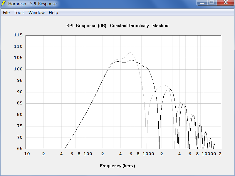

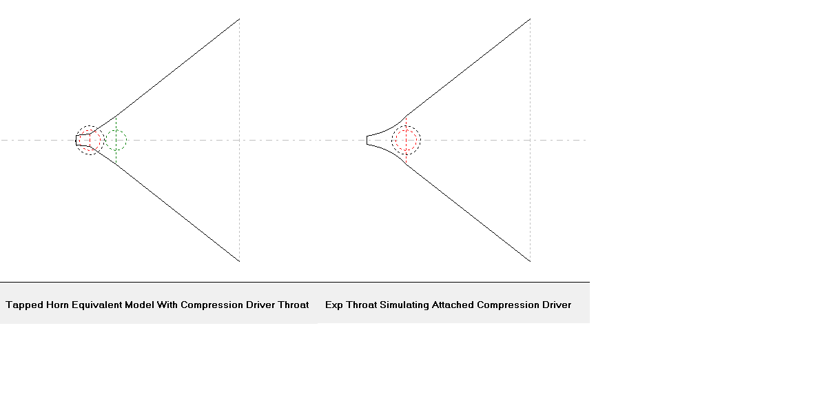

I spent some time working with Hornresp to get an idea if I could improve on some of the midrange simulation accuracy issues and questions that have been posted. The first issue I studied is the throat reflection cancellation that affects the midrange response. The reflection cancellation notch occurs at one-quarter wavelength frequency (throat to midrange port distance) only if the horn throat is a cylindrical tube. A conical horn has an effective reflection length significantly shorter than a cylinder. I’ll assume this behavior in Hornresp is real and correct. It's likely an effect caused by the reflection wavelength being more than ten times longer than the throat diameter.

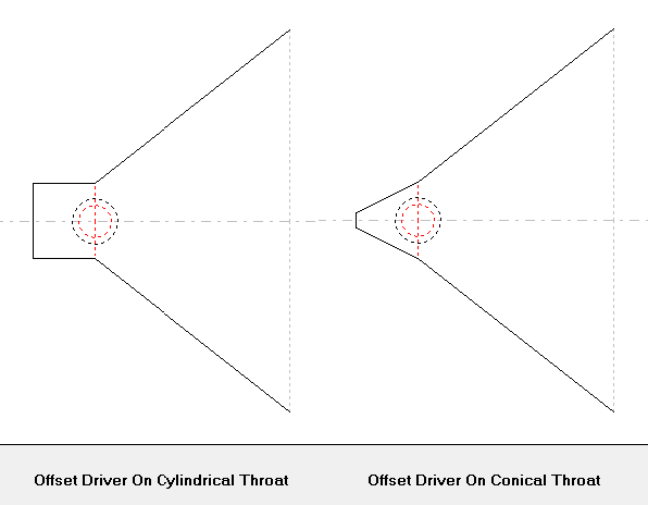

Here is a comparison with the port entrance on a plane 7.82 cm down the horn axis. The reflection notch frequency shifts dramatically yet the port axial location is the same. In the cylindrical case it is right on the quarter wave distance frequency of 1100 Hz.
The horn throat adapter that is built into to a typical compression driver should be included as part of the horn model to correctly model the reflection. I used some trickery with a Tapped Horn model to study this. I blocked the front of the driver with a tiny long port (.01 area 10000 cm long) and set the front chamber to match the rear chamber volume and size for an offset driver. In this model, there is essentially no output from the front side of the Tapped Horn driver, the front chamber is acting as a rear sealed chamber. The tapped horn driver enters the horn out the rear side at S3.
I tested this trick by comparing the Tapped Horn model to an Offset Driver model with the same geometry.
The output is nearly identical (tapped output is gray), so this trick works OK. Now S2 can be set in the Tapped Horn model to match the compression driver throat exit area. The Tapped Horn model below includes the compression driver attached to the horn (S1 - S2). The Offset Driver model has the first horn section set to exponential and S1 reduced a little to provide a closer match in geometry and response.
I now believe I have a method to get the first reflection cancellation notch correct with an offset driver model. It would be a great improvement if Hornresp allowed the offset driver port entrance to be located at S3.
In part 3 I’ll look at the midrange port response.

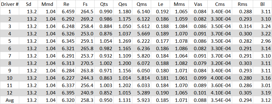

The heart of the Synergy Horn design is centered on the midrange drivers. After reviewing Bill Waslo’s work: DIY Synergy it became apparent to me that a small midrange driver just might be the best solution. I do want to be able to reach 120 dB at one meter with a lower crossover frequency (-6 dB) of 300 Hz.
I began searching for a small (about 50mm) driver with attributes suited for this application. I found a candidate driver with a concave diaphragm and a large perimeter voice coil. It is built like a compression driver in many ways.
Some info about this little driver:
Specifications: Specs
Driver Patent: Patent
AuraSound White Paper: NRT
I found these rear enclosure 2” caps: Caps
I noticed Siegfried Linkwitz uses them so without much more thought I bought a dozen drivers and measured their performance parameters. I assumed Sd (effective piston area) and Mmd (moving mass) to be correct as published. Will they work in a Synergy Horn?

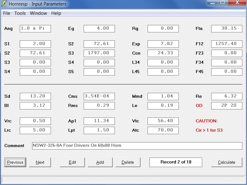

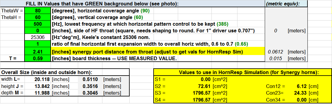

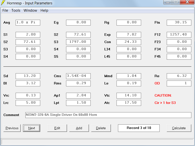

I’m going to design a 60x80 degree horn sized to match the overall width of a mid-bass horn that I have (24.25 inches). I plan to use the method published by Hughes to reduce horn mouth diffraction effects (absorbing material). I’ll leave one inch of wall thickness for that near the mouth. Here are the values from SynergyCalc V5.
Entering 0 for “side of HF throat” brings the horn horizontal and vertical sides to the same apex point. Entering 1 for “ratio” eliminates the mouth flare. At S2 the horn throat has an area to support crossover down to 1142 Hz (1 wavelength circumference of same area circle). The horn will be truncated 1.0 cm from the apex to mount the compression driver. At this location a "Quadratic Throat" will be matched to the B&C DE250 compression driver exit (14 degree total cone angle).
The compression driver has a throat adapter 27 mm long. When this length is added to the horn throat (6.12 - 1.0 + 2.7 = 7.82 cm total), the exponential flare cutoff frequency is 1143 Hz.
I then reduced the S1 area from the actual 2.77 cm^2 to 2.0 cm^2 to correct the throat reflection frequency (method posted earlier).

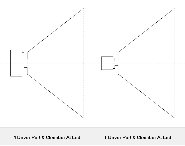

Here are the Hornresp inputs for one and four offset driver models:

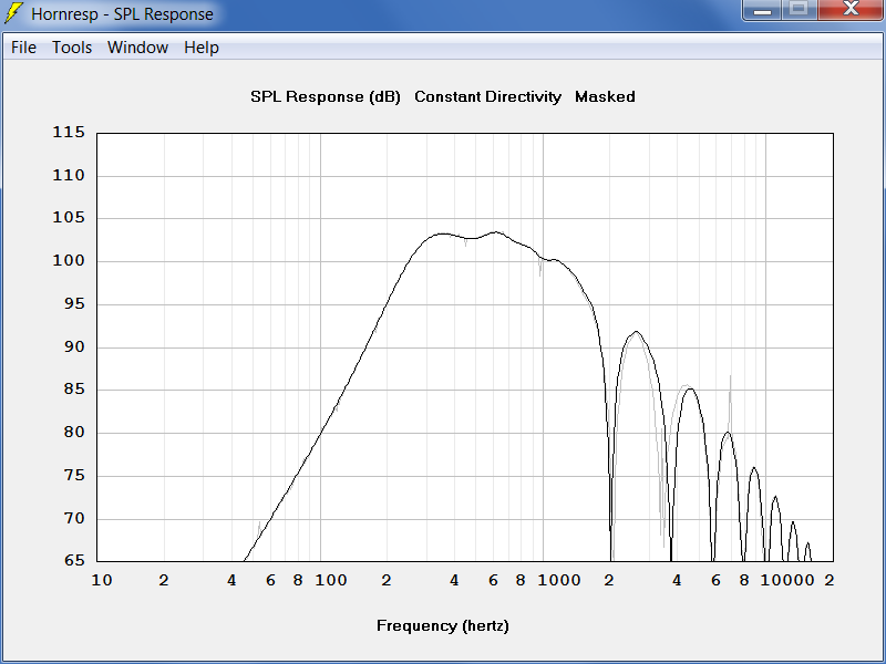

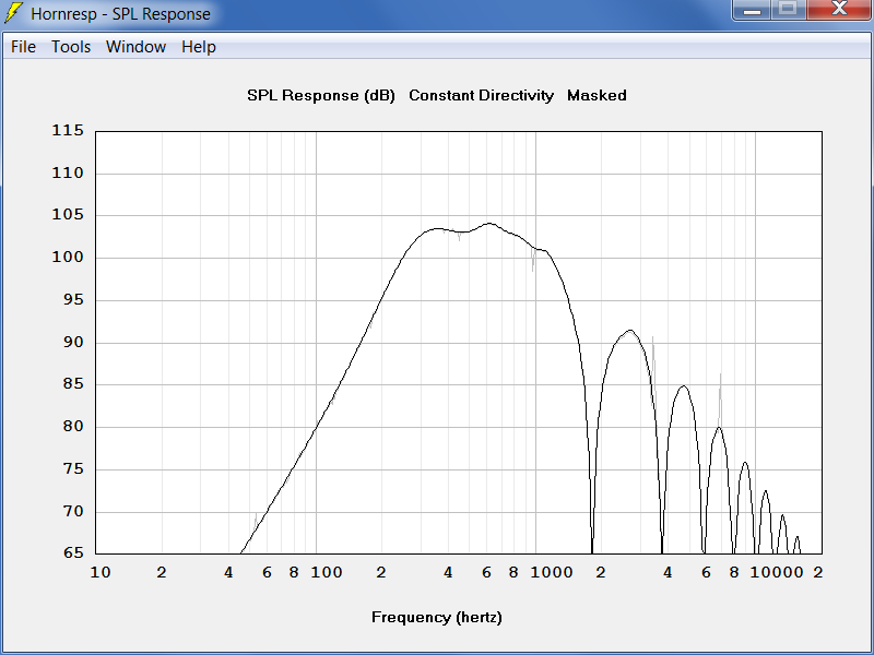

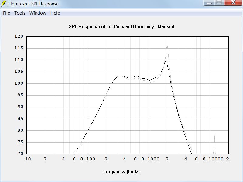

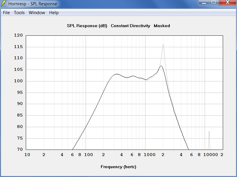

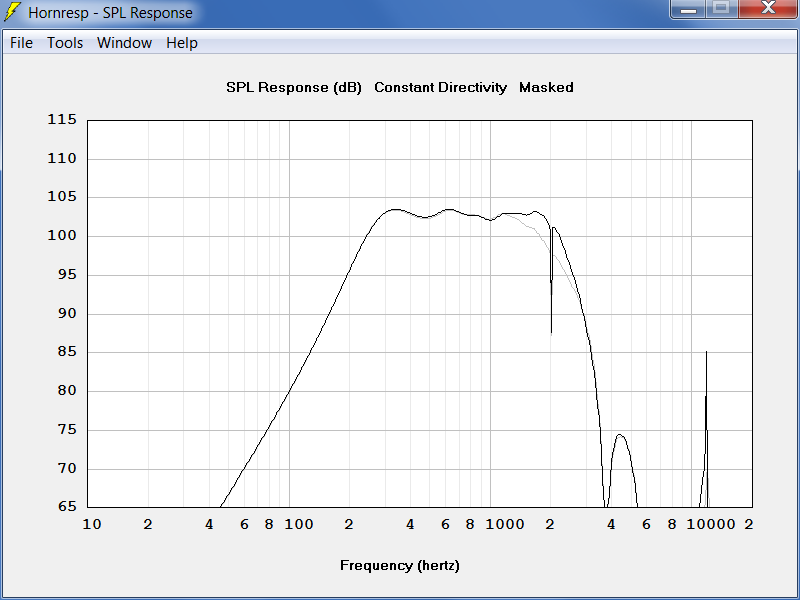

Here is the frequency response for both single and four driver models. I assume the actual response will be between the two results (4 driver response is gray).

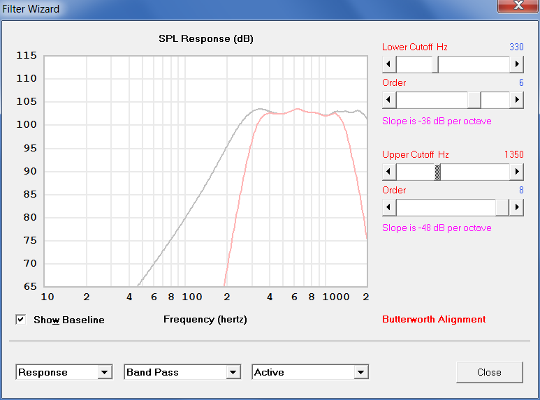

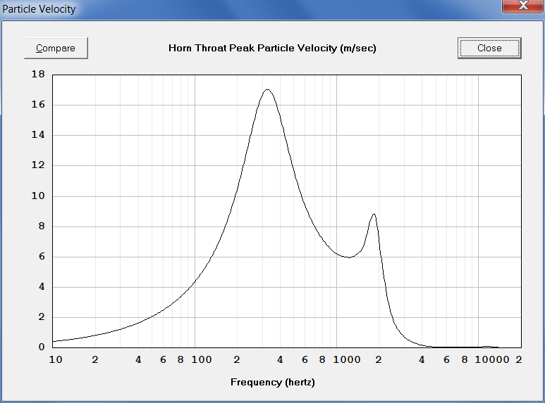

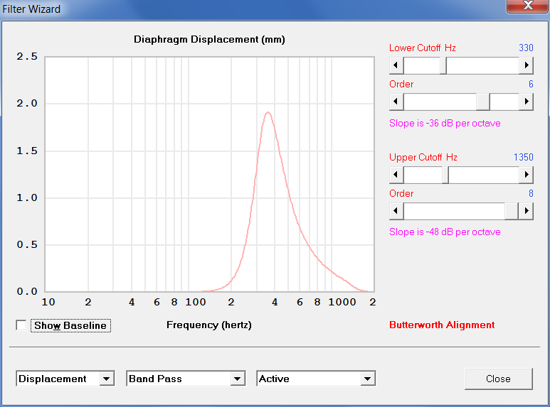

I raised the voltage (Eg) to reach 120 dB. It took an easy 28.3 volts (100 watts into 8 ohms). The drivers together are rated for 240 watts peak. The response was then bandpass filtered and checked for displacement and particle velocity.
Here is the diaphragm displacement and port particle velocity @ 120 dB when filtered to -6dB at 300 Hz.
The recommended upper limit for port velocity is 17 m/s and that is what we have at 120 dB. The peak at 2 kHz will get zapped by the crossover filter (-6 dB at 1200 Hz) and the 1/4 wave throat reflection notch. Looks like we're good to go. Can the above dimensions be built in a practical design?
In part 6 I'll take a stab at the design with SolidWorks.

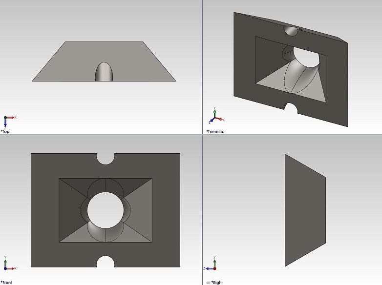

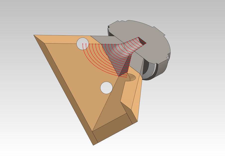

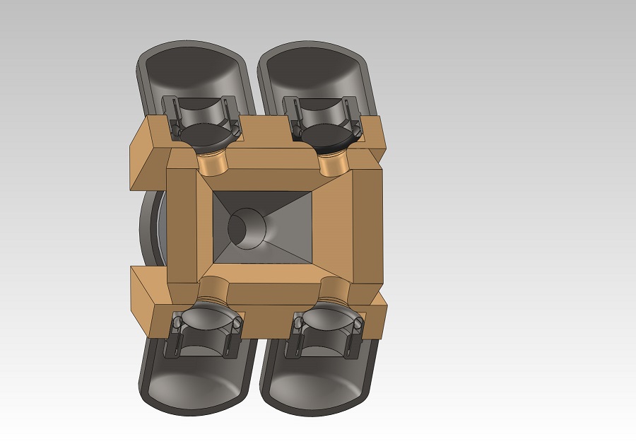

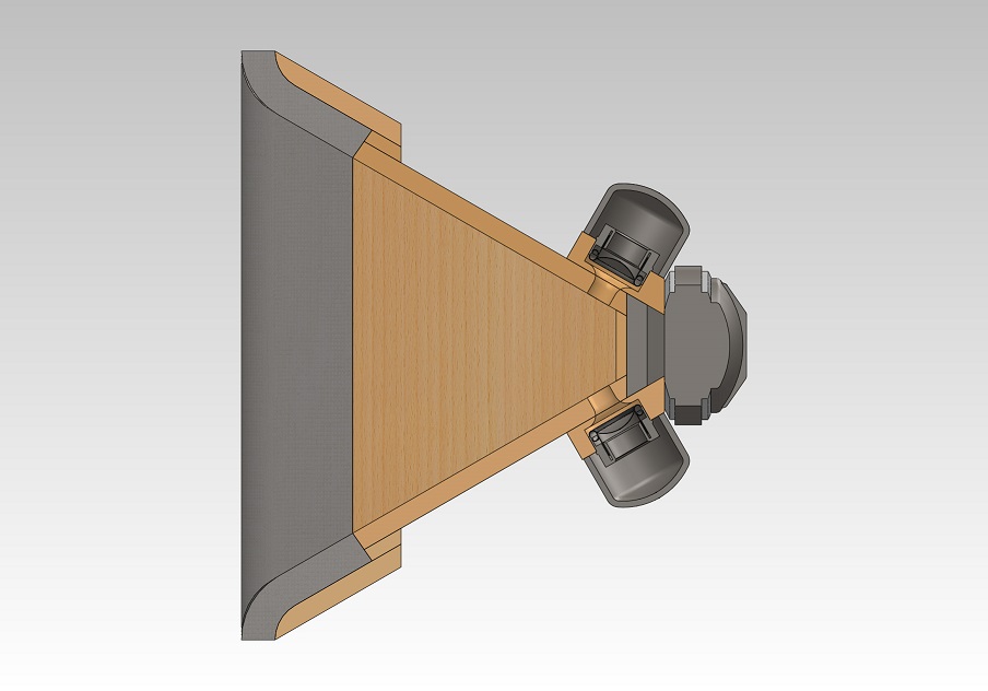

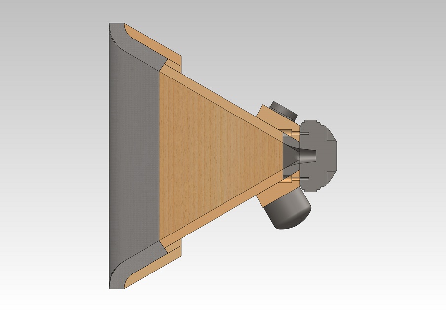

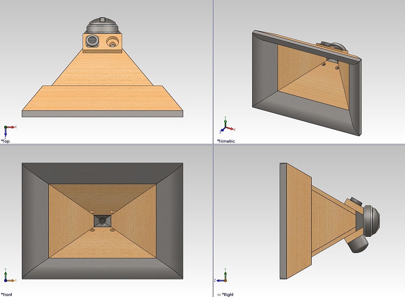

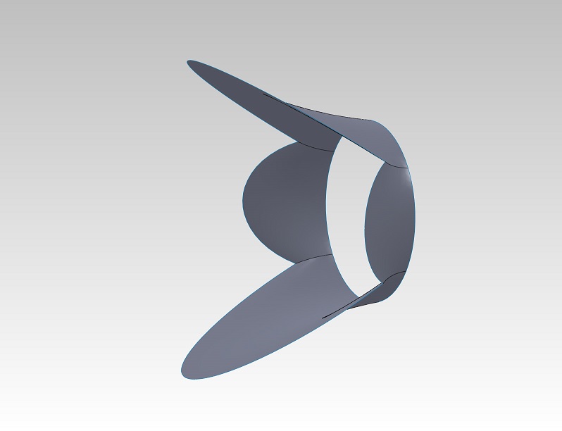

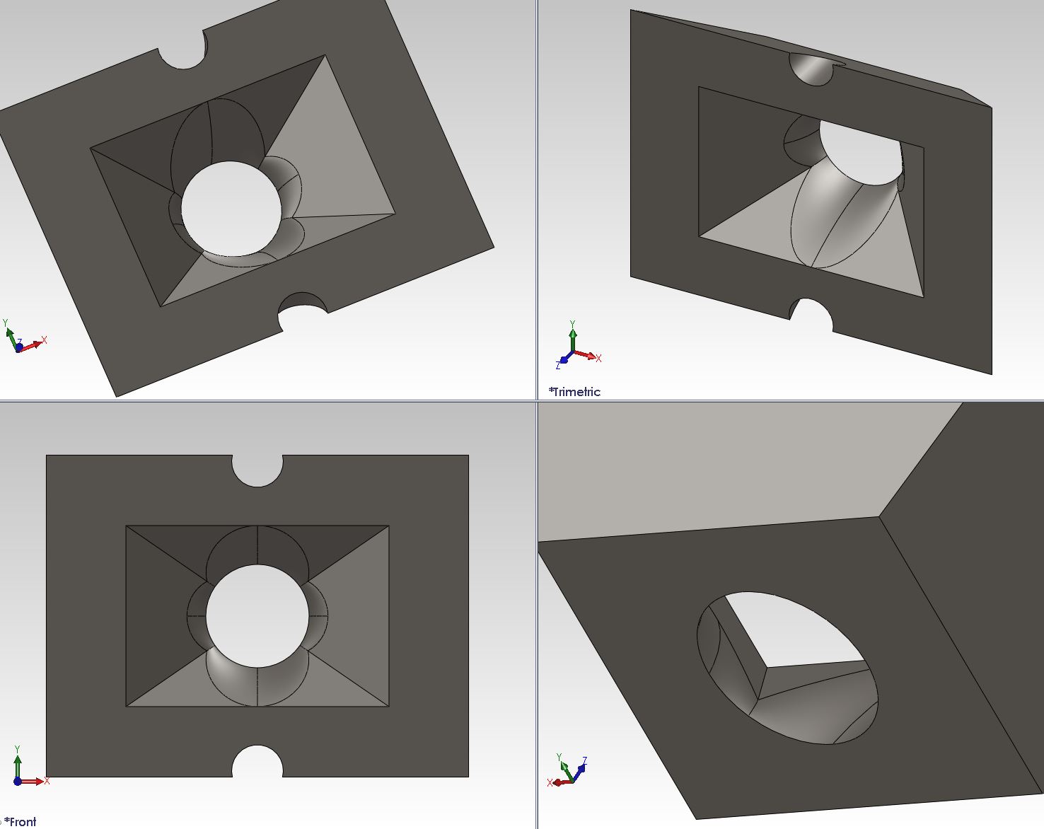

Synergy Horn Midrange Design Part 6 of 6
The quadratic horn throat surface was modeled with a series of tangent radii from the compression driver exit angle to the horn walls. It looks amazingly similar to a camera lens hood that frames a rectangular field of view onto a round lens.
I designed a little throat adapter to be made from ABS plastic with a rapid prototyping machine.
Next I took a look at sound wave propagation from the compression driver. I cut a diagonal section right through the midrange port centers. The ports are located axially 78 mm down the horn from the compression driver phase plug (51 mm from the end of the horn). The sound wave path length to the ports, however, is 92 mm from the phase plug exit (the red wave lines are 5 mm steps). I do not believe that the 1/4 wave throat reflection will pass through the phase plug. The acoustic center is further back at the diaphragm, add about another 20 mm.
Here's a cross section through the center vertically.
Bond the port blocks and throat adapter together with epoxy and attach them to the compression driver with cap screws. Then put the assembly on the horn. The compression driver can be serviced without removing it from the horn. Install the caps over the midranges onto the port blocks with silicone rubber adhesive.
Here's a section through the midrange ports. It does not look it, but those 19mm ports work out to a 4.65 compression ratio with the AuraSound drivers.
I recommend making a test block on a flat baffle board to verify the midrange port tuning. The ports are "streamlined" with a 10mm fillet on the inlet edge. The fillet will shorten the port length by about 5mm. Include the top 5mm of the port opening (2.86 cc) with the front chamber volume.
Here's the 1" thick material I plan to use (as shown around the horn mouth) to absorb sound diffraction: Echo Eliminator
Here's a few more views:
I'm amazed how these tiny AuraSound drivers make for what appears to be a great Synergy horn with two octave midrange bandwidth (300 - 1200 Hz) and high output (120 dB @ 100 W). Thanks for reading and for the previous posts from all of you that helped tremendously. Comments welcome.

Even when testing the same port and just barely tightening screws or slightly squeezing clay around the midranges (temporary rear chamber), makes a tremendous change in frequency response.
As you have found, the drivers must be solidly mounted and no air leaks at all in both back and front chambers.
I could shorten the effective port length to from 15 to 5 mm and triple the front chamber volume to get basically the same response. The Q is then not so sharp so the tuning is not as sensitive. Maybe that would be preferred?
Here is what the port tuning looks like both ways. The lower peak is the short port length. This is a single driver model.
by having the corners more filled in, the mid holes produced a discontinuity
I don't know what effect it may have, but its interesting to see that the way I modeled the quadratic throat, it does not blend or fill in the corners at all yet it makes a smooth transition from flat sides to round. The corners do not vanish until the round end is reached. Here are some other views (tangent edges visible):
Hulkss,
Your "port velocity" simulation is not what you think it is. Horn Response cannot calculate the midrange entry port velocity. What your simulation shows is the velocity of the air in the body of the horn at the point the mid ranges tap into the horn. This is not the same as the velocity inside the entry ports. You need to use Akabak to view the actual port velocity.
